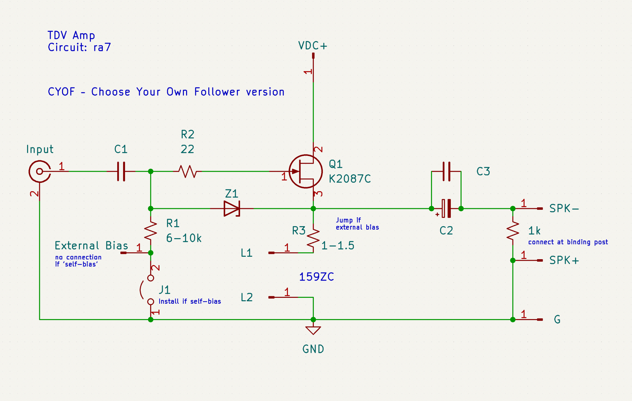

Hi Ra,Add that zener too! That’s important!
What should the Zener diode voltage be if the supply voltage is 28-30vdc?
Thanks!
Alright, I've incorporated Ben's changes. Since the goal was to be a bit more universal, I called this version CYOF (Choose Your Own Follower).
- added over-voltage zener
- added external bias connection in series with R1
- added spot for a jumper when using self-bias
- Simplified R3/R4 connection in schematic and added another power resistor footprint (also makes for convenient point for jumper on external bias, or other arrangements).
- Annotated schematic to outline necessary changes for 'self-bias' or 'external bias'
My question is, can THF51S be used in place of the more elusive K2087C? What would be the ideal Iq and supply voltage? Thanks.
I'm unaware of that combo being tested in this specific configuration, but I'm sure it'll work (see ra7's comments above). If I were going to take a crack at it, I'd probably start with 2R at R3 and work down. I'd probably put a 2-3A fuse between PSU and Vdc-in while I figured out operating points.It should work. Looking at the curves here:
https://www.diyaudio.com/community/threads/tokin-sit-low-voltage-high-current-curves.346518/
It looks in the same range as the 2sk2087C. Might need to play with resistor values to adjust the bias, but it is in the range.
