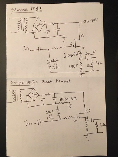

Looking at these two schematics I'd say they show the same circuit, drawn in a different way. Ok, the sequence of the choke and the "1 to 1.5 Ohm" resistor is reversed, but that makes no difference in how the circuit works.Back Biasing!
Below is a drawing of a couple of simple versions of the amp.
#1 is simply a bit of added resistance on the source pin to get the Vgs in the right zone. In the two devices I have, one needs about 1.0R whereas the other needs about 1.25R to get about 1.4 amps. This resistance is in addition to the choke, which has a DCR of about 0.68 ohms. The gate resistor is 10k or if that proves unstable, then go down until it stabilizes.
#2 is called "back biasing" where you obtain a negative voltage from the same supply and winding by inserting a resistance between the negative rectifier terminal and ground. I read about it in Blencow's book. The idea is as old as tubes and was used in old tube receivers to develop the negative bias needed for tubes. (ZM, you mentioned Papa did this at some point too. I have not seen it, can you share more?).
Both these arrangements are kind of self-regulating. More current leads to more negative Vgs, which reduces the current.
With this arrangement the choke is directly connected to the source. Not yet sure if that is better, but I find this very neat. I am listening to it now. No noise, no hum. Bias is very stable. It retains the thundering bass at least. More listening impressions later. Fun stuff!

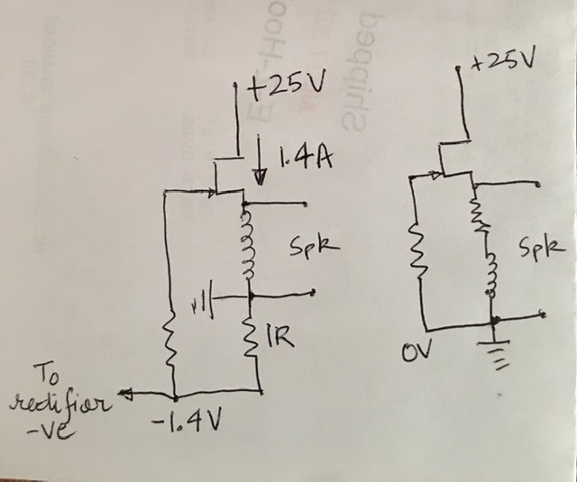

It depends on how you want to look at it. In some ways, it is the same, in others it is not the same. See the two circuits below.
Left circuit: back bias, with -1.4V on the gate and +1V or so on the source for a combined Vgs of, say, -2.4V.
Right circuit: 0V on the gate, with same total Vgs. The device does not care where we put the 0V.
The full 1.4 amps of current will flow through the 1R resistor in both cases and so it should be sized appropriately given the power dissipation. The only real difference is the speaker out, which does not have the resistor in the load. Does it matter sonically? I'm not hearing it. But it is a neat way to generate a negative voltage off the same positive supply.

In your earlier drawing, the speaker was always connected across the choke only, so there really was no difference. Does not matter if you ask me.
