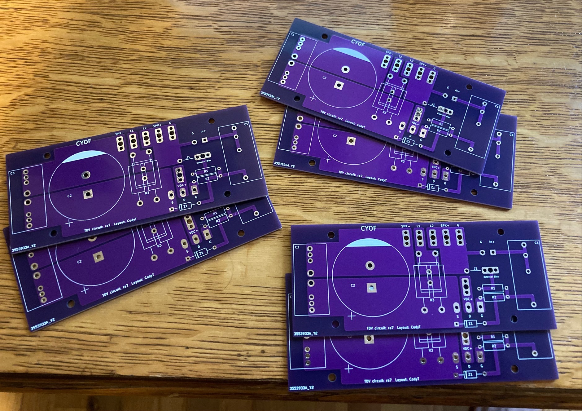

CYOF TDV boards
I made a smol run of the CYOF rev 0 boards at JLCPCB from CodyT's gerbers and ra7's circuit, I have three pair available. I'm into these for $3.58/pair (let's call it $4, ok?), and will ship to US addresses for $10, or hold for pickup at Burning Amp. If you're ex-US you should probably just have them made & shipped to you directly. First come first served.

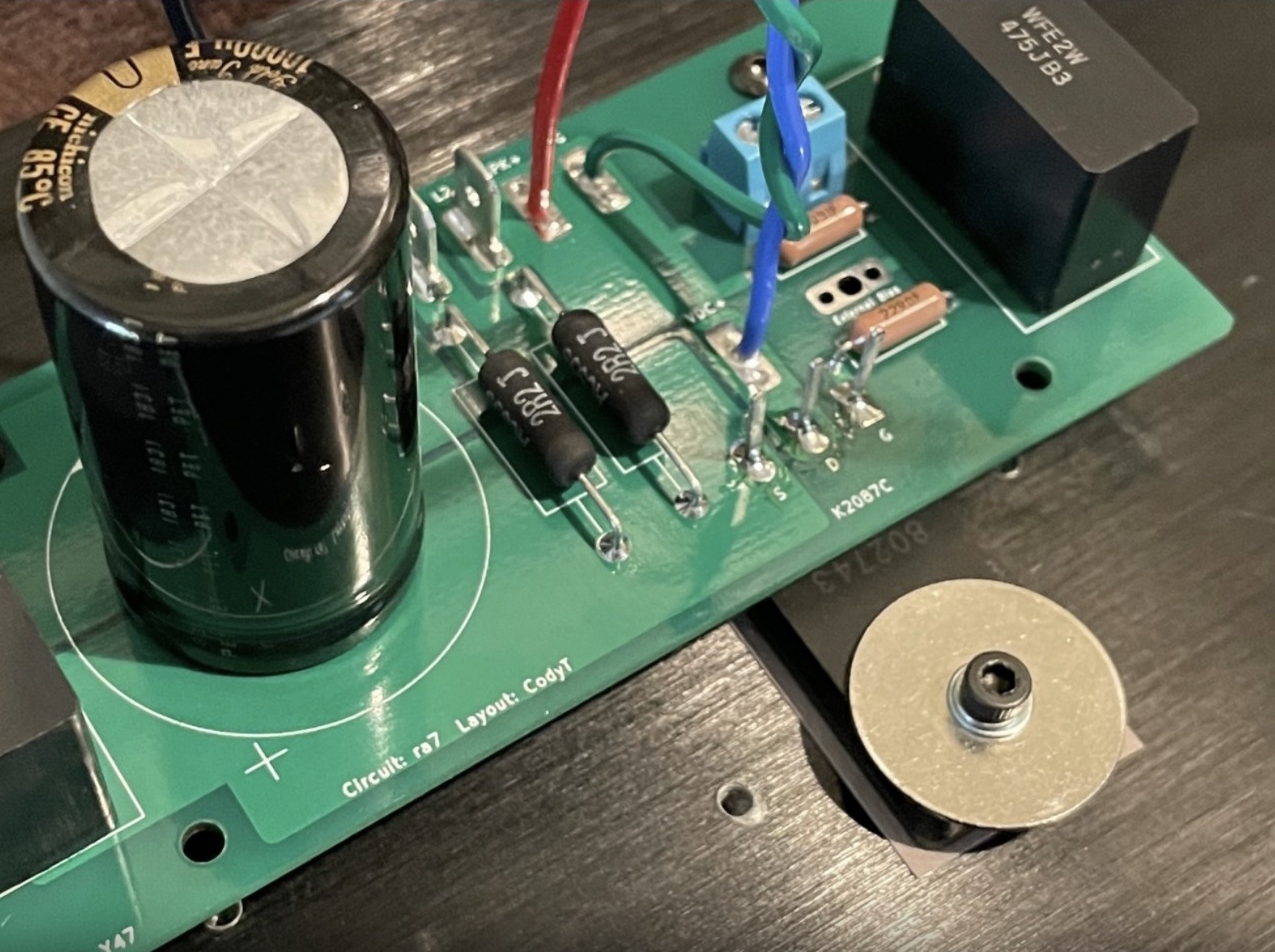

@codyt , did you use Keratherm in your test build? Did you cut your own rectangles? I’ve surmised that the pre-cut sections from the diyAudio store will fit around the metal die of the 2SK2087C, but I want to make sure I won’t jeopardize anything with those before ordering. Crop from your picture attached.
The Keratherm from the Diyaudio store is a perfect fit, I just checked.@codyt , did you use Keratherm in your test build? Did you cut your own rectangles? I’ve surmised that the pre-cut sections from the diyAudio store will fit around the metal die of the 2SK2087C, but I want to make sure I won’t jeopardize anything with those before ordering. Crop from your picture attached.
