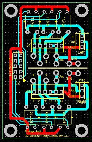

Introducing the LDR3x IOBoard
After going through several design iterations, we're close to finalizing a simple 3 input (2 output) companion switching board for the LDR3x preamp controller board.
Below is a summary. If you have any thoughts, wish lists, must haves, can't stand, can't live withouts etc, now is the time to pipe up with your input.
1) Switches between 3 stereo inputs using control signals from the LDR3x
2) Provides for connecting 2 outputs in parallel
3) Left/right channel grounds are kept separated (should each be tied to power/chassis star ground)
4) 0.1 inch pitch screw terminals for landing inputs/outputs/grounds
5) as alternative to 4), also has solder holes for terminating I/O plus ground
6) 0.1 inch pitch screw terminal for interfacing with the LDR3x board
7) Uses LDRs as signal switches in lieu of electromechanical relays. Roughly 40-60 ohm resistance when on, several megaohms when off.
8] Control/power interface with pin/jumpers to the LDR3x. Note that the LDRs have to be current limited when switched on. This is handled by 6 diode/resistor pairs that need to be installed on the LDR3x board and will be provided with the IOBoard.
9) 1.6 by 2.5 inch board size
I would suggest to make a version for balanced setup in dual mono to not share ground between channels. Also make use of the display to show which input is being used.

Hi Do,
The grounds in the Rev 1 board (original board was Rev 0) will be kept separate for both unbalanced and balanced configurations. Basically left/right channels will have separate grounds so it follows that balanced versions (dual mono boards) will have separate grounds as well.
The current display firmware does show which channel is selected but it only shows this when channels are being changed. Once you confirm your channel selection the display goes back to showing volume step level.
As far as I know there's no evidence of LDR switches vs. electromechanical relays having different sonic characteristics. It's more a question of design philosophy. That fewer mechanical interfaces in the signal path is inherently better than more.
However, many of us make a lot of fuss regarding interconnects, plugs and jacks and the search for optimal materials (gold, platinum, silver, rhodium etc. ), wire configurations, interfaces etc. Relays are just another link in that signal chain. And if you're convinced that one link is important, does it not follow that they all may be?
Our LDR1 and LDR6 Passive Preamps have successfully used LDRs for input switching/isolation so we're extending this approach to our IOBoard.
Morten
