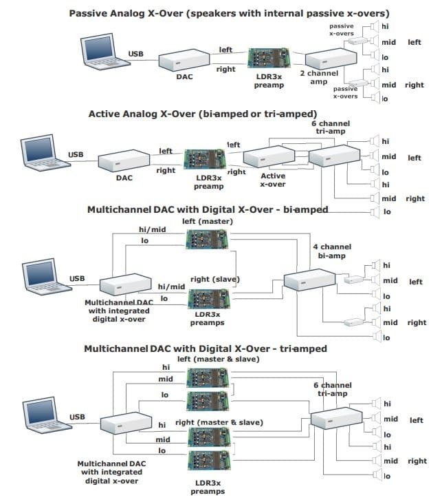

Is it possible to use these after a multichannel dac in a biamping setup with computer based crossovers?
Is it possible to use one after a 2 channel dac, before an outboard active crossover in a 2 or 3 way bi/tri amp set up?
This simple answer is a qualified yes.
It's helpful to use pics to talk about this so I've attached the diagram below.
The first configuration is your basic 2 channel DAC-preamp-amp with passive crossovers in the speakers.
The second shows the same 2 channel DAC-preamp but with an external active crossover feeding a tri-amp but could also be a bi-amp. This was the configuration of my personal rig for quite some time where I used our LDR6 Passive Preamp (same technology as the LDR3x). I've since gone to using full range speakers.
In both the first two configurations a single LDR3x preamp board handles the job just fine.
The third shows a bi-amped 4-channel DAC configuration where the crossover is done digitally upstream or integral with the DAC. Here we use an LDR3x in a master/slave configuration where the master handles the 2 left channels and the slave handles the 2 right channels. Please note that these are all unbalanced signals.
Where it gets even more interesting is in the last configuration which is a tri-amped 6 channel DAC again with the crossover done in the digital domain. Here we need 6 channels so a single LDR3x master/slave isn't enough. We could go with 2 pairs of LDR3x master/slave boards. How does this work with 2 masters? Actually this works quite well. We sold a pair of our LDR6 Passive Preamps to one customer who wanted mono-preamps. Using a single remote, the volume of both mono-preamps followed in lock-step even though they weren't actively slaved to each other. In the event they ever got out of synch (not at the same volume level) it's a simple matter of driving volume to zero via the remote to re-sync them.
I'm sure there are other possible variations on these scenarios but in most cases I can think of the LDR3x should be able to work quite well.
Morten
Thank you for your detailed reply.
I should have mentioned that I am interested in balanced inputs and outputs. How would this change things?
Thanks again.
Handling balanced I/O basically means that for each nominal signal you actually have two signals, a so called + and a - which are 180 degrees out of phase with other.
In terms of the diagram in the previous post, you would basically need twice the number of LDR3x boards since you'd have twice the signals. This gets back to the dual board LDR3x Master/Slave scenario which was designed for handling balanced inputs/outputs where the Master handles say the left channel +/- pair and the Slave board handles the right channel +/- pair. But with multiple channels the hardware count adds up.
And while it gets messier with multiple boards, we can easily match the attenuation curves off all the boards needed using our established LDR testing and curve correction protocols.
Alternatively, you could use transformers to briefly convert the signals to unbalanced at the input to the preamp and back to balanced at the output of the preamp. This would save you all the extra boards and prove to be a less costly approach. Edcor makes some nice transformers for this that run about $25 for a pair. You'd need 3 pairs for the tri-amped case in lieu of the extra LDR3x boards. I'm generally not in favor of all extra signal manipulation with transformers but they are quite quiet and introduce minimal signal loss.

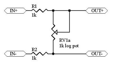

I would like to pose a question, hope it is not a problem. Did you ever try to make a balanced LDR control with the LDR in place of the pot, as shown in the attached schematic? This would save 3 LDR's per channel.
What is the minimum resistance you have been able to achieve with these LDRs?
Many thanks! Erik
Many thanks! Erik
Hi Erik,
No problem. Our current balanced LDR design approach looks something similar in that R1 and R2 are both LDRs (the series) and the RV1a is actually 2 LDRs (call them R3 and R4 - the shunts). Through testing and software we're able to shape the resistance curve of all 4 of these LDRs to achieve very decent channel to channel balance. Thus for unbalanced audio we use a total of 4 LDRs, 2 per channel and twice that for balanced.
Morten
Hi Morten,
thanks for your reply. That is indeed how I expected you would do it. I was just thinking that using fixed resistors for R1 and R2, and indeed just one LDR instead of two in series, could work as well - soundwise maybe worse, maybe better, don't know - but probably cheaper and easier (less LDR's, less matching issues). Downside is that impedances would vary more with this setup.
I was more curious if you have compared both ways of doing balanced volume control?
many thanks, Erik
Hi Morten,
many thanks, Erik
For reasons I can't explain (because I don't know!) but that probably have to do with material properties, audio just sounds better having traveled through LD-resistors compared to conventional resistors. It would compromise sound quality to go back to using conventional resistors. Or else why not just use a stepped attenuator with say Vishay resistors...or a pot. The whole point of LDR based attenuation isn't merely to use less of them but to use only LDRs and just enough of them to get the job done. 😀
Hi Morten,
I thought that the point was to avoid mechanical contact, but indeed the presence of more LD resistors may be the main factor influencing the sound. Well, from my side it was mostly curiosity, so maybe I will have to try it out myself. Many thanks for your replies, and succes with your business!
Erik
