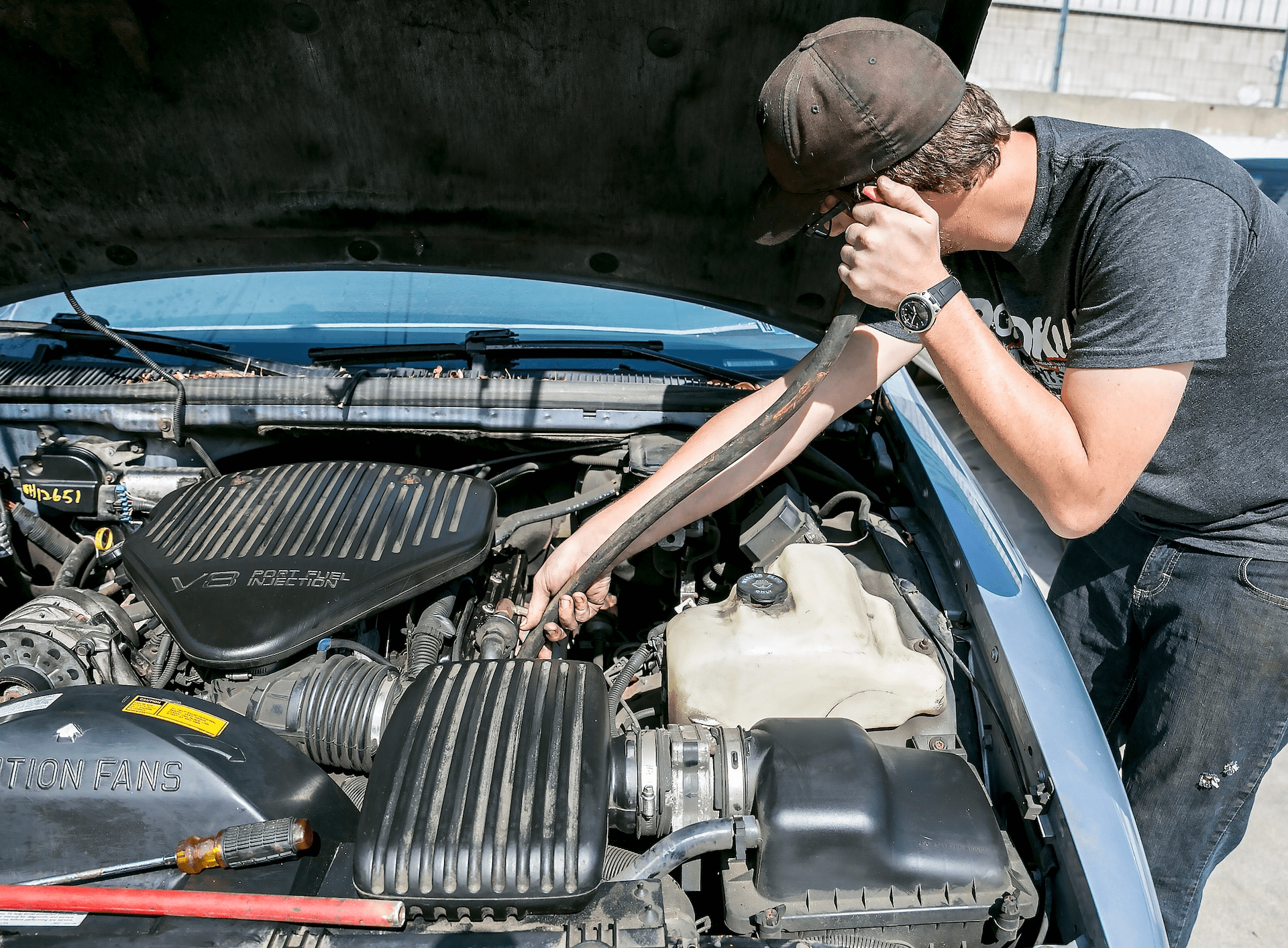

Don't need a stethoscope... A screw driver is good enough for that. 🙂
In the auto shop we do this:
