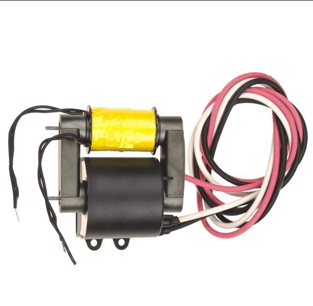

Well it has a split bobbin ...

What is this type called? Is this also a type of split bobbin?
No, this is what´s called split bobbin in EI transformers, which is wound on:
sold as:
Transformers Split Bobbin
and brags of:
Dual bobbin construction with insulating shrouds -- provides 4000V hipot and results in low interwinding capacitance eliminating the need for electro-static shielding
- Designed to meet UL, VDE, IEC-65, CSA.
- Dual bobbin construction with insulating shrouds -- provides 4000V hipot and results in low interwinding capacitance eliminating the need for electro-static shielding
