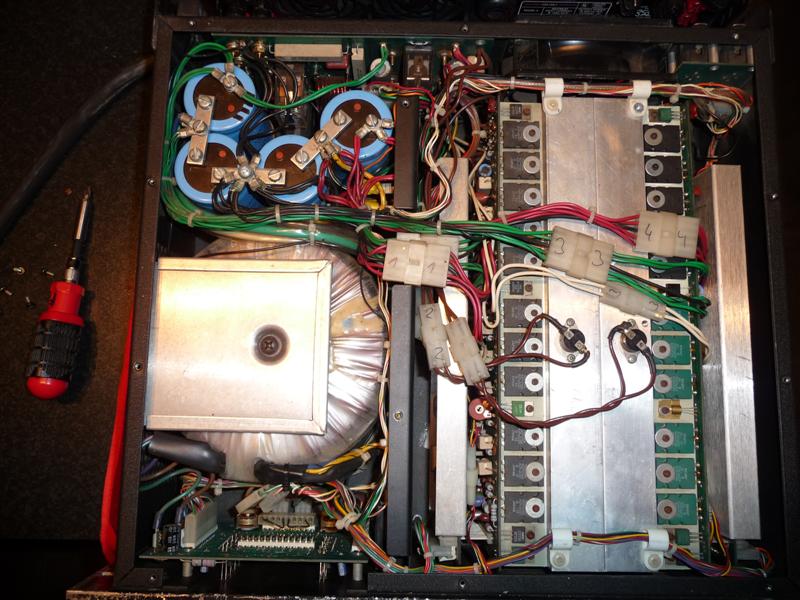

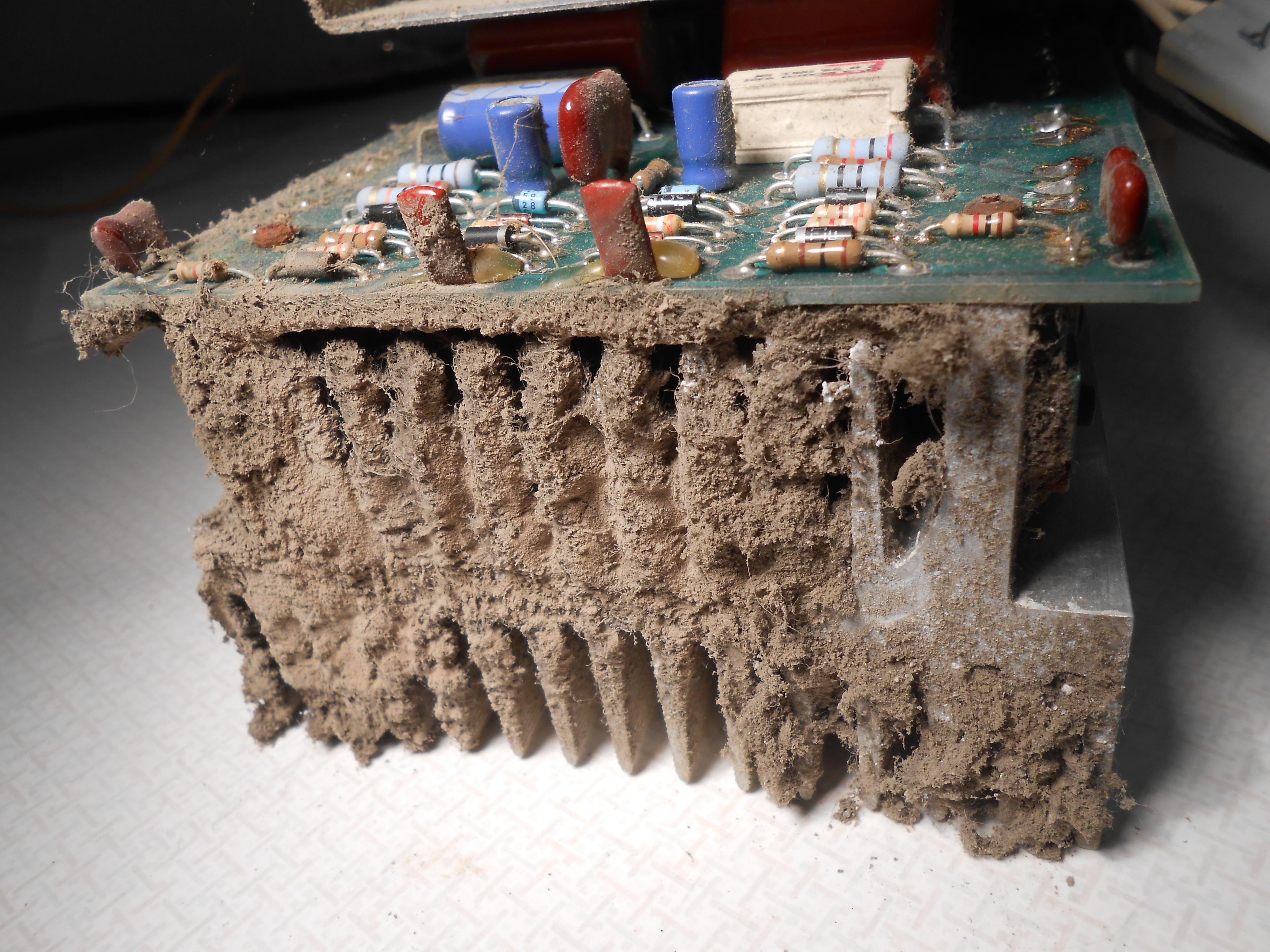

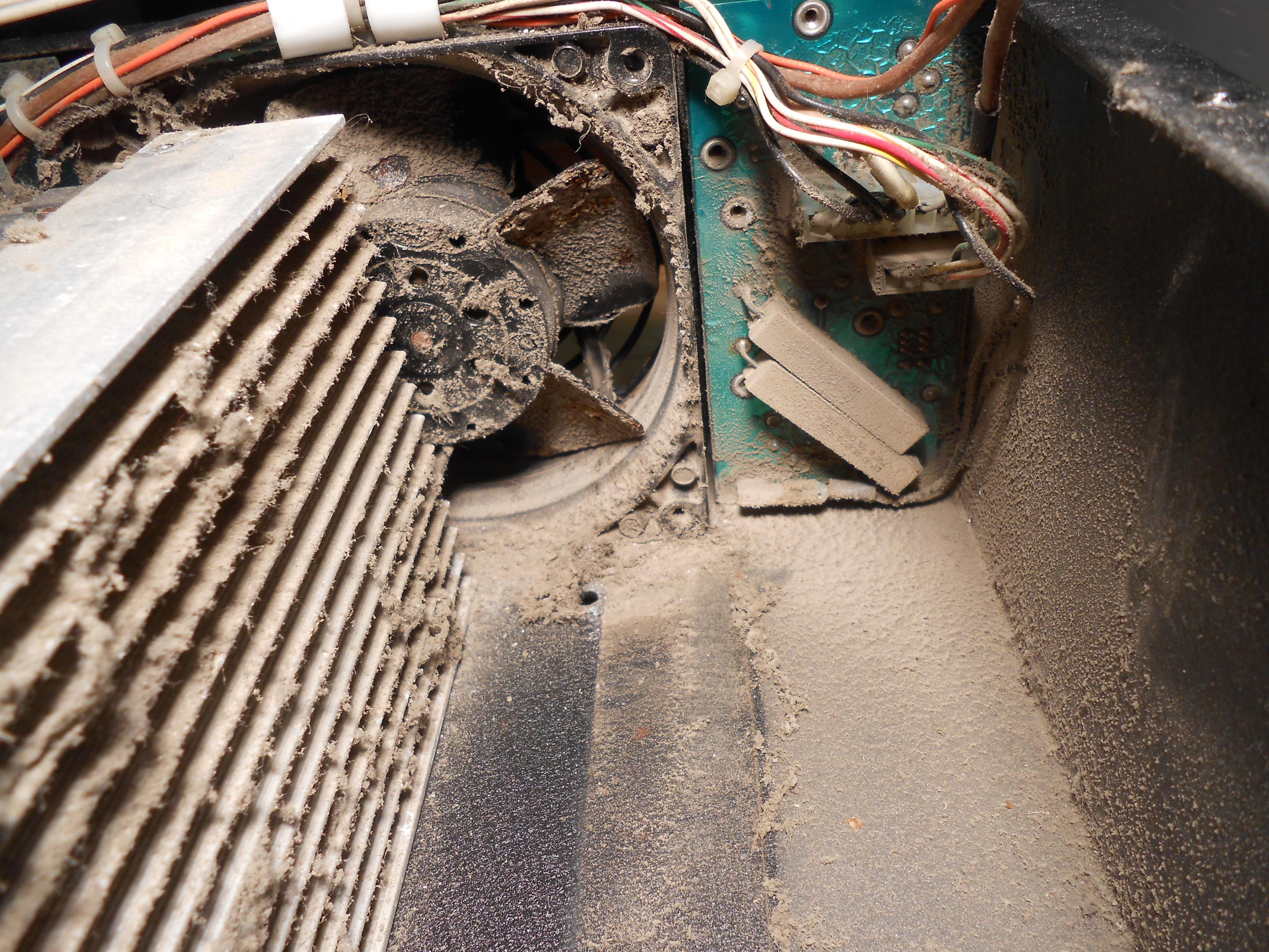

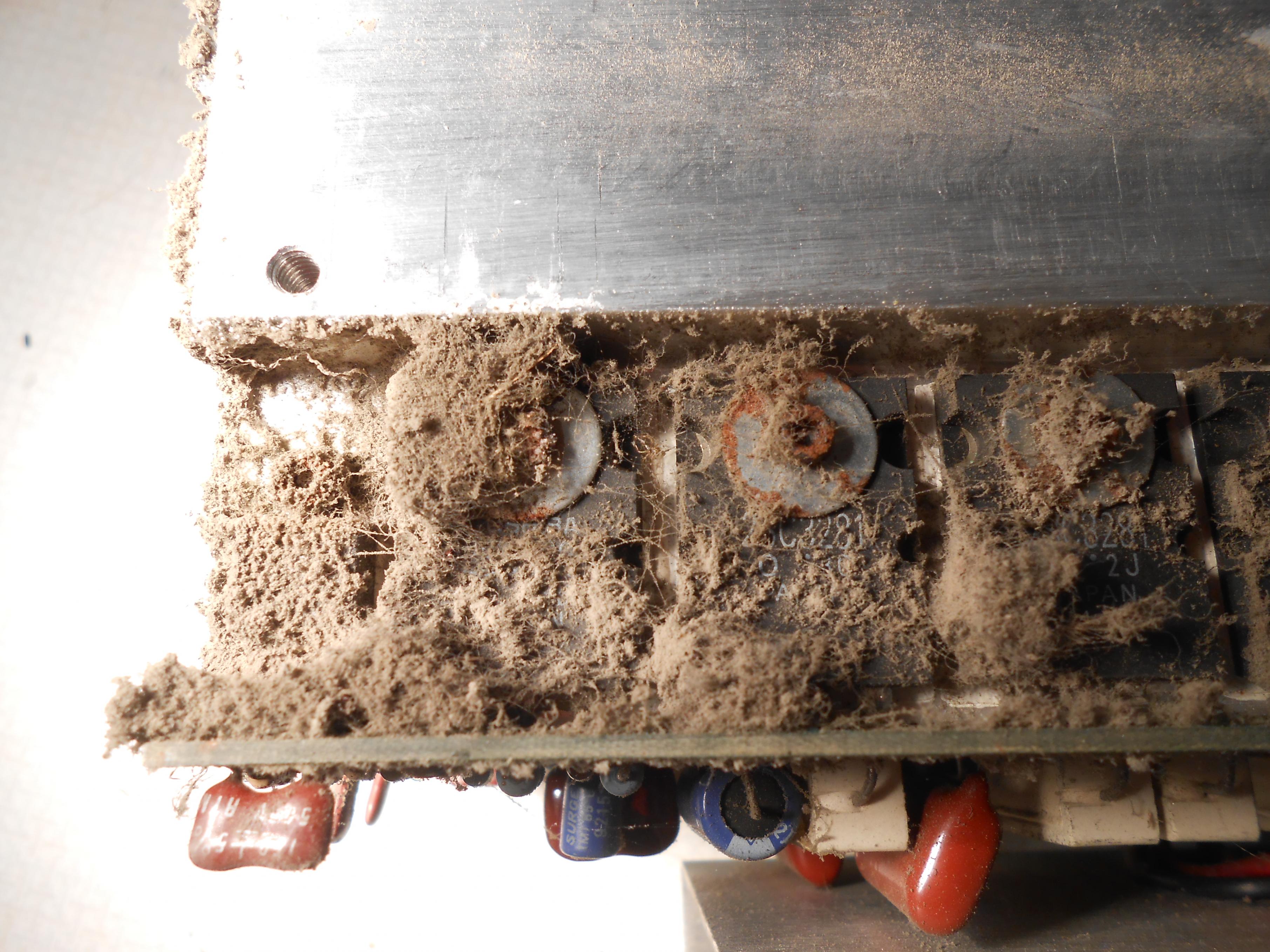

Thanks jwilhelm and all who advised me to disassemble the Crest 8001 befor further testing. As mentioned, the screws for one output module are 'finished', but so far, the dirt is to thick to see where the repairs have been made.
I have attached photos, just for giggles.
I will look for a book that is more Class G and H specific. I think Douglas Self's book will be a huge benefit for the moment.
As mentioned, the previous owner said it was 'stuck in protect' after the dog chewed through a speaker wire. I (foolishly) connected small speakers and a signal generator after bring it home. It worked! The Volume pots where not even noisy!

Hi guys;

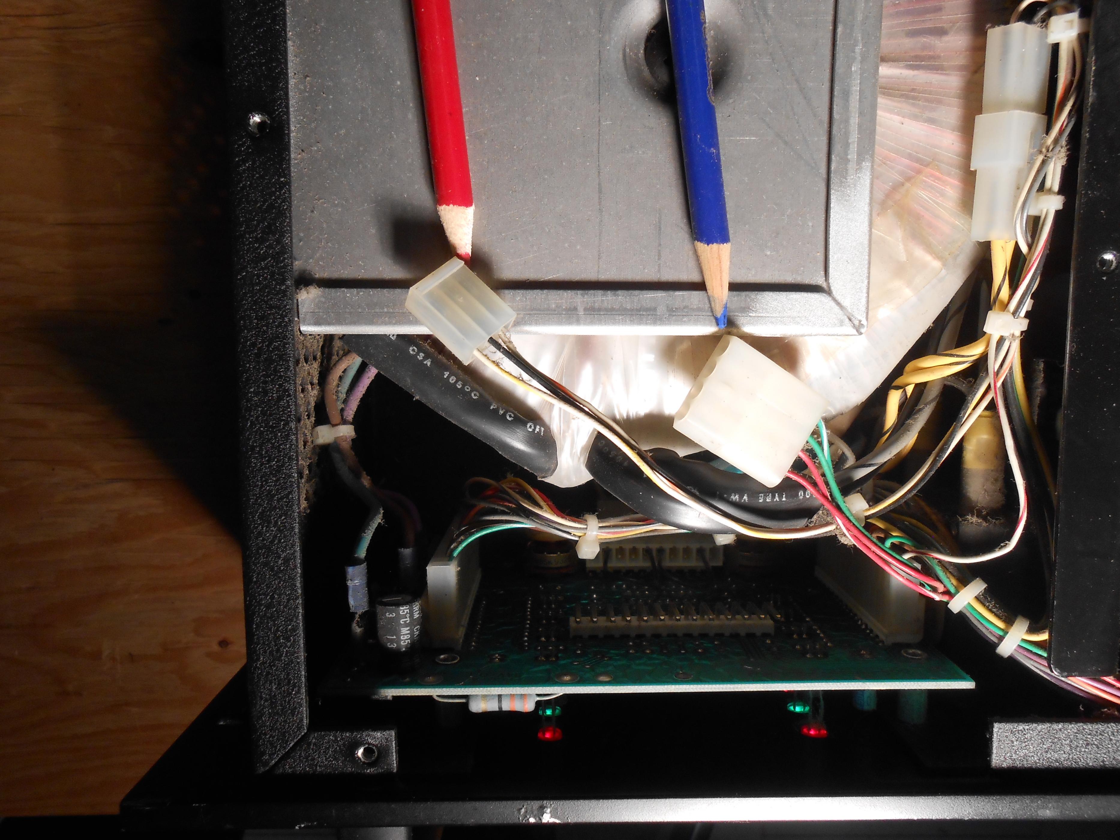

I will have to study the schematic, but can anyone tell me why there are two unconnected plugs inside this amp? (Both channels worked, anyway!) Connectors are indicated by the pencils.
Interesting, as Crest use the red color for +rail, and green for the -rail. Disconnected this connector means missing power from one card...
Sajti
Hi Sajti;
But....Both channels worked on this amp with those connectors not connected. Could there be an option that this amp did not have?
Hi Sajti;
absolutely no.
There are 2 ideas come to my mind:
1, Look around in the amp, and try to find empty socket, within the range of the loosing connectors. And check on the schematic if You find.
2, Search for pictures about the 8001. This is very popular amplifier, and there are many of them still in use. Maybe You can find picture, where this connectors are connected to somewhere.

Hi Sajti;
Thanks so much for your help, I googled images for the 8001, and found a picture with those 2 connectors open ended!
I will examine the schematic to see if they are 'test points" or what?
Attached is another 8001 from the web. Thanks everyone for your input. I know I have wondered of the initial point of this thread; the noisy toroid in a Crest CA-18.
