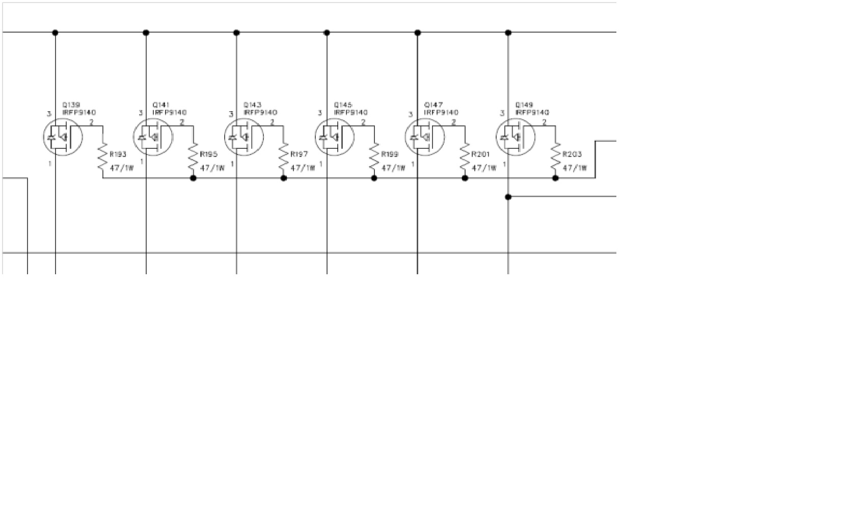

I have attached a section of the CA-18 output schematic. Are those HEXFETS? Are they similar to triacs, (either on or off)?
Also, am I correct in assuming that the volume pots vary a control voltage or do they carry the audio signal?
yes MOSFETs. but "HEX" is IRF marketing name for it . most times they work best on or off ( ones and zeros) , but for this I think they are used in linear mode.
most volume pots adjust the signal towards the amps input. Its hard to say anything concrete without a schematic.
It's a special trick by Crest. Something like "semilinear". In the linear mode, the upper semiconductors, has unity gain (emitter followers), and they are driven from the output voltage, if it reach the treshold level. But in CA18 there is a gain of 1.66 for the MOSFET stage, which means, that it's saturate earlier, than the linear solution, and it reduce the voltage across this section. This gives better efficiency, and the they can mounted to the heatsink without insulator, together with the output devices.

I now have the data sheet and your info. They are power mosfets in the second tier of the CA-18. I am guessing that faster switching speed (cooler operation) was one of Crest's motives for using this device. Thanks, infinia, Andrew, sajti. So far, the output sections of the CA-18 and the 8001 seem to be holding together. Fingers crossed, with all those devices, failures in this area must be catastrophic!
My concern is still in the front end of the CA-18, in light of the previous problem; channel B clip light stayed on and output muted. I have re-attached the schematic. I think I need to print this schematic in poster size and trace the signal path with high-lighters! Circuit paths seem to disappear through 'wormhole' paths. I need to become familiar with the tabs and symbols.
** My primary question (at the moment) is; what voltage is controlled by the volume pots? A DC voltage or the actual audio signal?
Crest claims that all the protection circuits do not affect the signal in normal operation. I would like to acquire enough knowledge to verify this. I would never attempt this, (at this point) but I have these 'purist' thoughts of eliminating all these limiter circuits and connect an audio signal as directly as possible to the amplifier to avoid any possible compression and improve S/N ratio. I would never attempt this, I would need stacks of amps and voice coils to burn!
