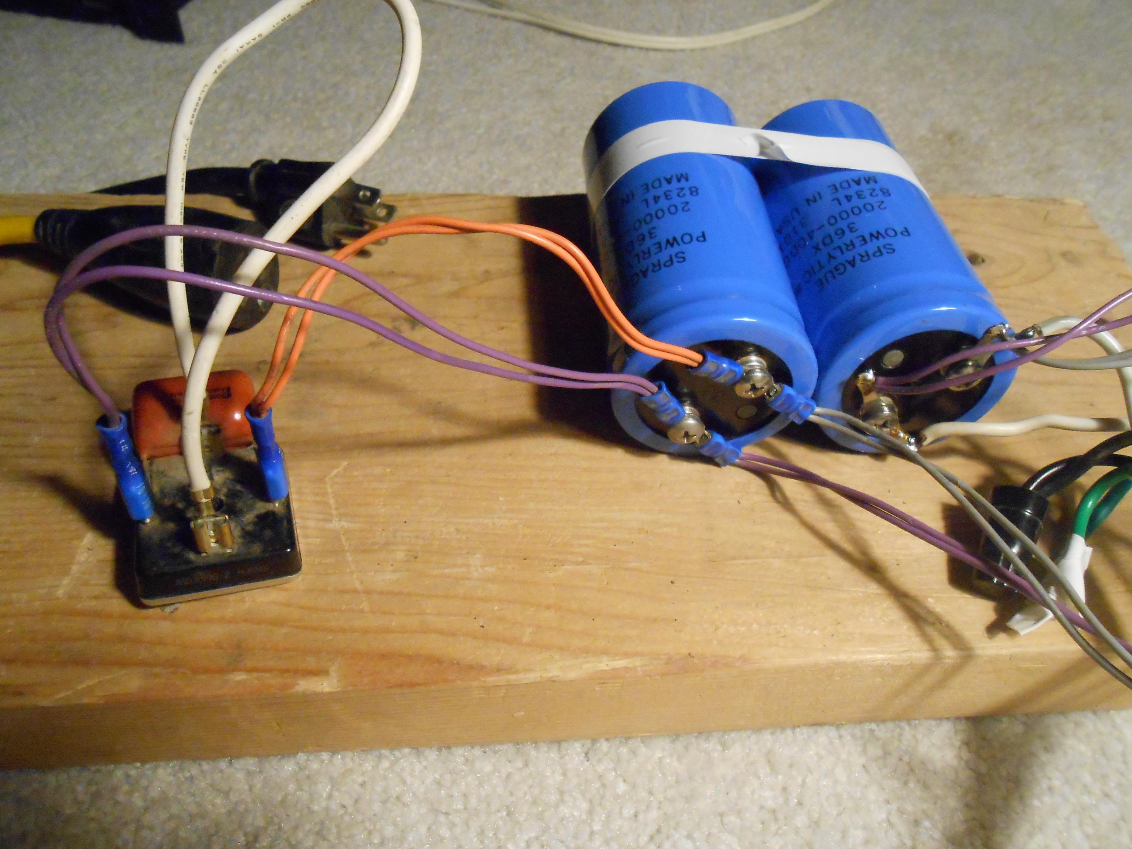

In my case, the noise was not reduced. The board under my rat's nest experiment, was to avoid melting a hole in the carpet, if things went 'fins up'.
Please keep us posted regarding your toroid noise battle. This thread has attracted a great amount of valuable information, I have learned so much about transformers in general, thanks to the members here. I am not an engineer, but I have a 'masters' in relentless trial and error. My Crest CA-18 would growl randomly, and particularly when a Microwave oven was used on another branch cct. I constructed a temporary DC blocker, with caps in series and parallel (separate experiments).
My newly developed theory is; what if there is noise on the line, harmonics of the line frequency. This noise would not be affected by a DC blocker, I assume. By careful stethoscope examination, it appeared to me that noise source was the actual copper windings. When I finally took 'the plunge' and decided to peel the outer wrapping, I found that the coils where simply wound on the core and held in place by tension, such as it was. My Yamaha P2200 has an (epoxy) encased toroid. My Phase Linear 700's have (varnish) dipped windings. These amps are quite. I have learned here about core saturation, but sensing that the sound was coming from the winding, I had a hope that dipping this transformer would help. The inner core lamination was inaccessible for stethoscope probing.

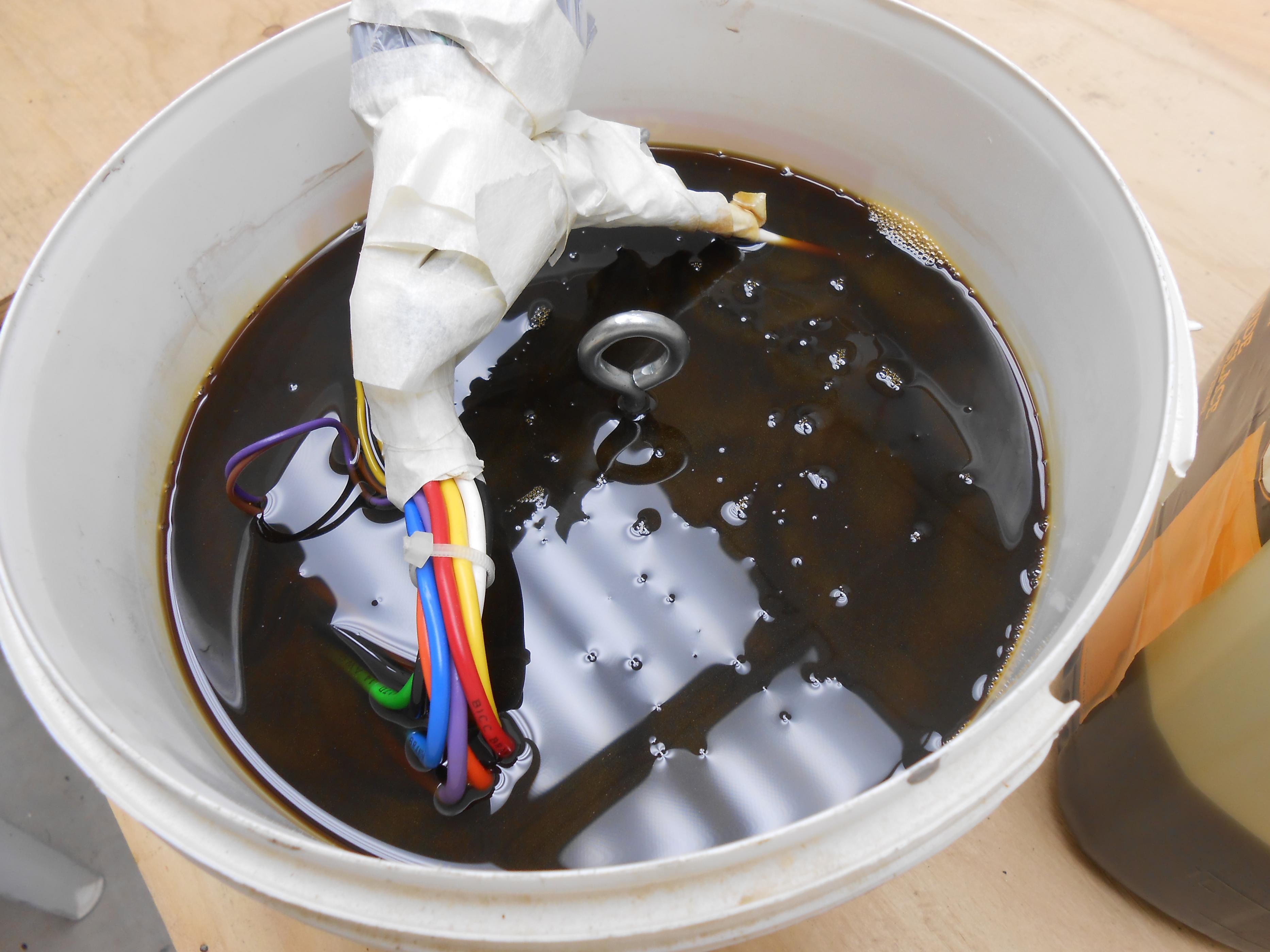

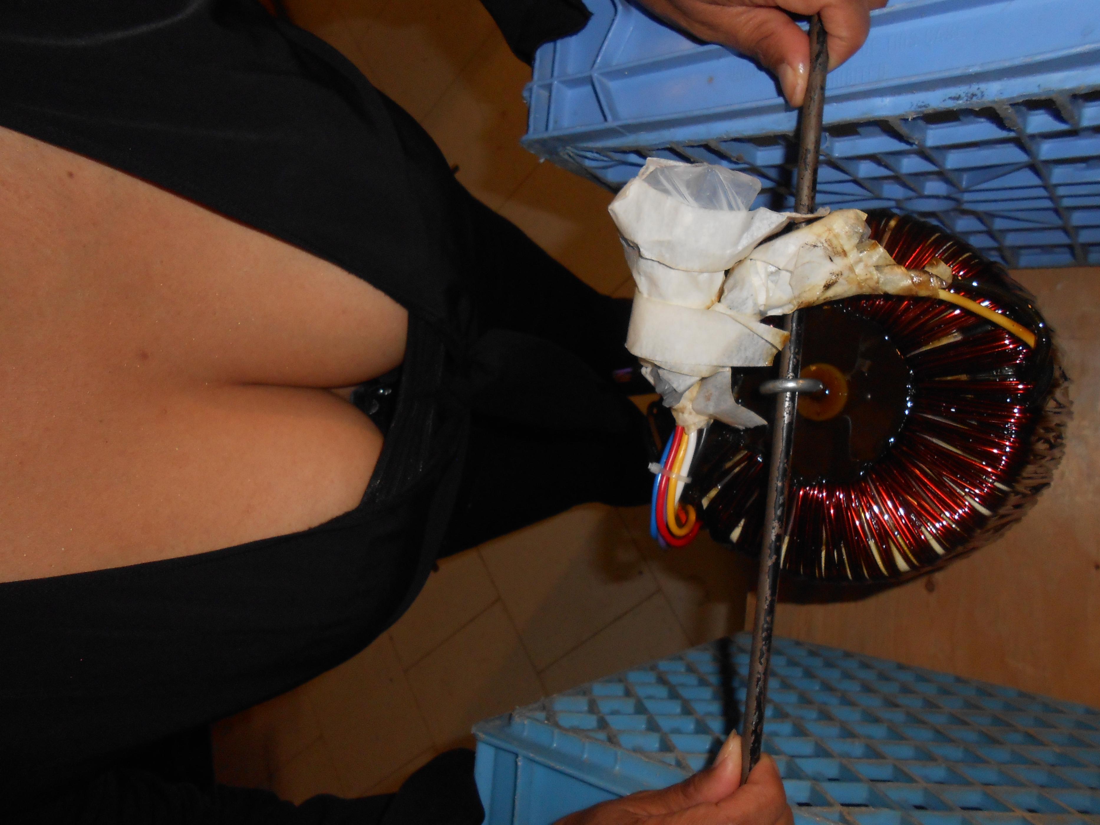

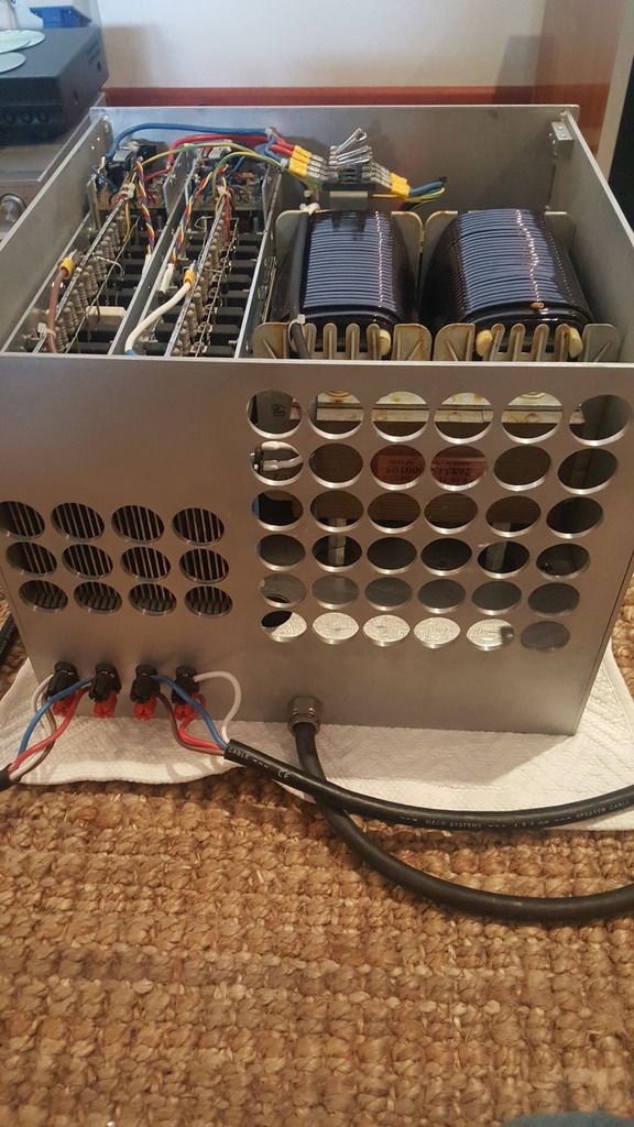

At the risk of redundancy, I will attach some photos of my 'dipping' process. It took 20 dips in Electrical grade varnish before I had the nerve to power it up and hear my results. I can honestly tell you that the transformer noise issue has been COMPLETELY resolved.

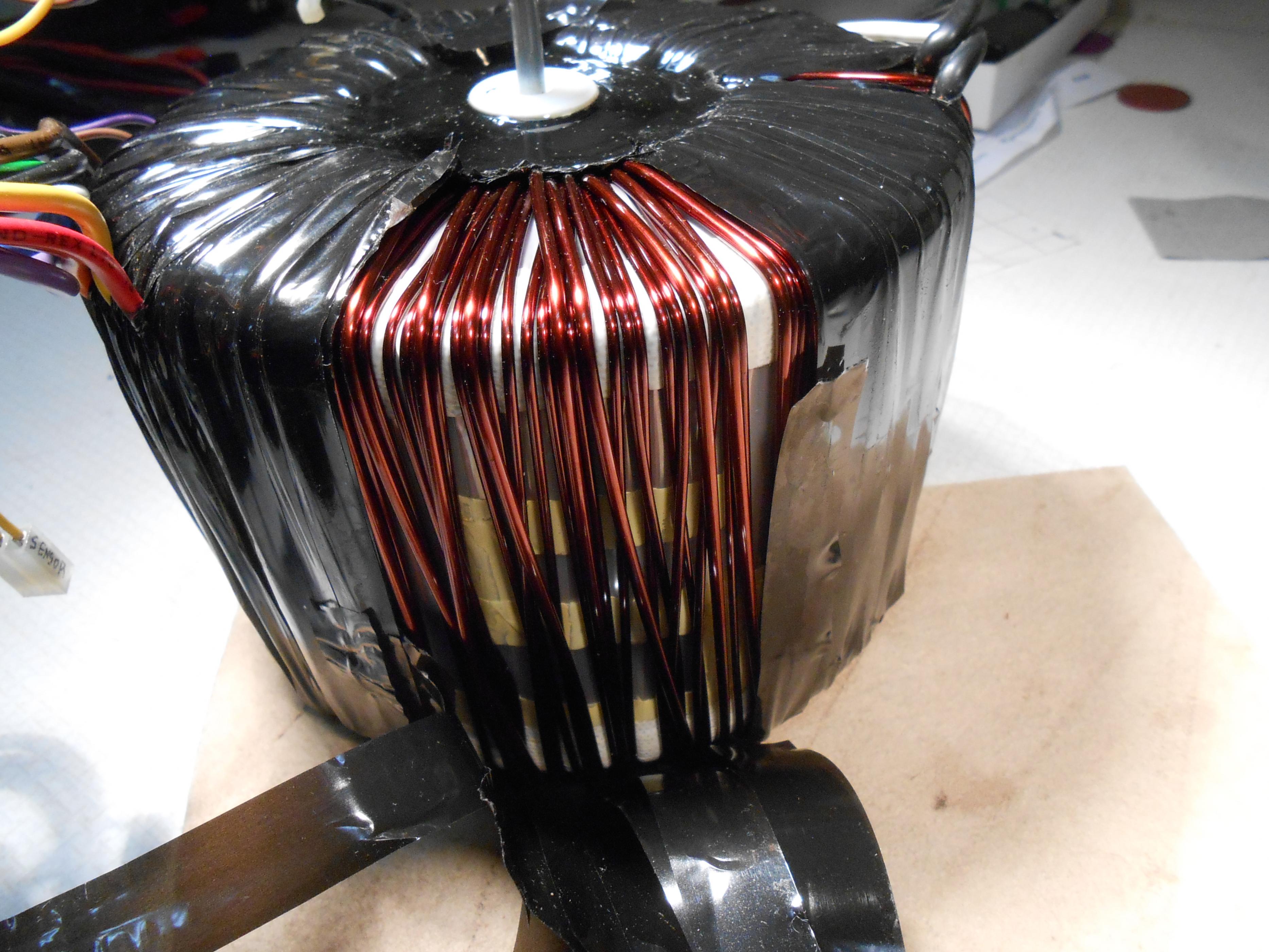

Here is my Baby with the cover off (photo below). The fan was easily removed, I did even have to lug the 80 lb monster out of the rack!

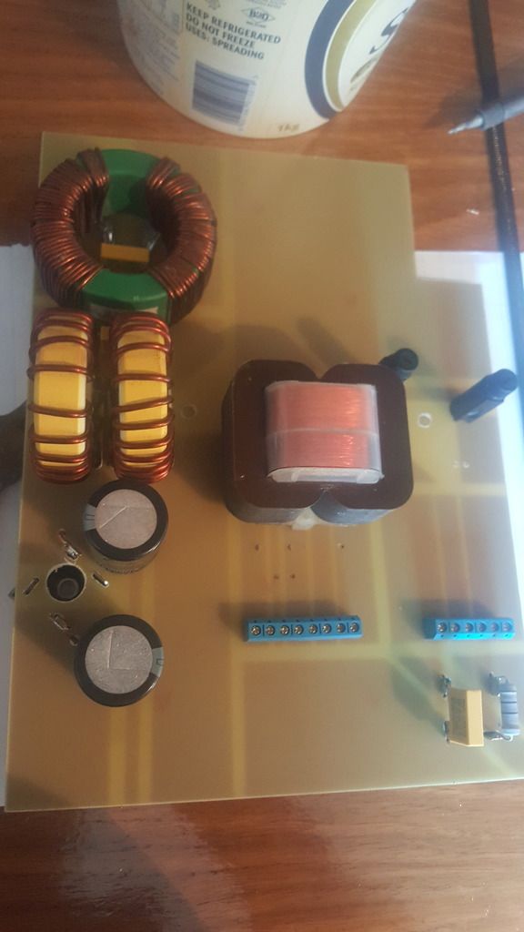

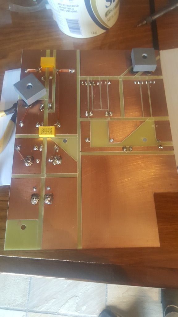

The blocker is part of a massive EMI filter and quite a few other thing all on on PCB so that is why it is taking so long. I will take a pic just for fun

OK the blocker, and yes that one cap is in wrong but already fixed
I am still busy with this board
