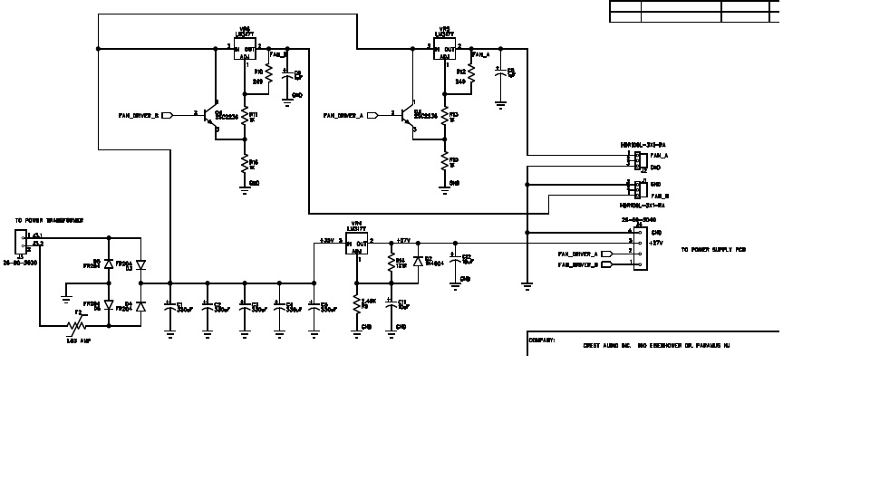

Hi Jwilhelm; If I were to use an additional pwm controller (thank you for your offer, I know you are not that far from me, I have an independent 24 V supply. It is an addition component, but I prefer it to modifying the amp further to extract the power source.
Sajti has raised my hopes regarding modifying the analogue fan control pcb to keep the fans off until 50 degrees C is reached. This would be my ideal solution. (perhaps I could adjust that threshold (maybe 40 or 45?)----now I'm getting fussy!
In any case, Sajti, would you have more info on this fan control that you suggest?

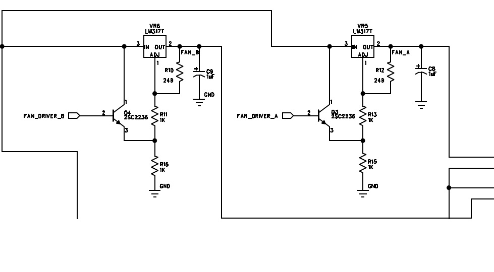

The fan control PCB uses three LM317T (voltage regulators). I have the schematic set for the Crest amplifier but it is too large to post here. I am at hennioriginals@gmail.com if anyone is interested in a copy.

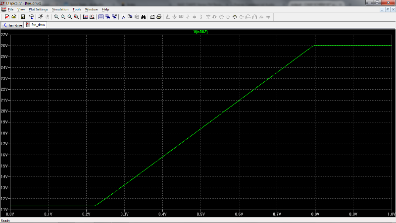

I put the fan circuit into the simulator. The result is, that the fan running about half speed continously up to 22-23C, than speeding up, and reach the maximum speed at 80C.

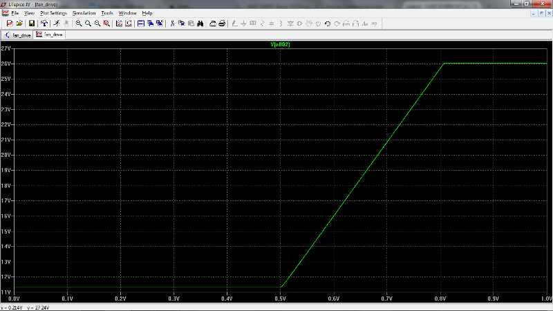

My modification keep the half speed running up to 50C, and reach the maximum at 80C. You need to add one more resistor, and replacing another one.

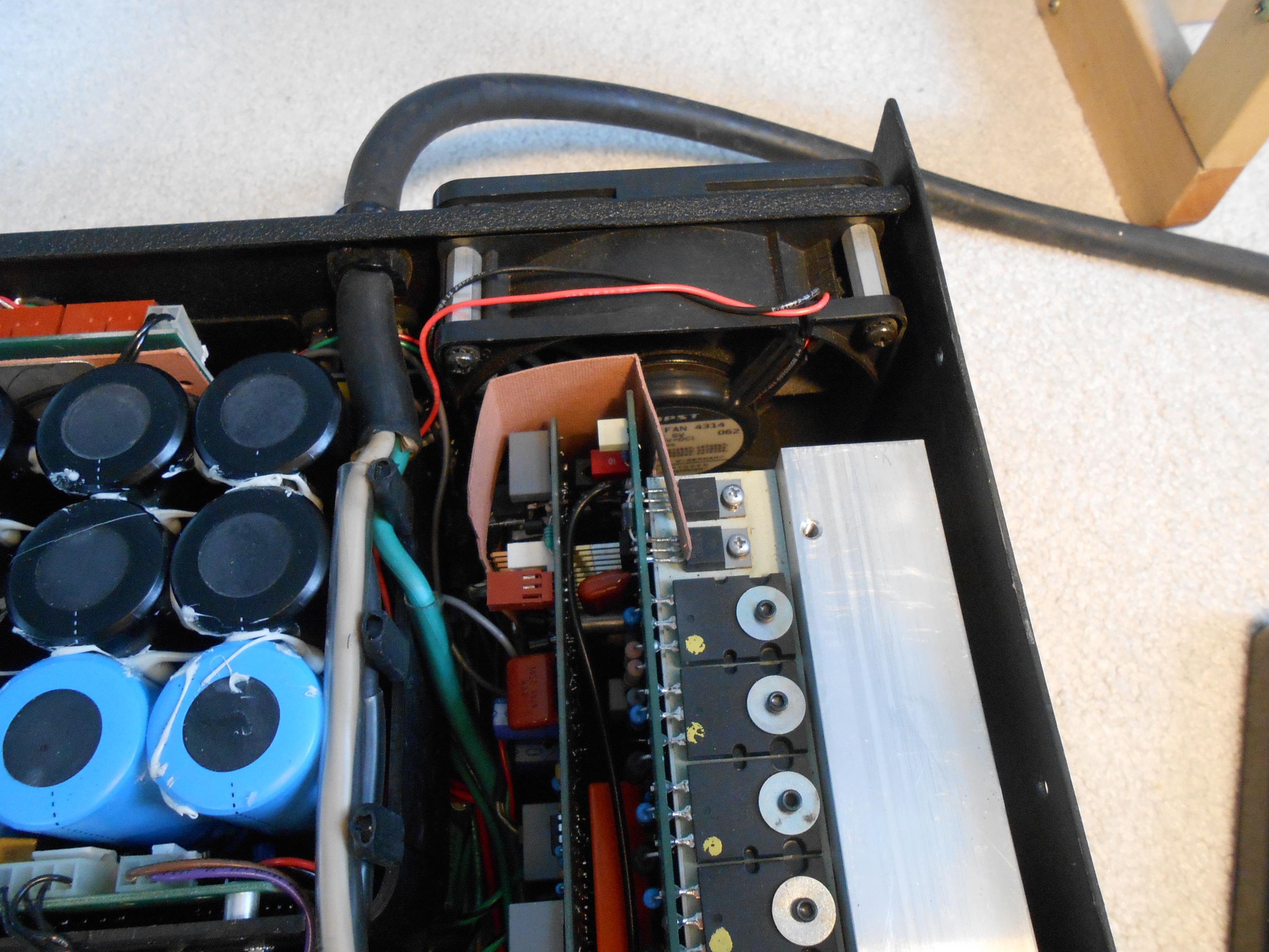

I'm beginning to think that replacing the fans would be the slickest solution. Thanks for that substitution suggestion. It seems to be ideal, a 10 db reduction would make things acceptable, and there would be minimal changes to the amp required. My lazy streak is showing but I hope I can swap fans without having to remove the output modules (and the infamous toroid).
I have a Crest 8001, that I completely disassembled for cleaning, and found that the fan was one of the last components that could be removed...
The above photo is the CA-18, looks like a tight squeeze , but hoping the fans will get past the heat sinks. First I have to pull the 80 lb monster out of the rack!

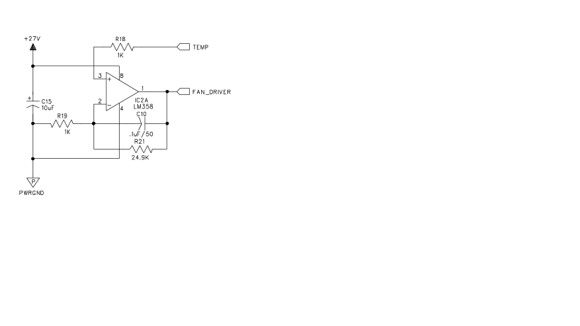

Hi sajti, I have tried to copy the fan control schematic from the complete pdf. Would you have a suggestion as to how this circuit could be modified to reduce the fan speeds?
The fan control PCB is also visible in the above photo, it is vertically mounted in front of the light blue power supply caps. Looks like a project, just to get access!

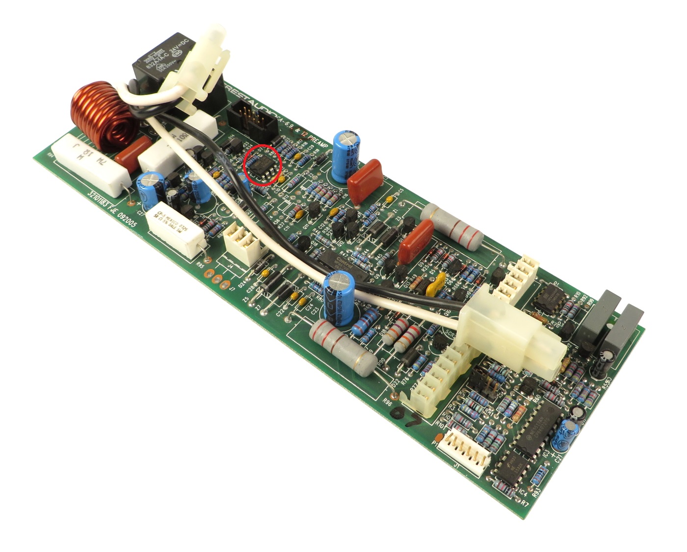

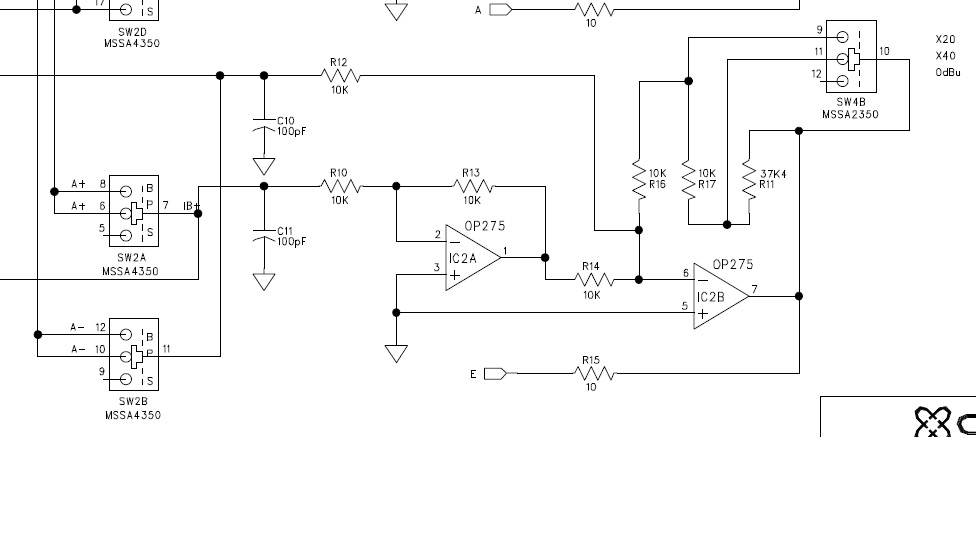

Hi sajti; This is the the IC 2A on my pre-amp pcb. It appears to be a signal amp rather fan control or am I looking in the wrong place?
You are on wrong page
Try to find the picture part I attached. It's on page 5 in the CA18 schematic, downloaded from crest audio homepage.
Sajti
What You mean, is the input pcb.
Sajti
Thanks sajti;
I see it now. I have to confess that I am a little nervous about modifying this pcb. I am a little afraid of this amp, given the high power levels. Is there a manual or drawing that would show the component layout on the pcb?
Thank you for that picture, I see that Crest was kind enough to print the component numbers on the non foil side of the pcb. I did not notice this, the last time The cover was off! Did you take the above photo?

Hi Peter,
the picture comes from the net. I used CA18, repaired it, but never owned. I understand Your point, that don't want to change the pcb. Replacing the fan has low risk. Thermal protection will shut down the amp, if the new fan is not strong enough.
