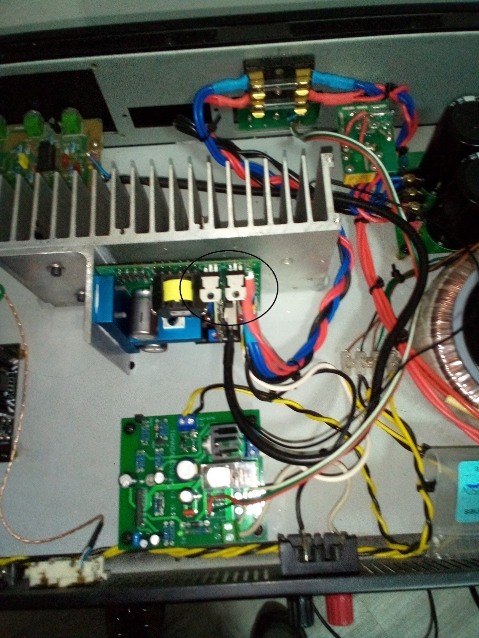

NC400's are the upgrade to the uCD400. I hope for 3-500$ there are no hot transistors.
The NC's made the old uCD prices go down - just 125$ to run my sub - have a Hypex uCD400.
The UCD's have some hot transistors (below).

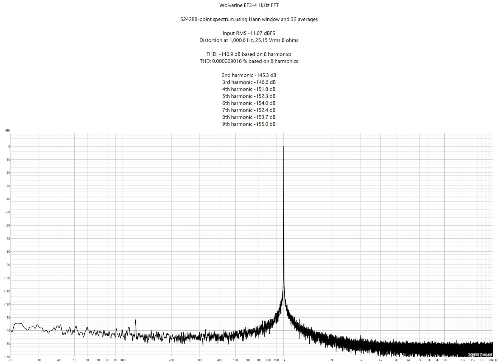

My cheap Wolverine has the NC500 beat by one PPM !
On the graph it would be between the NC500 and real close to the Topping.
20K the wolverine beats the NC500 by a little , even.
Topping is a good deal for a DAC ! I'm buying the topping E30 II DAC for $120. BT E70 would be
the only DAC lower than my Wolverine. Imagine that for a DIY (forum) amp.
Unfortunately , it can't match class D in "coolness".

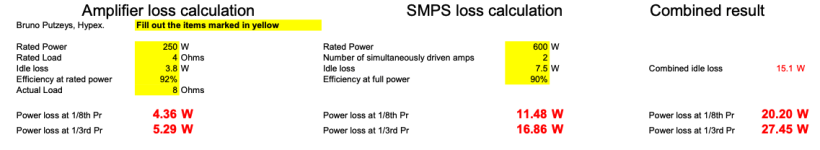

The efficiency is way higher but nothing is ideal so a small % of energy is converted to useless heat. If one is so intelligent to buy/build 2 x 400W modules to play back a few Watts then one can calculate what idle and power losses there will be. Of course that heat needs to be given to the environment. No way around that.
Now do the same with a 2 x 20W class D device. Then one will see that heat is practically non existing and heatsinking may be minuscule or even not needed. Now do the same for other popular topologies and understand why class D gets the "cool" reputation.
The made up myth is the absolute statement that class D needs no heatsinking. Not that it is not power efficient or not cooler (I would prefer "less warm").
The example is a 250W amplifier that has 92% power efficiency, 3.8W idle loss and 5.29W power loss at 1/3 of rated output power. The 9W losses must be given to the environment which is hard/impossible without any heatsinking. This while burning your ears with 2 x 80W continuous output power.
BTW there is nothing unfair when comparing topologies.

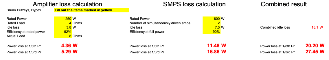

Yes, I agree with this.The made up myth is the absolute statement that class D needs no heatsinking. Not that it is not power efficient or not cooler (I would prefer "less warm").
