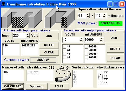

look at the picture below, it gives a core power rating even greater:
IMO that transformer calculator is not correct, the max power is much too high for that core. 220VAC with 16.7A primary (apart from winding space)? Forget it.

what is missing here is power density follows flux squared. there's no way in hell you can get 3600 watts from a 51 by 119 mm core, at .9T!! At 1.4T, sure, in fact it would be about 95% efficient assuming the core loss is under 100 watts and you can stuff it 75% full of copper, which means #10 wire for the primary.
To get that power, you need an EI 231c, M6-0.35mm quality (this core weighs 23.2 kg, which is about two times the weight of the EI150 with 119mm stacking height):
According to Waasner (EI 231c):
- secondary power 3890 watts;
- induction 1.7 T;
- iron loss 69 watts;
- copper loss 58 watts;
- efficiency 97 %.

The core size is a basic determinant of transformer power (VA).
The core maximum flux is a secondary determinant. The absolute maximum range of VA for maximum flux of 0.9T to 1.8T is only 2times.
As an aside.
Does the Klaic software show a limiting ratio for stack width to stack thickness?
Could it be that the arithmetic is correct for a square stack and that beyond some ratio limit the error becomes too great?
What if Klaic had stated (or does he state somewhere?) a ratio range of 0.75 to 1.3 say?
50.8 to 119 is millimetres away from square, (I wanted to type miles but would get hammered for that exaggeration).
That would make the software as good as useless.
For example, the EI96, EI120 and EI150N series start with stacking heights ("a" series) which make as good as square stacks; then we have a "b" series and a "c" series, the "c" series reach a ratio of almost 1:2 (EI150Nc has stacking height of 91mm).
Anyway I would not use that software; my Waasner data are reliable, being from the core manufacturer.
