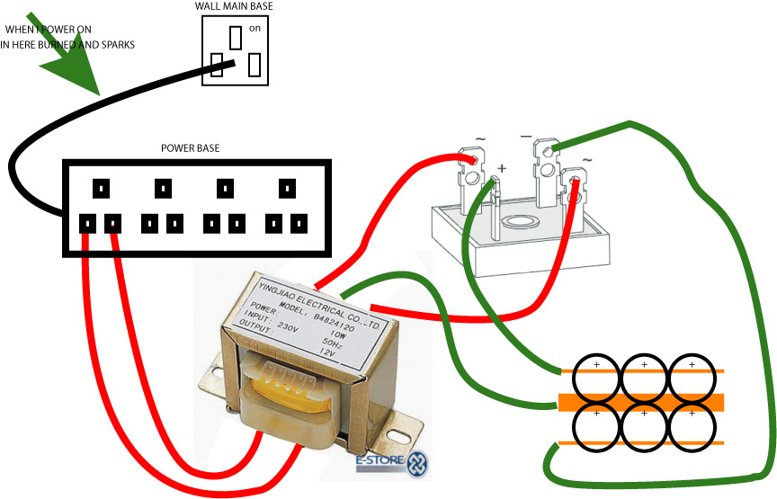

HI TONY.
one qustion,
when i power on, the power code cable is burned, but before no problem.10a transformer , 220ac, what will be the problem?
in the image the transformer is only for refference .
one qustion,
^did it happen quick?
1. your cable could be of the dinky type and,
2. possibly your power traffo has developed shorts....
hi tony ,
it happen quickly, wthin one second.
but before it works, with that power cord.
if the traffo is short, how to check ?
wire up a 50watt incandescent lamp in series with your traffo's primary, disconnect all secondary loads and keep it an open circuit...
if there is a short in your traffo, the lamp will light up fully brightly, this means a primary coil adjacent wire short...
if the lamp does not light, try to short the secondary leads, the lamp should then be fully on, extinguishing when you let go.....in this case look at your rectifier, or some shorted caps....
it can also be that the leads to the power base has become loose and might have touched the wire to the other line side......
thanks tony, i will check.
