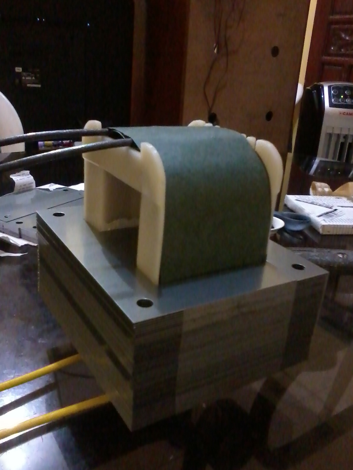

Here's my progress report of 2nd traffo with core 1 & 3/4" stacked to 3.6" having primary winding #turns 246 used about a kilo of #16 magnet wire. Planning to use for F5T. Hope to do secondary this weekend🙂
looking good Roland....😀

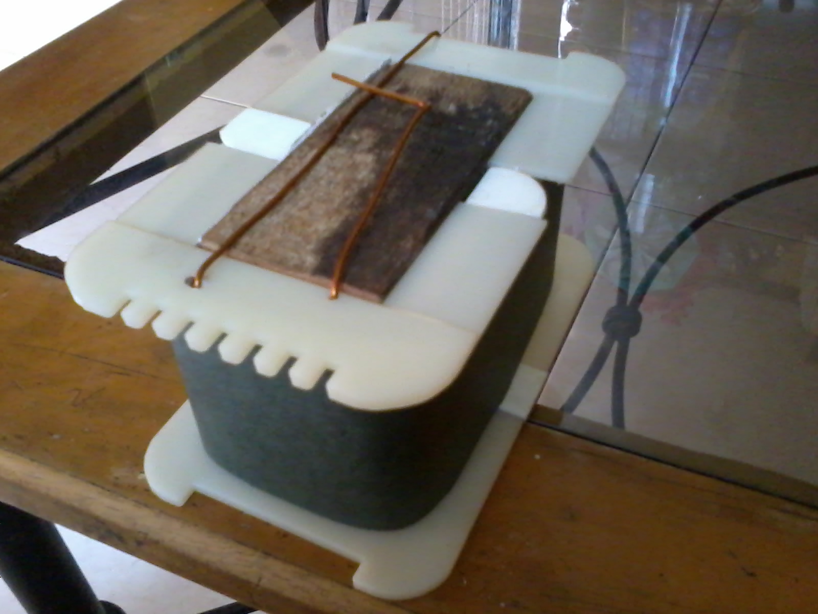

so the primary coil is put on my winder to count the number of turns which turned out to be 220 turns of #19 magnet wire, therefore at 230 volts this becomes 506 turns of #23 wire...
then comes the windup for the 230volt primary...

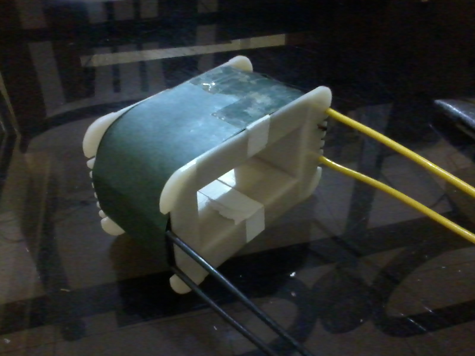

primary turns are counted on the winder...
there were 1008 turns of #30 wire counted, to convert to 230vac,
i wind 2600 turns of #35 for primary coil..
secondary windings have two coils of 170 turns each of #25 magnet wire..
winding new primary coil...
reinserting the E-I's..
finally putting back the endbells and brackets...
completed traffo...
