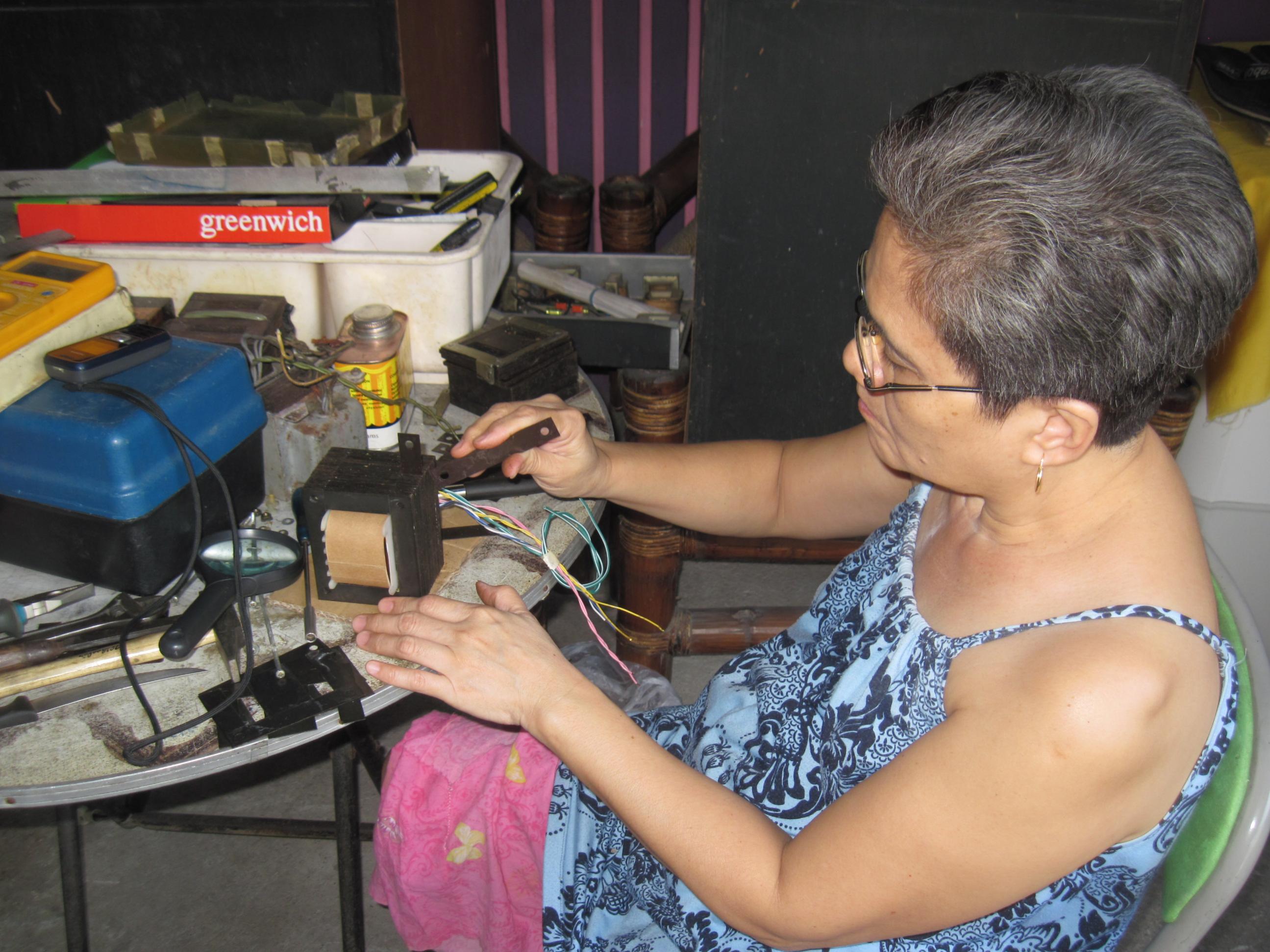

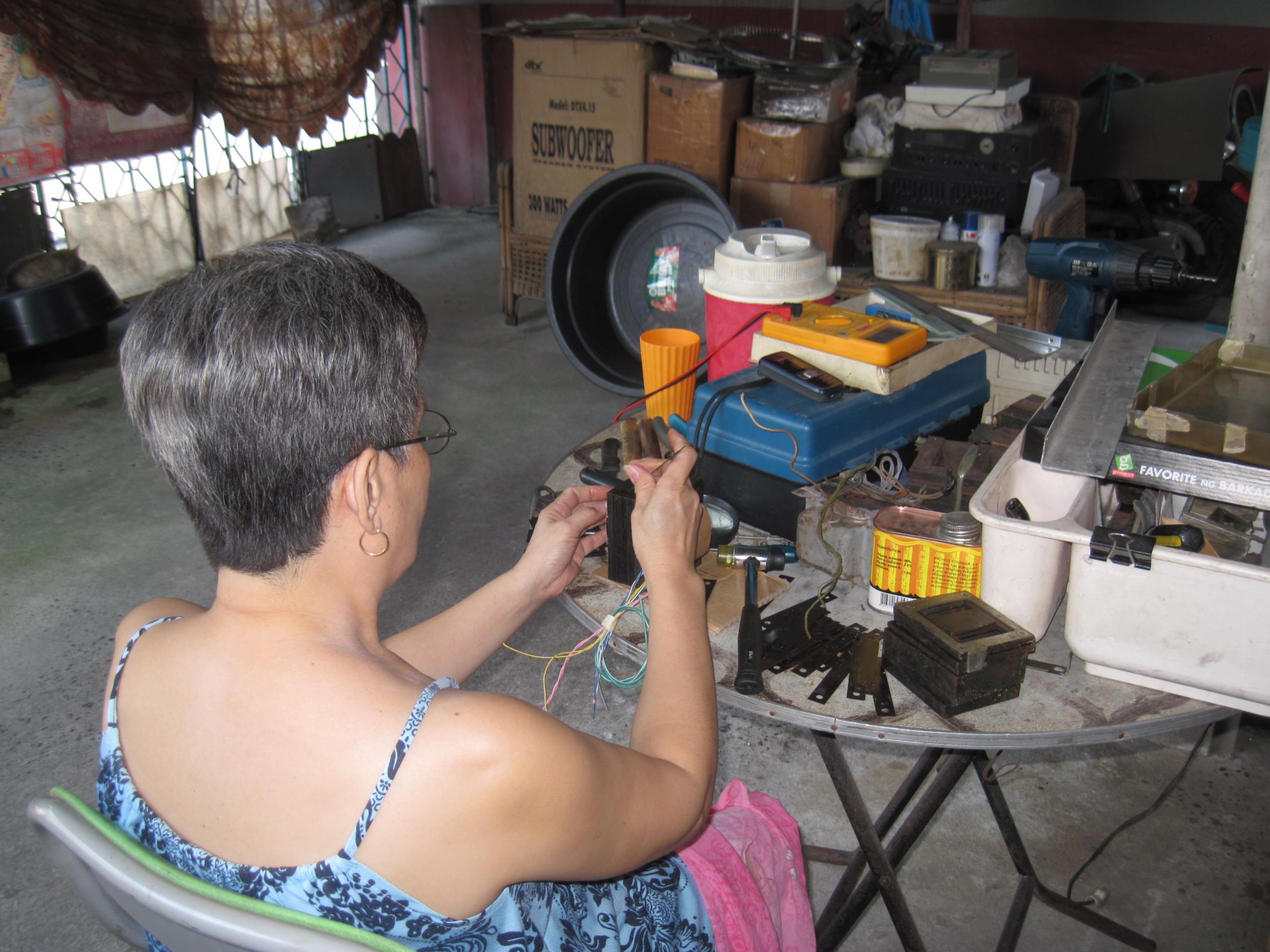

thanks, back in the 70's i wanted to have a made to order power traffo for a simple ss amp, since tubes were still very much in season then, the shops i went to, said they could not do it and thought i was crazy.....that started me in the traffo making hobby.....
DIY'ers are not concerned with the same issues as commercial offerings, that of engineering economics and profits.....
btw, i have enlisted the hep of my wife, she stacks E-I's for me nowadays...
