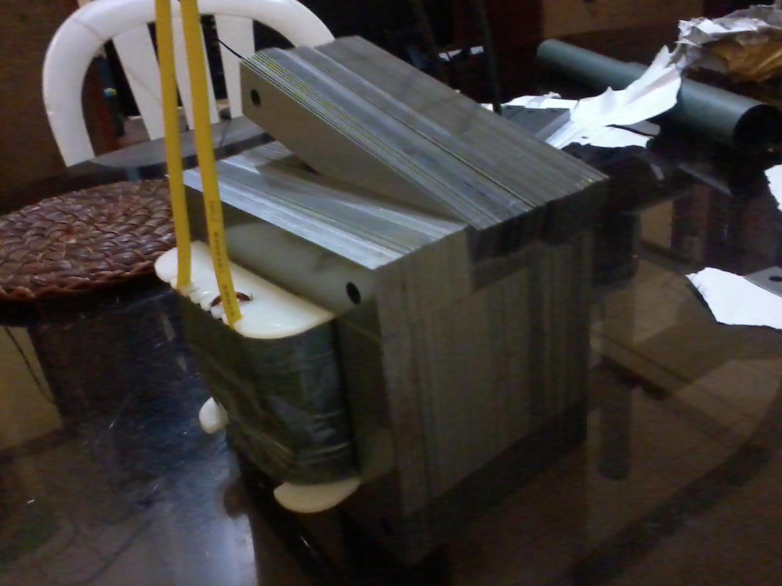

The eddy current losses are reduced by using thin laminations that are insulated from each other.
It appears that welding across the laminations does not substantially affect the eddy current losses, if the Weld Area is kept very small in proportion to the lamination area.
What effect does damage to the insulating layers on the laminations have on the eddy current losses?
I am concerned with the scratching of the oxide surface when I slide the Es and Is in from opposite sides.
Does the scratching through the insulation matter?
Should we take steps to minmise this?
Should we "repair" damaged oxide that is evident when we take apart an old transformer?

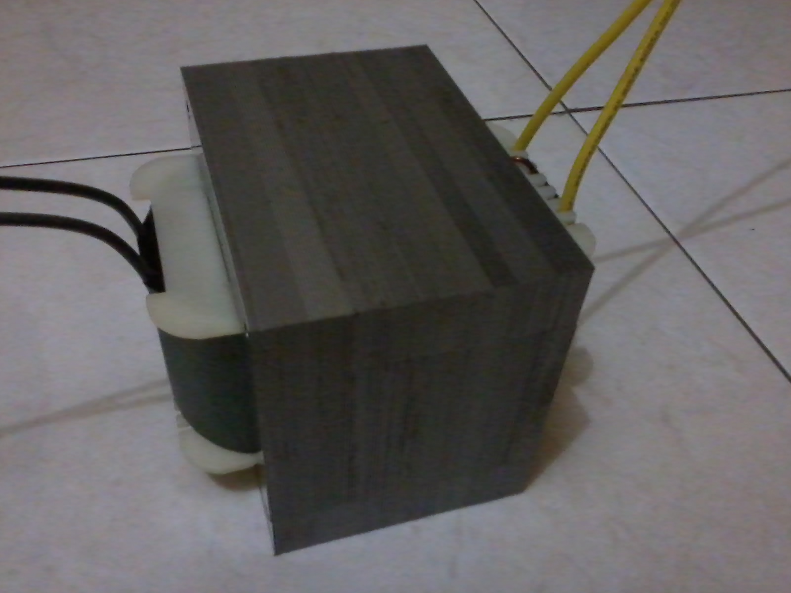

all your concerns disappear when you dip the completed traffo assembly into a vat of polyurethane varnish...
you will be amazed at how the liquid varnish gets in between the laminates no matter how tightly you stack them....

It's not big deal, not only because "the area is small" but because there is very little magnetic flux in tyhe corners, if any at all 😱The eddy current losses are reduced by using thin laminations that are insulated from each other.
We use rectangular cut laminations (so called "EI") because they are cut from a flat sheet, and we try to minimize scrap, but magnetic flux lines try to follow the shortest path.
Imagine a horse racing track , set in a rectangular field, and seen from above.
Now imagine lots of horses running there.
What path will they follow?
Will you find many horses in the corners?
That's why high performance audio transformer cores are "C" shaped.
More adapted to the actual magnetic flux path, they don't miss the 90º corners at all 😉
So soldering in the corners has very little or nil effect.
It increases losses, but you should grind them to bare metal to cause significative damage; small nicks and scratches don't matter.What effect does damage to the insulating layers on the laminations have on the eddy current losses?
It's incredibly tough.I am concerned with the scratching of the oxide surface when I slide the Es and Is in from opposite sides.
**Old** laminations (think 30's and 40's) had some kind of lacquer or paint which could scratch, but oxide or baked in surfaces are tough.
Just don't be Terminator or Hulk when stacking them.😛Does the scratching through the insulation matter?
No big deal.Should we "repair" damaged oxide that is evident when we take apart an old transformer?

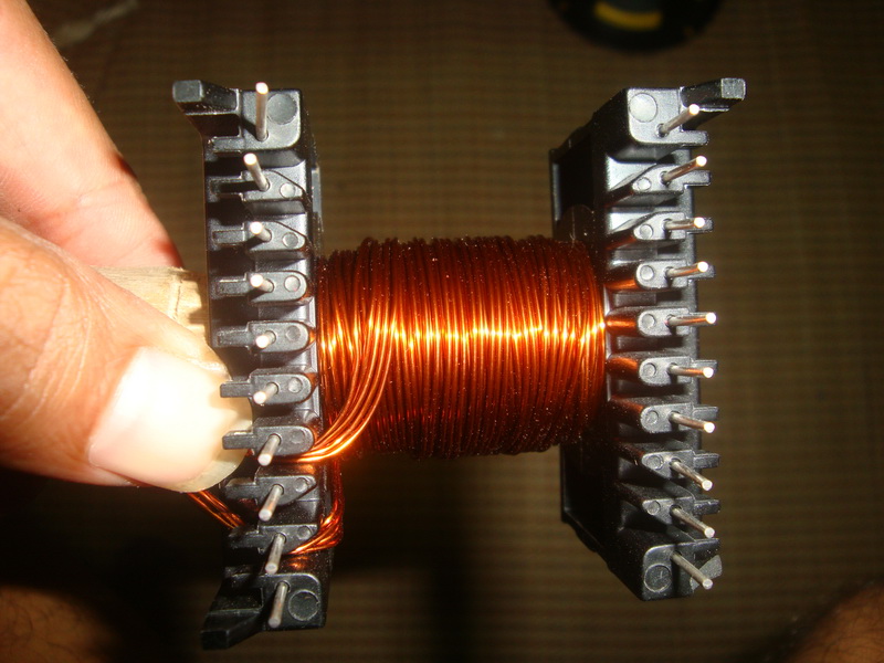

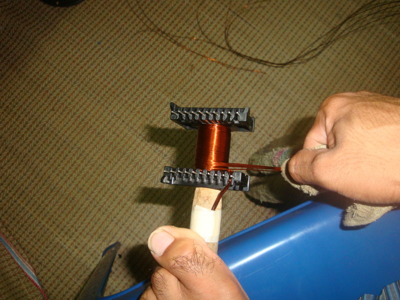

hi ajt,
can i parallel 4*.5mm gauge wire to wind instead 1*2.05 gauge wire?.
the thing is, it is the cross section area that counts...
take a look at the table below
2.05mm diameter is 3.3mm²
0.5mm diameter is 0.2mm²
You need 16 or 17 of these to match the area of the 2.05mm.

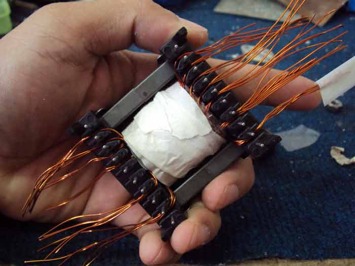

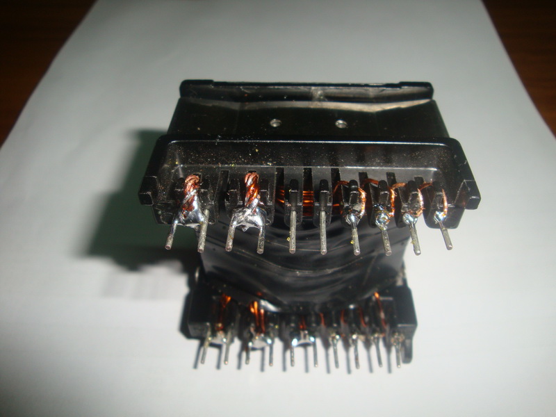

ok, i see you are making an smps traffo,
it is better to use several strands of smaller gauge wire,
good for skin effect....
