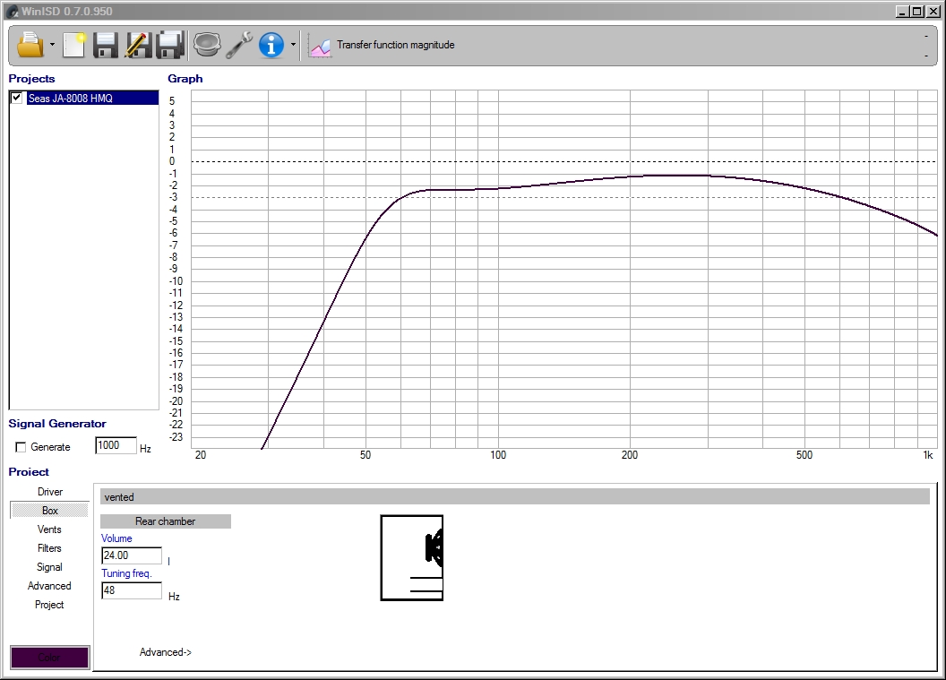

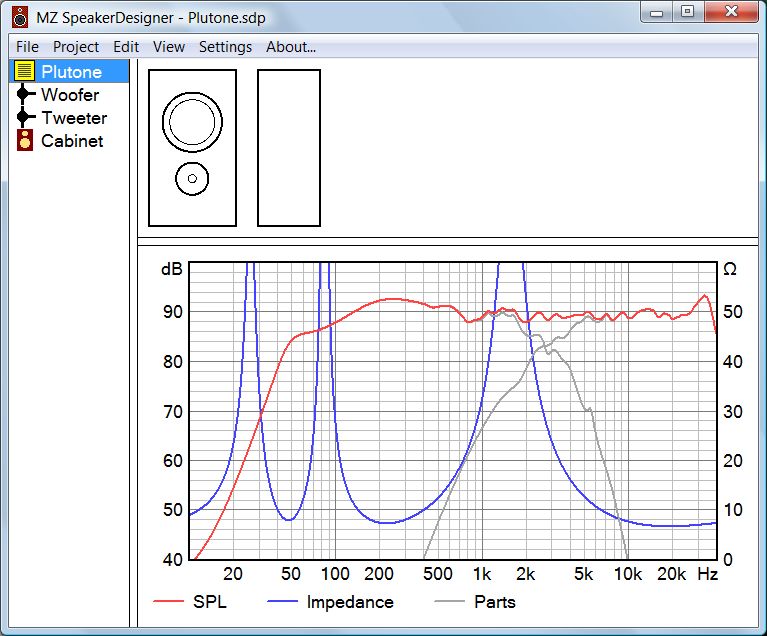

Measurements starting at 200 Hz raise the question, how does the low end actually look? Attached is a simulation of the Plutone which shows what to expect. BTW, the best phase alignment in the crossover region seems to be achieved at a vertical angle of 12 degrees from tweeter axis (at least in the simulation). :2c:

Just to add more simulations to this thread, here is the sim of the low frequency response of the Plutone.
The roll off above about 500Hz is the simulated 1st order crossover + voice coil inductance.

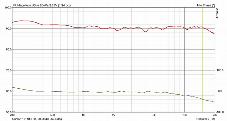

Just for reference I have also attached the real-life measurments above 200Hz (measurement taken on listening axis = woofer axis).
