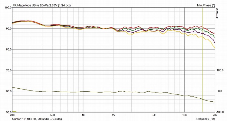

Plutone on-axis and off-axis measurements: Red on-axis; Green 15 degrees off-axis; Purple 30 degrees off-axis; Yellow 45 degrees off-axis; Range 200Hz - 20kHz / Vertical scale 50-100dB; subdivisions 2dB's
Crossoverpoint from woofer to tweeter is at 2400Hz.

From what i see there is about 3dB dip starting at 2.8KHz so that's why i would really like to see 60deg measurement and measurement on axis at the same graph
Individual driver rolloffs would be great just to back up the claim for 2.4KHz xover frequency.

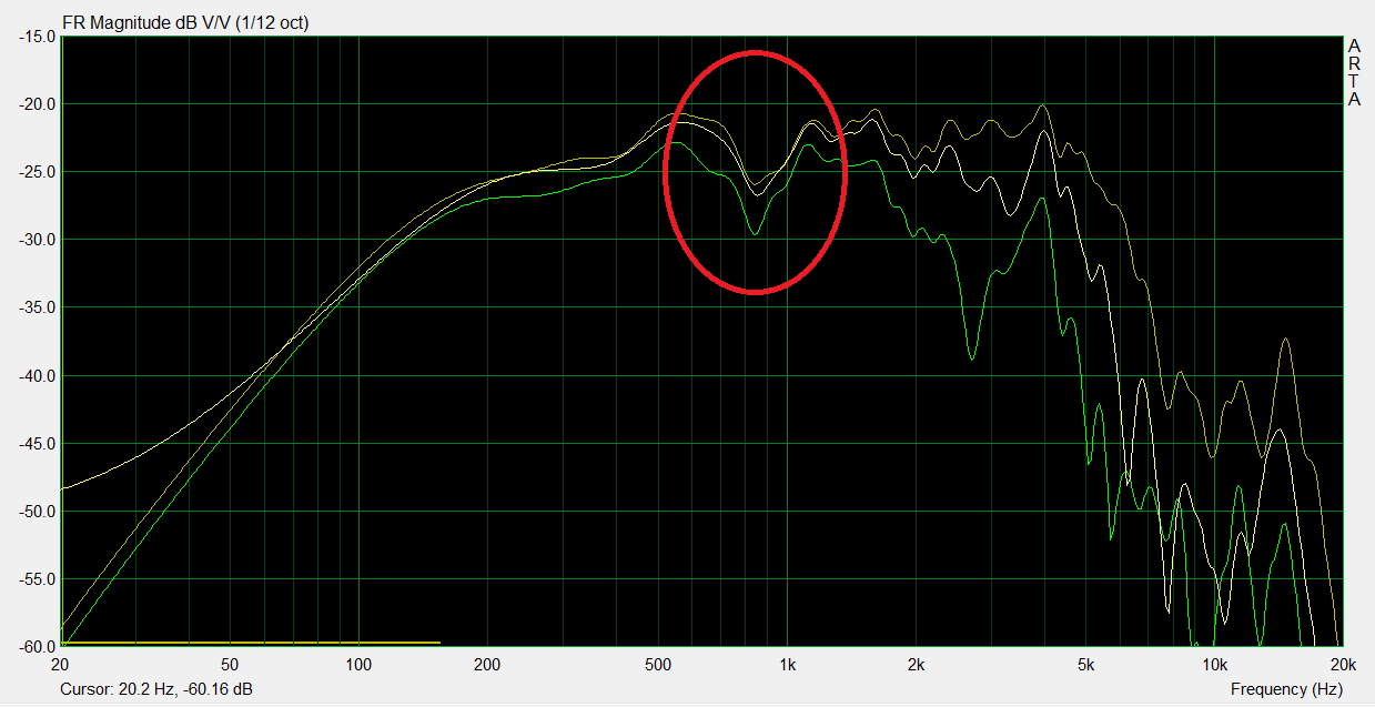

A reflection would show differently under different axis. Shape is the same a 0º, 30º, 60º, so it is clear for me that this is no acoustical problem (reflection, baffle diffraction effect,...) , but a mechanical one, cone/suspension resinance.
It's true that many driver, especially paper cones, show problems like this, but in this case it's pretty ugly, especially for a masterpiece boutique driver...
But what bothers me most, is some efforts to mask the sad reality, like this one:😡

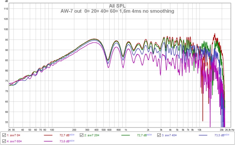

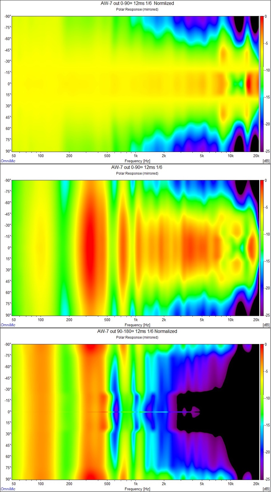

I bet that those 600-800Hz are baffle edge interferences, they do appear also off-axis as you can see tfom this measurement done outdoors yesterday. A6,5" woofer (coax SEAS) in 9" x 13" box. I measured also backside radiation! 180Hz is ground reflection.
And all your deeps above 180Hz are odd multiples of 180Hz: comb filtering! What about putting a shorter time window? 😛
Btw, Zaph says he usually merges at 600Hz. It looks like in this case he has been generous/forgiving enough to merge higher, where it hurts less...😀
Your set up is nonsense. i am sure you cannot even afford 1ms at that distance. Why go outdoors to do that mess? Trying to emphasizes the floor reflection effect on a bad measurement, or just enoying summertime?
