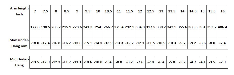

Hi, After some extended trials I have refined the Under-Hang chart & added a minimum & maximum measurement. Set at near the minium measurement for my arm I now hear no distortion on any LP's. It will pay (if you hear slight distortion as a hardness) to move your arm slightly in the suggested window.
Cheers
Hi, Well I have been doing so more work on this & getting some very impressive results. I also have just drawn up a alignment template which can be dounloaded. It is in .pdf form & you will nee to adjust the printer page size to get the correct measurements, mine is a 100.1% enlargement, but other printers of course will be different.
