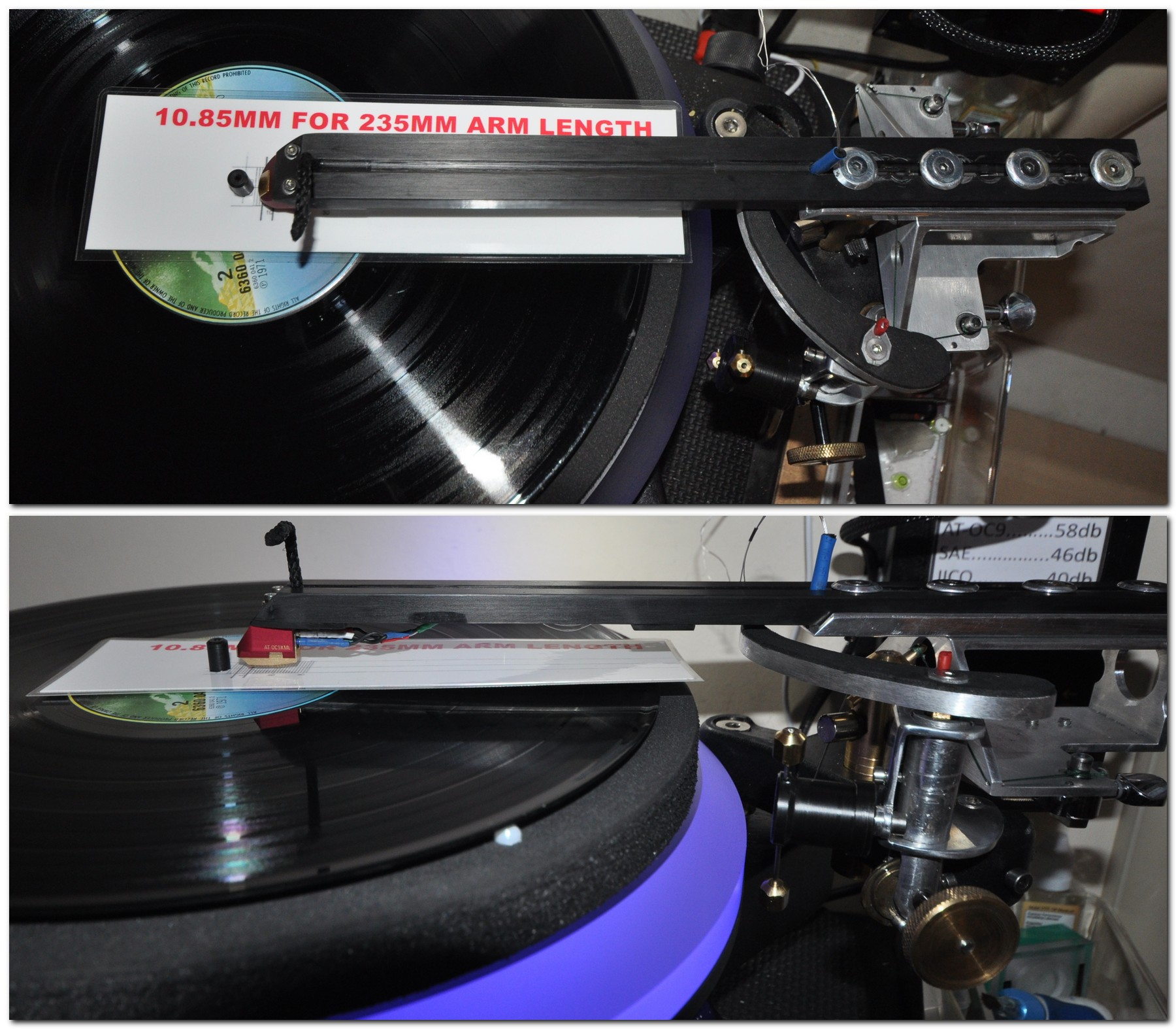

Hi, Yesterday I got my SP10 finally going & mounted a SPU GE set at -8.5mm Under-Hang on the 12'' Temaad arm I have.
Holy S**T, talk about dynamic impact of a system, I was amazed at the the grip on preceding's. This table managed to out class anything I had ever used before. The sound from what is supposedly lowly MC cart really sung out in Under-Hang. With the bass & sound staging being particularly impressive.
Cheers
Cheers

I too am a recent convert.
Adapted a wand to underhung on my Supatrac clone, and used DNic's protractor & calculations (thanks!) The slam on the Supatrac was amazing in offset mode, but now its like on steroids.
I have retained the antibias though, as there was quite a skew on the cantilever the first half of the record. Rights itself midway, but I find with my variable antibias mech, there is no skew all the way through the record.
I have returned to offset several times during testing, but can't unhear the underhung. I dont think I will go back......

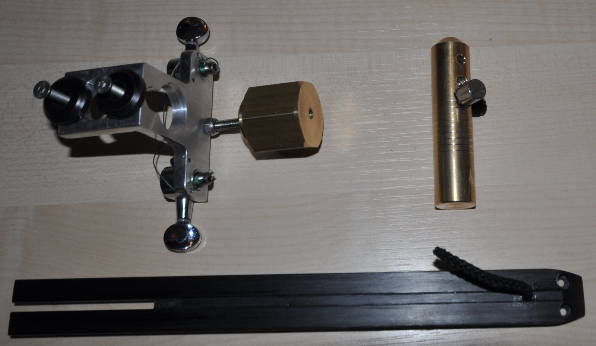

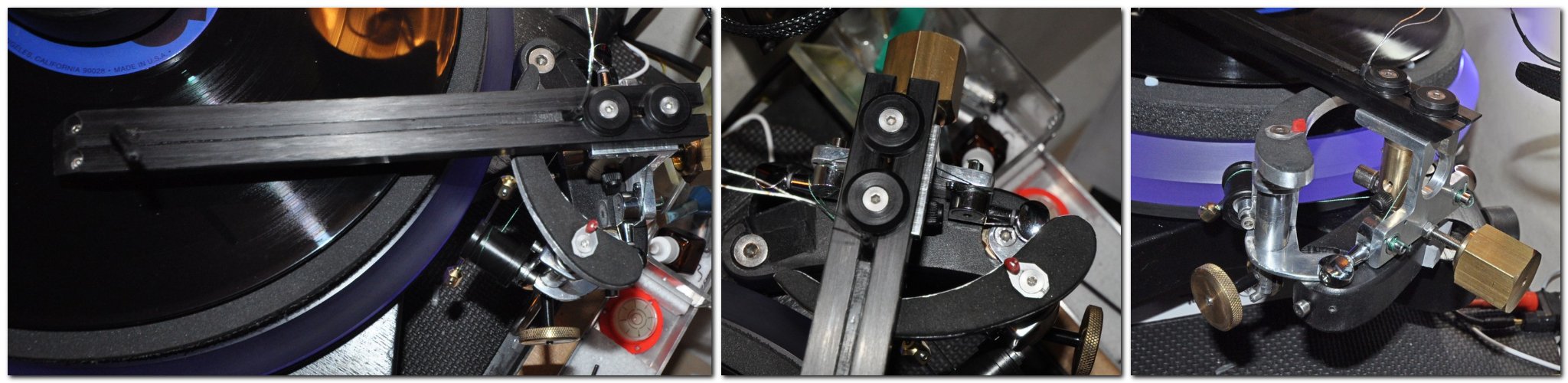

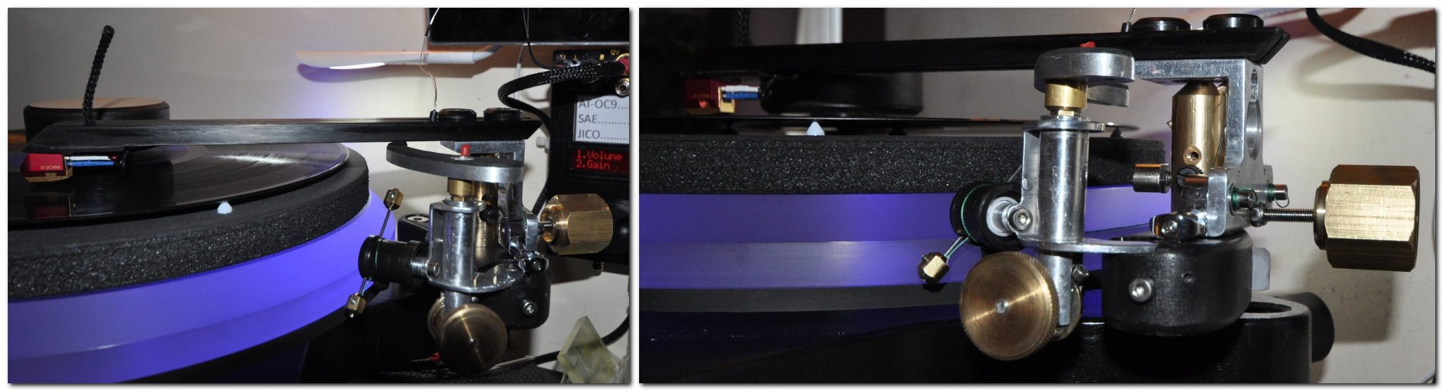

After observing my video I realised someone would pick that up. I was using Norwegian Mood, Side one, to test skate behaviour at runnout (which only has 2 tracks on it) so the runout groove actually starts at the null point. Shudda changed record for video to avoid confusion in hindsight.
I am running an underhung arm at the moment, so the 'null' point on the arm is just over half way (10-11cm from spindle center). There is a torsion effect from the Supatrac string so you can counteract this to a certain extent depending on where you position the pivot, but I set it to match the underhang null point. So my arm behaves as a typical underhung arm.....inwards skating force, then outwards.
Observing the skew of the stylus while playing a record (no bias) the start of the records causes a severe inward pull, so the skew is toward the outer track, and this skew persists, but lessens, until the null point, where it totally centralises. After the null point, I can see no skewing, so assume the force outwards is of a much lower magnitude than the force inwards. I figured an easy mod to my anti-skate device to counteract the inward force, and gradually reduce as it approaches the null point, then stop. By adjusting the counterweight I can control this force so the stylus remains more or less centered thoughout its travel.....at least to the naked eye.
I am now working on a new underhung arm with a heightened hoist and decreased width between string holes on the thrustbox. I am thinking increasing height between hoist & pivot will lessen and reduce string angle from hoist to string holes will reduce torsion effect and therefore force on stylus. To me its worth pursuing as it sounds so damn good!
Cheers
Vic

Guys
Finally got this arm working. Thing with Supatrac is all the settings have to come together at the same time.
Made a totally new arm dedicated to underhung/Supatrac and replaced with the thrustbox and with an L-plate. Main issue, as we know, is null point half way across the record from the underhang, which is fighting the torsional forces of the string suspension.
As Rick suggested, I tried moving the pivot to overide the underhang null point trying to get it to behave like a normal offset arm. Even the setup I had before using the antiskate only half way need the pivot to be at an extreme which made parking the arm unstable.
My lastest idea was to tension the string with a clockwise twist. I was shocked that a single twist worked! The arm now has a tendancy to skate inwards, like a regular arm. It was easy to apply a counter-force which worked all through the arm travel. The pivot is in the correct position, and the arm parks easy. Early days, but looks promising!
