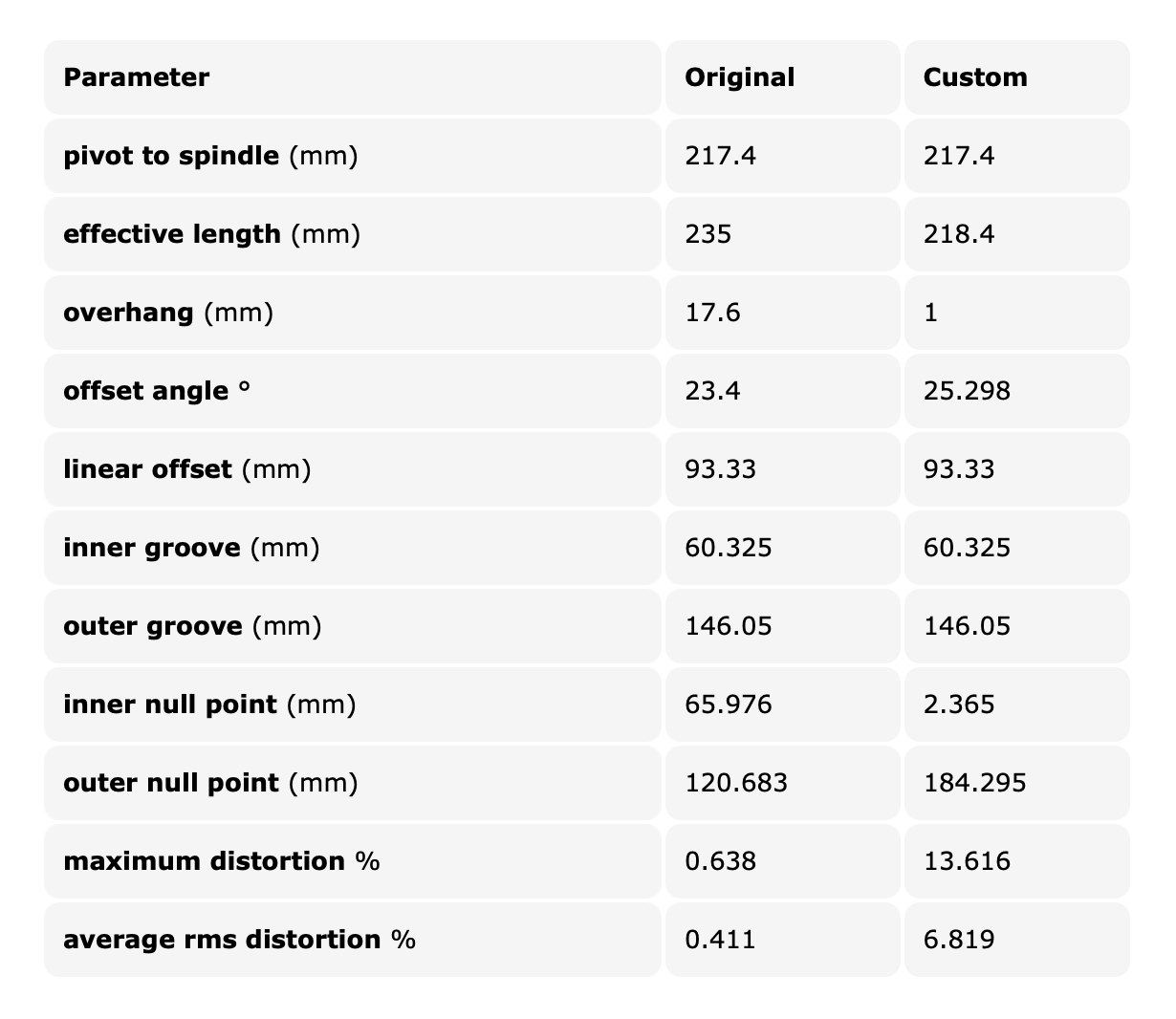

I will assume that you move the base of the tonearm to achieve underhang. However, I just can't imagine how you set the arm to minimize tracking errors. Here is the calculation I did for you. I wasn't able to set a negative value for overhang. The minimum value I could enter was a 1 mm overhang. You can see the maximum distortion jumps from 0.638 to 13.616. Average RMS distortion increases from 0.411 to 6.819. I just can't imagine how big these distortions values will be if the arm has an underhang.

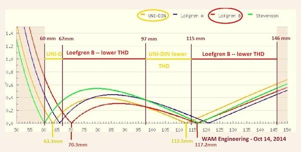

This topic has been discussed to death. The underlying theory is a completely mature calculation and doesn't need anyone to modify it. Here is a nice article
https://www.analogplanet.com/content/uni-din-versus-löfgren-b-just-clarify
I personally like Lofgren A and Uni-Din because these two take a more balanced approach. However, it is a personal choice after all. It depends on your playback equipment as well. There is no right or wrong. If you like, you may even pick your custom null points. Certainly, we don't need underhang playing back and wiseoldtech's one-point alignment.
Reactions: Ixnay
Hi, Reading trough the article, I am not sure what UniDin actually is. However it did not seem to be suitable for setting up a tonearm for the Under-Hang alignment, unless I missed something.
The yellow curve in the image is Uni-Din. Its null points are inner null=63.3 mm and outer null=112.5 mm. You may see Uni-Din method moves the inner null to 63.3 mm. It puts more emphasis on the inner groove than Lofgren A, blue line, while its tracking errors in other areas of record are relatively low. Lofgren A, blue line, inner null=66 mm, and outer null=121 mm.

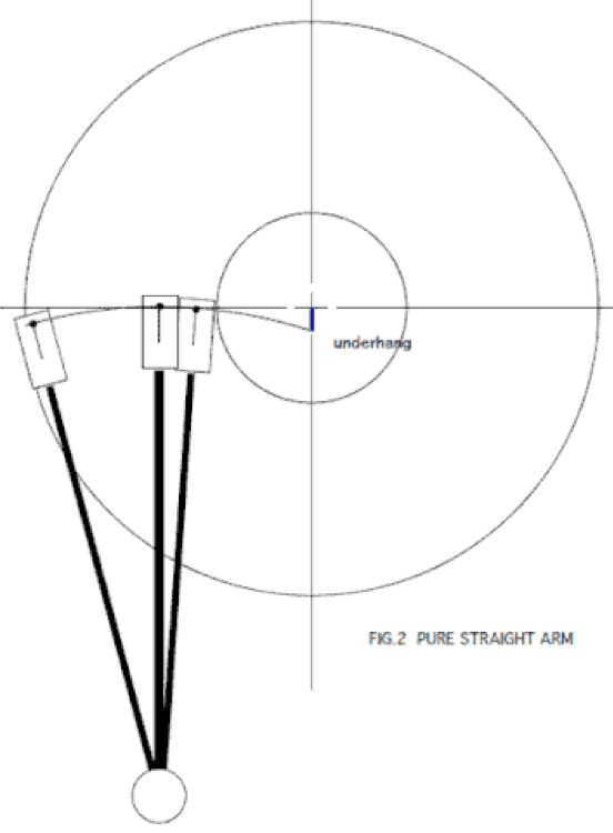

As to underhang, here is a drawing from one of straight arms manufacturers VIV LAB. The same drawing with explanation was on RS LABS site several years before (for now their straight arm discontinued and all information about it disappeared from their site). Few other manufacturers of expensive tonearms continue making and offering very similat arms. The problem is, if to apply school geometry and physics to build vectors of forces of straight arm with underhang and compare them with such of traditional arm (with offset angle and overhang), there is questionable advantage in the decrease of skating force with straight arm. On the drawing we can see three positions of arm: 1) On outer groove, there will be inside skating force close to that of normal arm, and gradually decreasing as going to 2) Second position closer to inner groove, and there really will not be any of skating force existing, 3) Third position, from that point going inside there will be very small outside skating force. To be honest, I must admit what skating forces with straight arm are smaller (or absent) for the inner half of recorded diameter of LP, than those with traditional arms. And for outer half it is rather similar.
I am not surprised if they are out of business. These companies make tonearm based on their own theory and are entirely wrong.

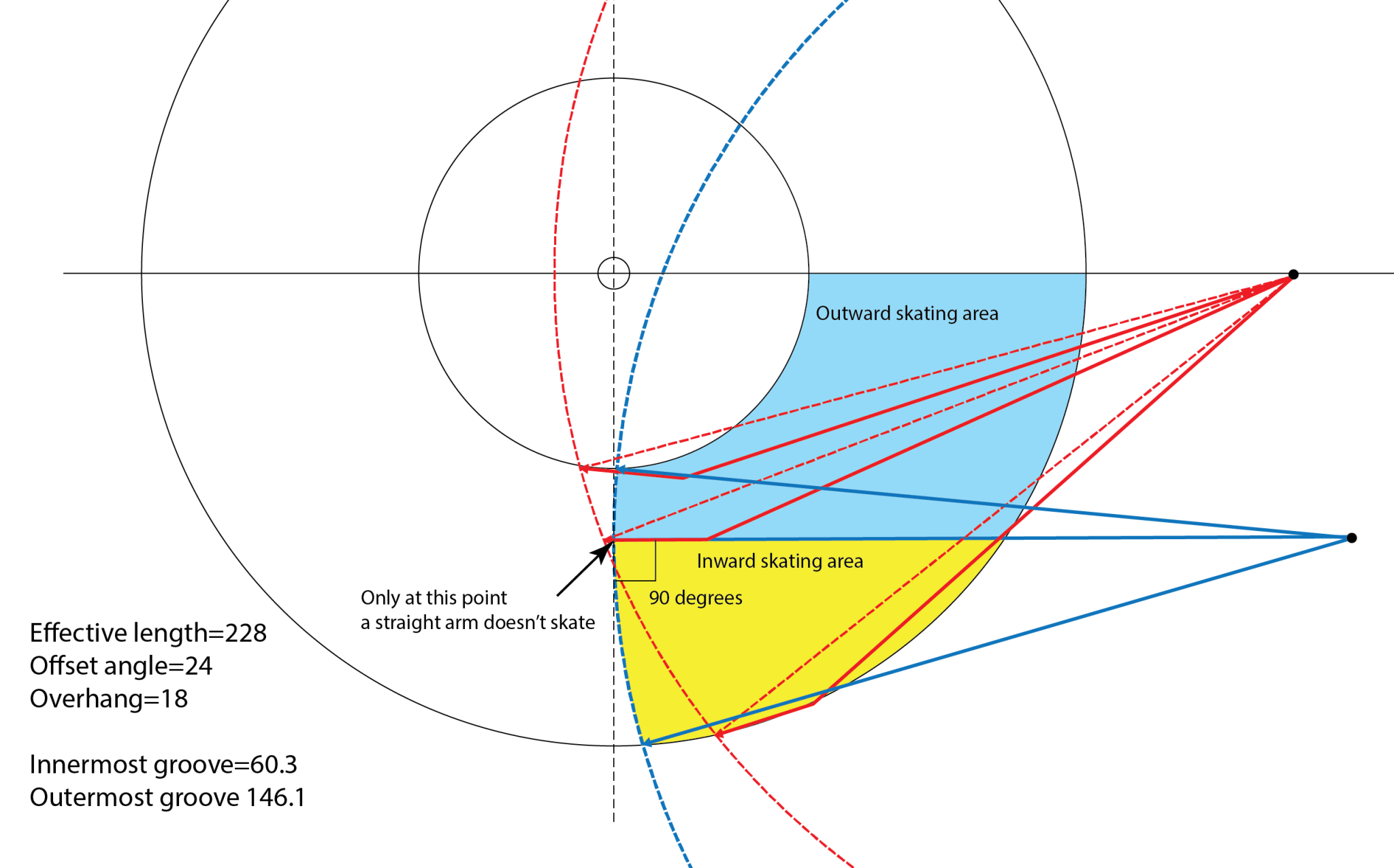

This is not true. All the straight arms don't skate only at ONE point at which it is perpendicular to the spindle. All the rest areas, a straight arm skates. In the following diagram, blue lines indicate the positions of straight arms. The red lines indicate the positions of a regular pivot arm with offset angle and overhang.
Is the skating force for a straight arm smaller than a regular pivot arm? I don't think so. The average tracking errors for a regular pivot arm must be smaller than the average tracking errors for a straight arm. Therefore, the skating force for a straight arm may not be necessarily smaller than the skating force for a regular pivot arm. However, further study is needed.
In addition to the skating force, what about tracking errors? The goal is to minimize tracking errors by introducing offset angle, and overhang. For the straight arms, how does it minimize the tracking errors? If the effective lengths are the same, I have no doubt that regular pivot arms will have less tracking errors. If the skating force for a regular pivot arm is larger than a straight arm, no problem, increasing the anti-skating force may solve the problem. But for a straight arm, how do you apply anti-skating force? The skating force for a straight arm isn't in one direction.

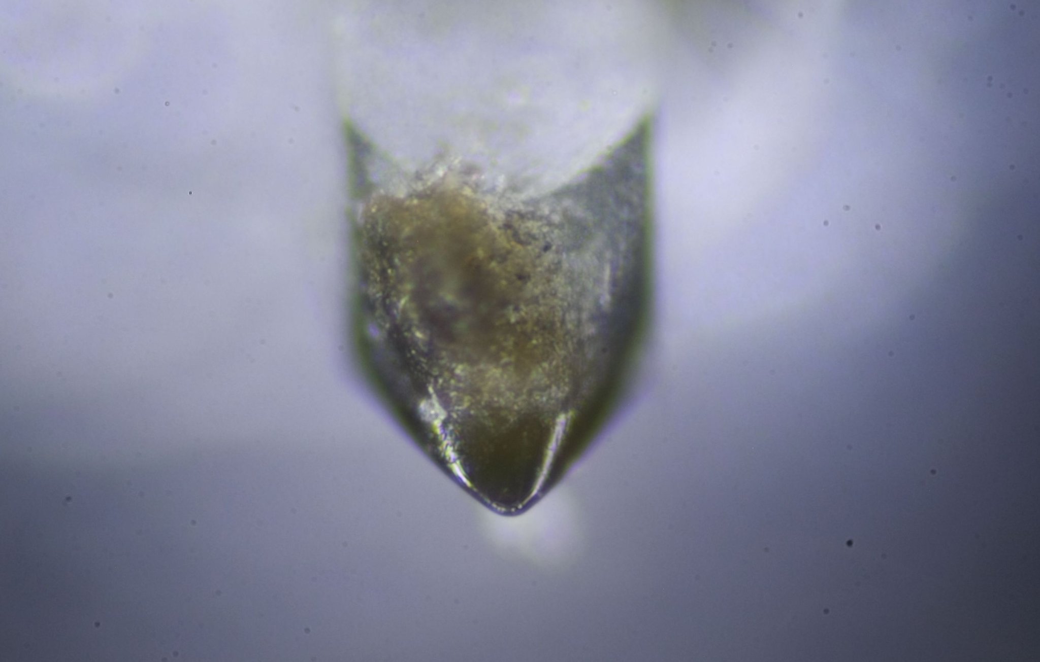

There is a very simple way to measure with the oscilloscope and test record both output levels of right and left channels and out of phase disbalance (as a result of angular mistake) of traditional and straight arms, and compare the results. There can be clearly seen how change in antiskate force affects L and R output balance. By the way, absence of proper antiscating results of uneven wear of stylus (see photo). Unfortunately, I do not have oscilloscope or fosgomemer now. Measurement results would be very convining, if put here on this thread...
