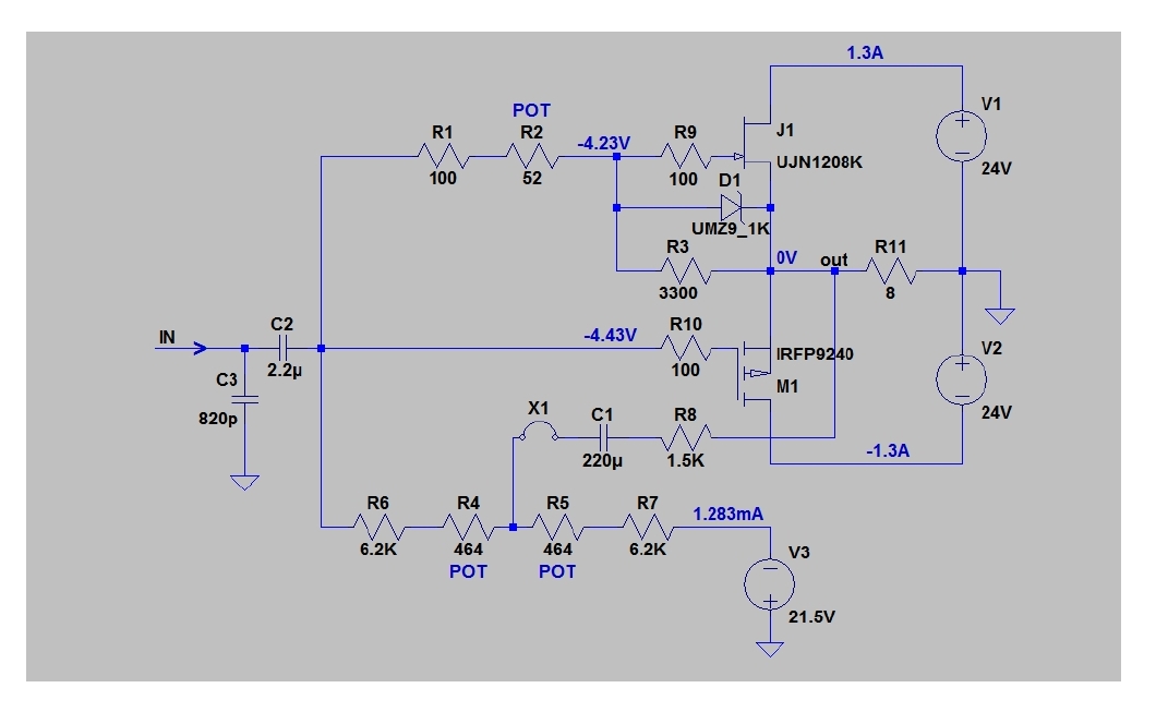

SIT accelerator
In the BAF 2016 talk by Nelson, he shows a schematic labeled "DEPLETION / ENHANCEMENT FOLLOWER 2"
That schematic sets the bias of the SIT more negative than the bias of the enhancement MOSFET.
I call this putting the brakes on the SIT.

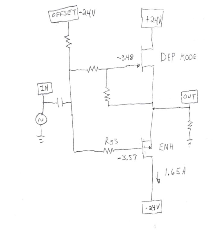

What my pair of devices requires is applying the accelerator to the SIT.
A re-drawn schematic of my pair of devices is attached. The Vgs values are for power supplies of + / - 24V at Ids = 1.65A at 48 deg C with zero offset between output and power supplies common.

Yes, it's true, I wanted to say that yours too string resistances with Vgs PMos > Vgs NJ, in absolute value, adjusts the output offset.

For the pair of devices that I am using, 67 mV is the difference between the two gate voltages.

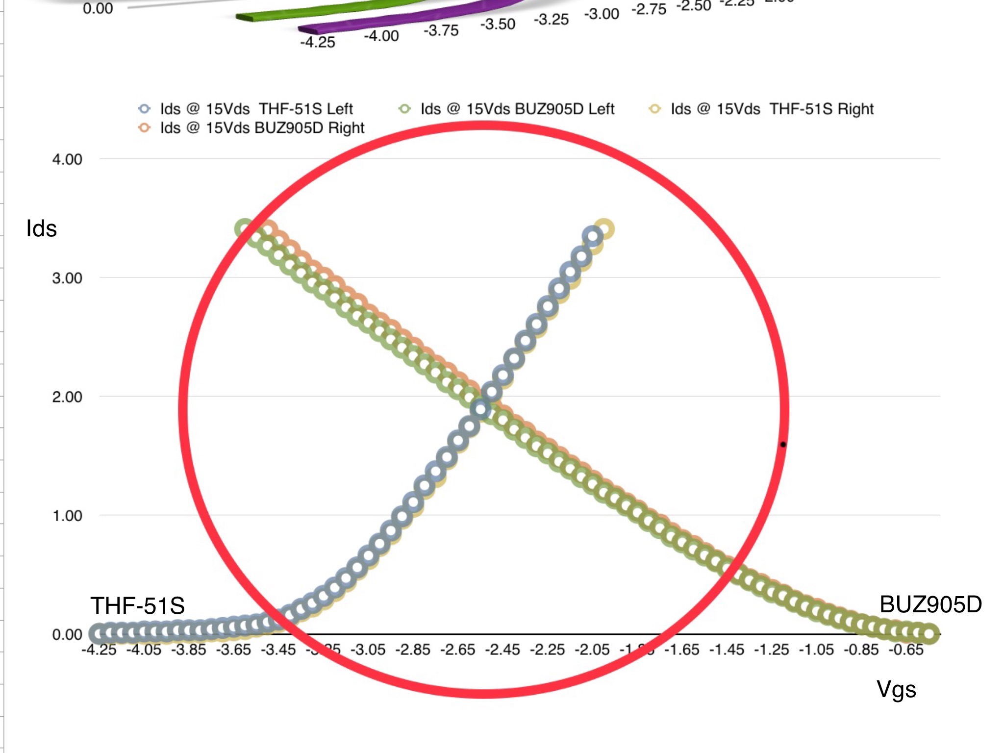

Hi Woofy,
I cloned the SIT-3 with BUZ905D and THF-51S.
Without any source’s resistor, Ids and Vgs were traced and graphed.
