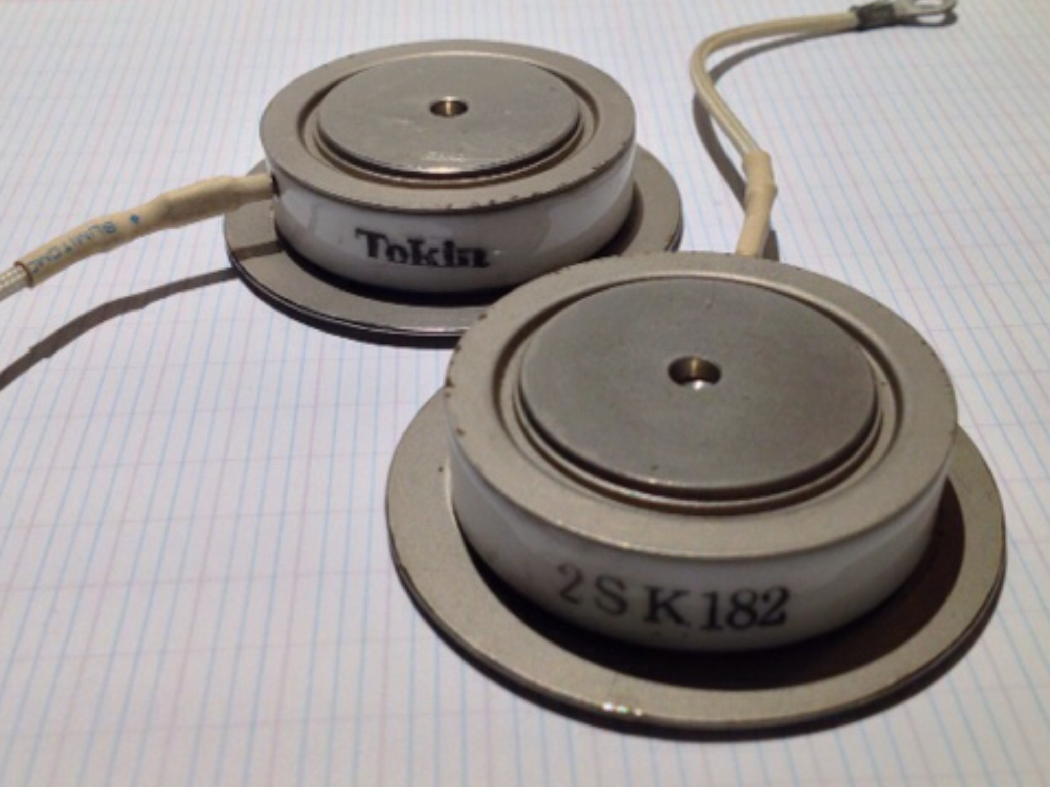

The name SIT has been the source of great confusion. Only certain depletion mode devices with a high cutoff voltage will display the distinctive character. These V(groove)FETs have a vertical structure and an insulated gate while JFETs have a gate-channel P-N junction diode.

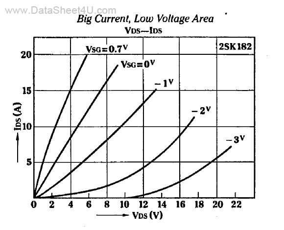

The SITs that I have conduct current from Gate to Source if you apply
more than 0.6 volts, so I have to assume we are dealing with P-N
junctions.
The 2SK182 is a limitedly exciting enhancement mode transistor meant to be used as a switch.
One man's enhancement switch is another man's depletion triode-ish JFET.

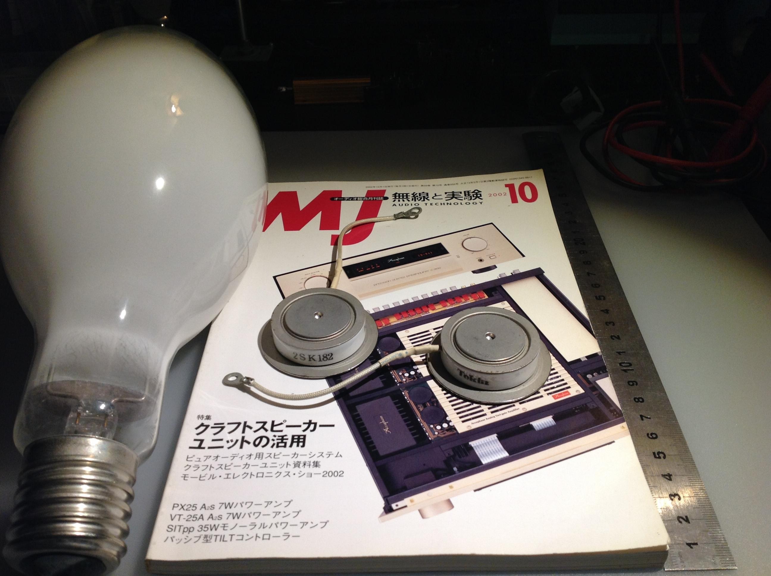

Frankly, I don`t think that the 2SK182 is any better than the IRF MOSFETs, but the 2SK60 / 2SJ18 is a truly remarkable technical and technological achievement. The 2SK182 and the 2SK60 / 2SJ18 have nothing whatsoever in common.
The most striking difference being that one is extinct while the other is freely available on the open market (at DIY volumes) although, admittedly declining.

What is measurably different between the 2SK60 and the 2SK182 that would make a difference in an amplifier circuit? I have some of each transistor and I have access to a modern calibrated curve tracer. I will be happy to explore your assertion and post results here.

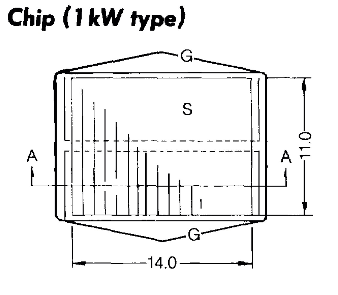

Curves from post #47 are about 1KWatt's power dissipation SIT.
The same part numbers but without ES 🙂 Greetings
