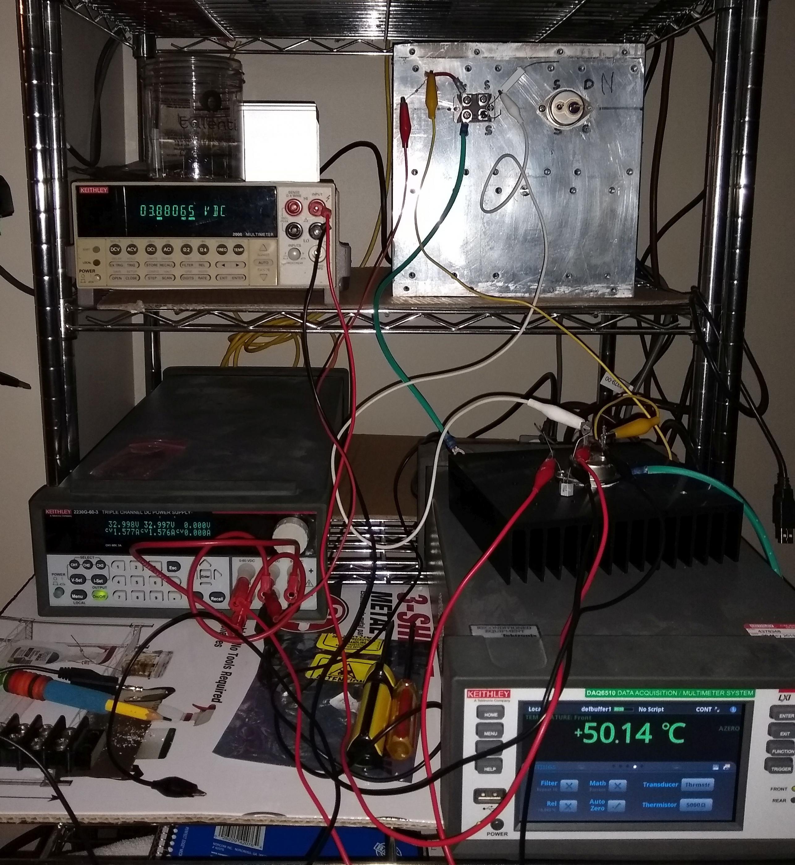

All of the measurements above are without heatsink for the Tokin SIT. With a heatsink for the IXYS hockey puck P-FET.
Today I drilled and tapped a heatsink for the Tokin SIT.
One of the tapped holes is to mount a Vishay threaded head 5k ohm thermistor.
Vgs measurements over temperature ongoing now.

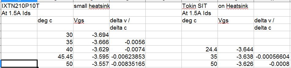

From initial observation, the Tokin SIT Vgs moves 12mV between 35 deg C and 50 deg C at 24V Vds at 1.5A Ids.
My guess is that the hockey puck P-FET Vgs moves a lot more over that temp range since.

Running these devices in tandem as a follower pair on the bench now. Using + / - supplies to allow me to easily see balance of the two halves.
The bias current and offset voltage is very temperature dependent.
At 50 deg C and 1.5A bias and as close to zero offset as possible, the Vgs values are -3.26v for the Tokin SIT and -3.568v for the IXYS puck.
The transconductance of the Tokin SIT at temp at 1.5A Ids is ~2.8 and the transconductance of the IXYS puck is ~12.
The tempco of the IXYS puck is ~10x the tempco of the Tokin SIT
I am wondering if degenerating the P-FET puck would help with matching the tempco of the parts better?
.... or the bias circuit needs one or more thermistors.

Any degeneration will improve the temperature dependency, and a small amount
on the more offending part might do the trick.
Thanks. I just inserted a ceramic 0.22R multi-watt resistor and re-adjusted the bias. -3.2v on the Tokin SIT and -3.9v on the IXYS puck.
The inserted resistor increases the spread of the gate voltage differential.
The behavior of the Vgs vs temperature is now much slower and easier to dial-in.
I adjusted the bias at 1.5A and offset for 0 for 45 deg C or so.
On a really large heatsink, at room temp, the initial offset is 4.5V and is slowly drifting down. The initial bias is 1A.
I will see how things look after an hour of warm-up.
