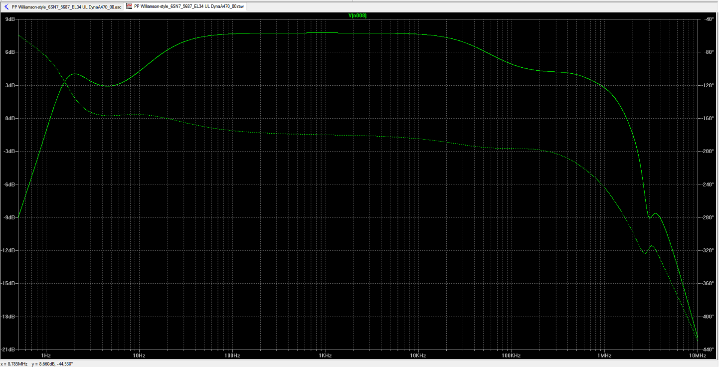

Do you get subsonic peaking from the zero in the feedback 5uF/33K ?
Yes, it's there. It's -5dB from 1kHz at 2Hz, though. Shown in the attached graph. I probed that at the grid of U3 (EL34). It looks pretty much the same at the grid of U4.
Does that look like it will be a problem?
Edit to add: I increased the value of C10 and C11 to 1000uF. That decreased the peak at 2Hz by about 6dB. I understand that the long time constant in the EL34 cathodes may cause blocking problems. But decreasing the value of C10 and C11 to 330uF increased the 2Hz peak by 6dB. Offsetting problems here.
Also: I put a 100pF cap in parallel with R19 (47k plate load resistor for U1). That tamed the broad peak from 700kHz to 1MHz or so. Closed loop -3dB point is at about 48kHz now.

Just on general principals, it's a good idea to have the equivalent of a "dominant pole" at low frequencies. Williamson recommended (in his later papers) setting this around 4 Hz and locating it at the output tubes' grids (because clipping occurs here in an optimized design, and we want to minimize hang time when clipped). Stability is a potential issue too.

You might try making the cathode bypasses *very* large, but the 5uF/33K is causing the problem. I'd still want the cathode circuit time constant to be very far away from 4Hz, at least a decade lower. This is a major weakness in all the old classic designs.

Of course, the 5uF/33k is also giving us lower rp and distortion from the EL34's, which should yield better damping factor and lower distortion. Once again, there ain't no free lunch.
What happens if I give the EL34's a single common cathode resistor and leave it unbypassed?
Answer: That totally cures the 2Hz resonance, but it also increases the distortion by 2X, and changes the distribution of harmonics so that 3HD is higher than 2HD. It's still low, though, at 0.039% at 1W into 4 ohms. But that's closed loop, which isn't all that great.
I'm not seeing any benefit from raising the cathode bypasses higher than 1000uF. I tried up to 4700uF, but it only decreased the 2Hz resonance a tiny bit. The difference between 330uF and 1000uF is large, though.

I sorry I wasn't more clear. The issue comes from the time constant; making it sufficiently larger than the grid couplings' time constant is what's needed. 50uF or 100uF should do it.
