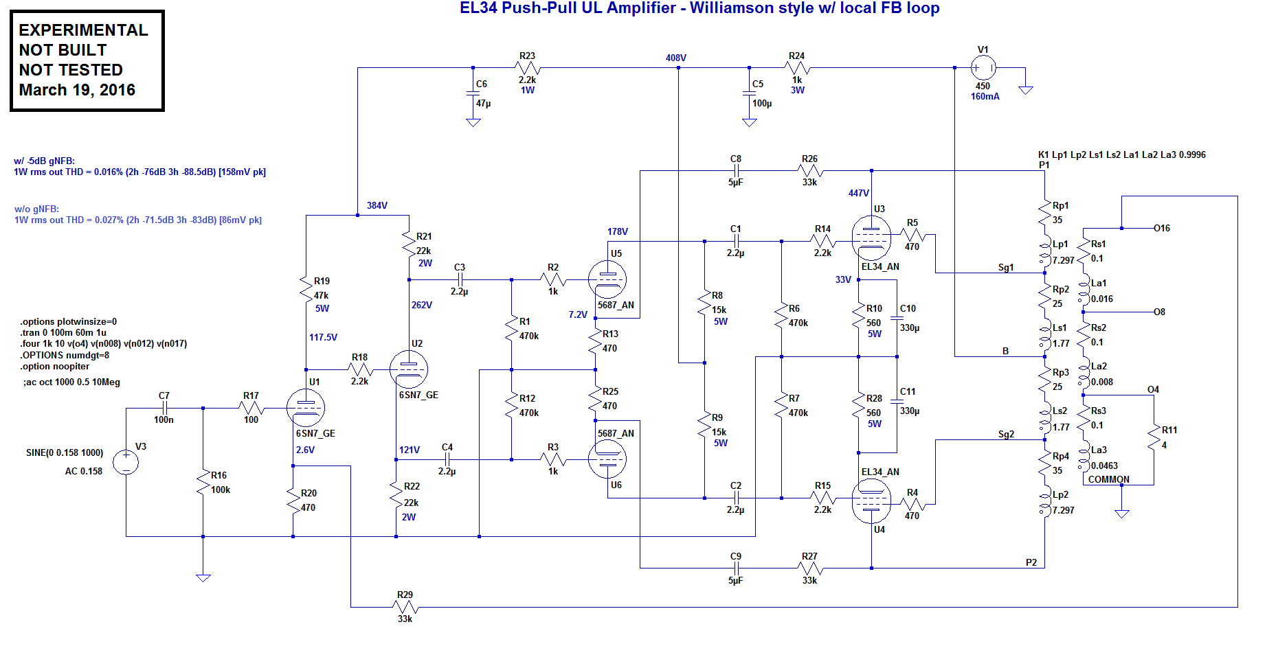

In the meantime, I used LTspice to do the math for me. I don't know if this would hold water in real life, but it looks good in the sim.
PP EL34 UL with Williamson-style driver, using 5687 as the PP driver stage.
Uses EL34 plate to 5687 cathode loop NFB.
Option to add gNFB from OPT secondary to cathode of input stage 6SN7.

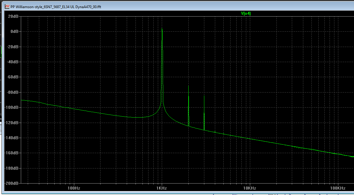

With no gNFB, just the local NFB from EL34 plate to 5687 cathode, it says 1W out into 4 ohms with 0.027%. THD. It looks like it makes 20 clean watts.
The gNFB appears to reduce gain and distortion by about 5dB. THD at 1W out becomes 0.016% THD.
2HD is a little higher in level than 3HD, in both the above cases. That should be a good thing, no?
I've included the .asc file for anyone who wants to play with it.

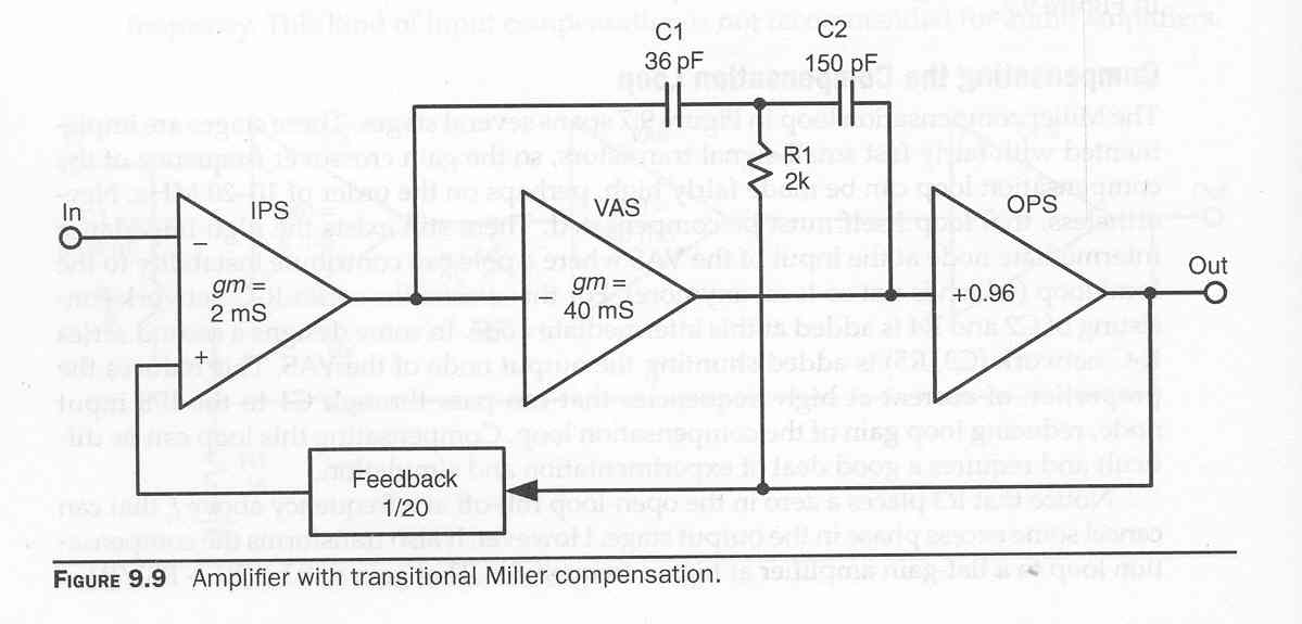

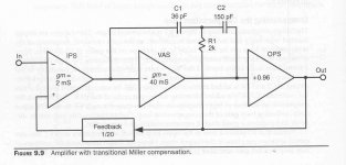

Below is a diagram of TMC from Bob Cordell's excellent book "Designing Audio Power Amplifiers" (SS) page 182. Hope that's OK, I highly recommend his book.
The TMC feedback in the diagram goes from OPS OUT through R1 and C1 at lower freq., and then from the VAS output through C2 and C1 at higher freq. Both going back to the VAS input.
So I was thinking of some kind of adaptation of that, where the global feedback would use the OT output up to the top of the audio band, then switch to plate output above that freq. range to avoid the OT phase issues. Seems that may have been what Hafler was up to also. Basically switching the global loop to a "local" (no OT) loop at a chosen freq.

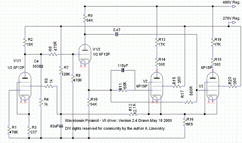

I prefer 1-stage inner loop, because it sounds less nasty on overdrive by peaks than 2 stage inner loop ("Clinical" term means harsh overdrive, not low just distortions, actually) ;-)
240K go to anodes of 6P15P from anodes of GU-50 tubes; GNFB goes to cathode of the 1'St pentode.
Hmm, I only see an idle current stabilization feedback to the 1st screen grid there. Am I missing something, like some output Schade resistors?

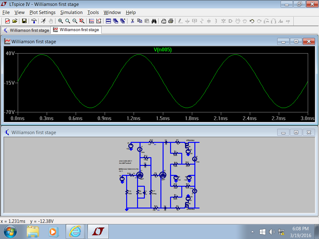

I agree that simple is better. I've been playing around with ideas generated from SY's Impasse preamp. It works well with what I've been thinking about. How to make the amp simpler with just 1 voltage gain stage. Here's something I simmed that hasn't been built:
After much fussing I was able to get the linearity of the output pretty good right up to the 2V rms output of a standard signal source. It shows on the FFT at that level. I wasn't able to get the maximum theoretical mu of the voltage gain stage (20)even with an active load. An mu of 18 was all I was able to get. I just used a generic constant current symbol in LTspice. Maybe I was doing something wrong.
The point is that the output that would be going to the grids of the output tubes is pretty pristine. That isn't an aberration where the harmonics disappear obove the 5th harmonic. With lower input signal levels even the 4th and 5th harmonics disappear. I'm not sure what those harmonics are at 100khz and above but I'm pretty sure they either don't exist or could be handled easily.
The point is that it simulates an output of a very clean 99 volts peak to peak for a standard 2v rms input signal. It seems to me that's a signal level one could do a lot with standard tubes. For example a 6l6 in ab mode is biased at -37 volts, EL34 is 39 volts. You definitely don't have a lot of extra for feedback. But if you could get the MU of the gain up to the theoretic limit of 20 then you'd have a voltage P-P on the output of 113 volts. You could definitely work with that. Why put in an extra stage only to have to futz with it? Also, (not a minor point), The less stages of amplification the less distortion generated which you then have to try to reduce.

It's a pretty small schematic I posted so I'll reiterate some details. It doesn't hue completely to SY's preamp. It uses 450 volts (the max for a 6sn7) not 350 volts. I also used 6SN7 for both gain and split load. You need the 450 volts for good linearity at maximum output. I used SY's idea of capacitively coupling between stages because it allows more optimization ability. I also noticed that the linearity got better as I biased the voltage gain stage to around 7 volts. I didn't expect that and I'm not sure why that is, but there it is. It allows for greater headroom on signal input peaks but you take a hit on power dissipation. You might have to go to a 6SN7 GTA or GTB to have a margin of safety in power dissipation.
