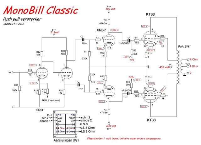

A recent Williamson amp using the Russian 6N6.
I have found you may need to change the value of the cathode resistor on the Voltage amp to get the Phase splitter correct.
Phil
Please specify which is the value of R18 or the correct bias for this schematic.

Hi M
I found about 600 ohms with the 6n6 i have, but depends on the tube you could fit a 1k pot.
i have found with just about any tube 12BH7 and more, an adjustable pot is best if you want the phase splitter to work correctly.
sorry: When i scanned the circuit for this amp i put the wrong power supply.
Phil

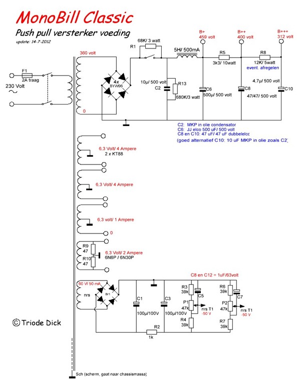

ANYbody ever build the "Mono Bill" classic? Is there a wesite for the amp? It looks like an old Heathkit schematic. Consider using Edcor or Hammond transformers that are easy to obtain.This is a great project...or at least could be if the pro's help out....

What would be a good approach to a 'best possible' power supply for an amplifier like that. When I want good PSRR that typically involves active components - dare I say semiconductors. What do you suggest to keep with the spirit of the valve amp?
Something else that probably needs improving is that the HV kicks in before the valves have time to heat up. Other than using valve rectifiers (with the associated problems), are delay circuits used or is that again against the grain of things? Guitar amps just use a standby switch but that is not common in audio amps...
