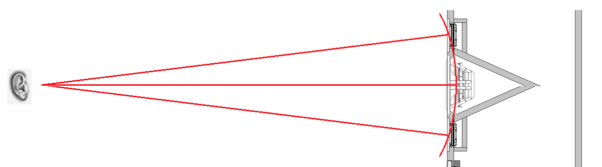

It's easier to joke separate internal enclosure fir the mid.What is the benefit of having the MT upside down?
I'd prefer the conventional arrangement where the mid is next to the woofer from an acoustic perspective.
Close has to be considered relative to the crossover frequency.
dave
