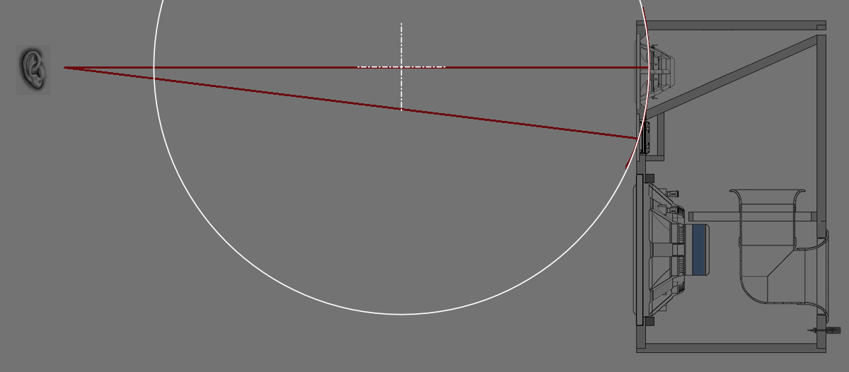

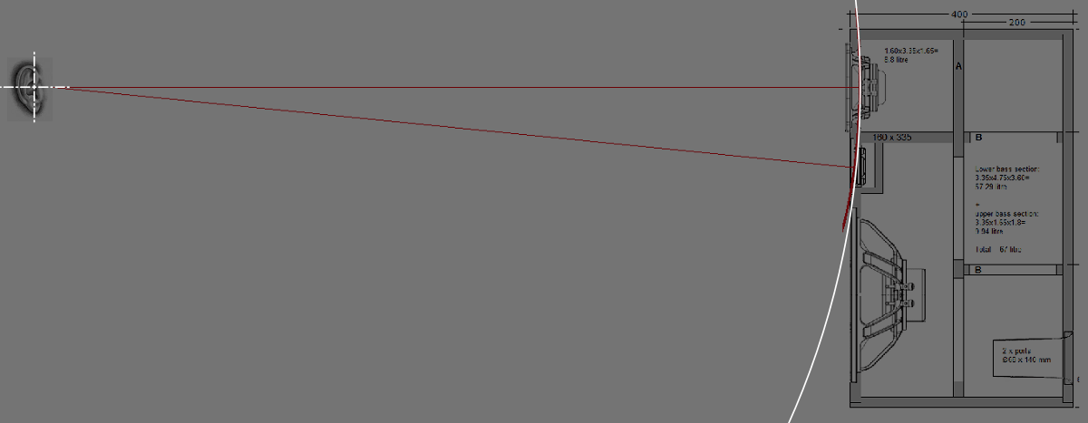

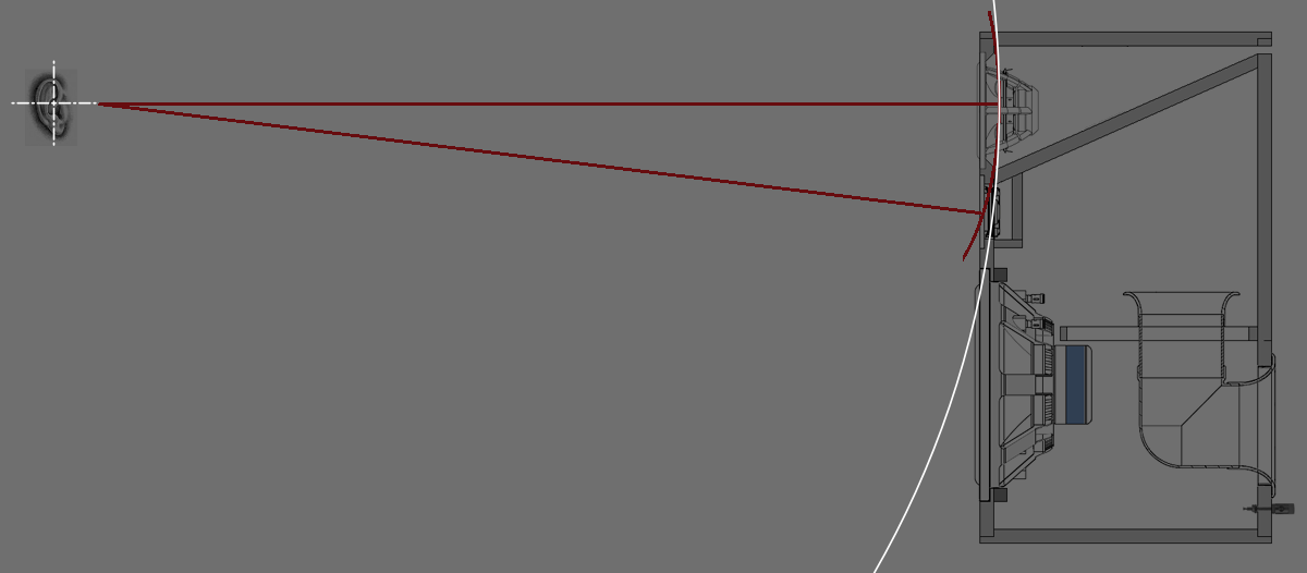

As I am still in stand-by mode (quite dangerous, it enhances the lust for crazy construction details ) re: my troels 3-wc build.
When I was compairing the "original Faital-3WC to the fusion 22, I noticed that he, well, actually cheated a bit on the illustration of the time-align. This seems very very obvious on the fusion-22 page.
Took the images and just drawed a circle from the ear to the mid. See yourself.
As these drivers at least geometrically aren't really aligned, what is to think about this time-align-stuff. Hocuspocus?

Often the voice coils are used as reference to determine the offset (true offset can shift somewhat with frequency) and in that case both samples seem to align pretty good in these drawings using this particular distance. (judging by your white circles) Did you check the right ear too?
Hm. My left ear told me that in the case of the fusion-22 example, the distances of the voice coils align at approx half the illustrated distance... (right ear didn't looked at the problem)
Makes me wonder wether this has to be looked at in the "geometric way" at all? (as the speed of sound is the same across the frequency-range, ~0.01 seconds for ~3.5 m, (or 0.000029 seconds for 10 mm), but then there's the wave-lengths coming into play, I know I know and almost, like, "understand")
No, it can be measured and accounted for in the crossover without considering the geometry, and without knowing the distance.. and from the point of view of the listening axis that would be sufficient.wether this has to be looked at in the "geometric way" at all?
It is, but phase changes with frequency so the effective distance does as well.(as the speed of sound is the same across the frequency-range,
Given that the driver “source” point moves with frequency and cannot be reliably be shown by the geometry of the drivers on the baffle. The XO will also move the driver in time.
So your analysis is ont first order and tells us only a very little.
