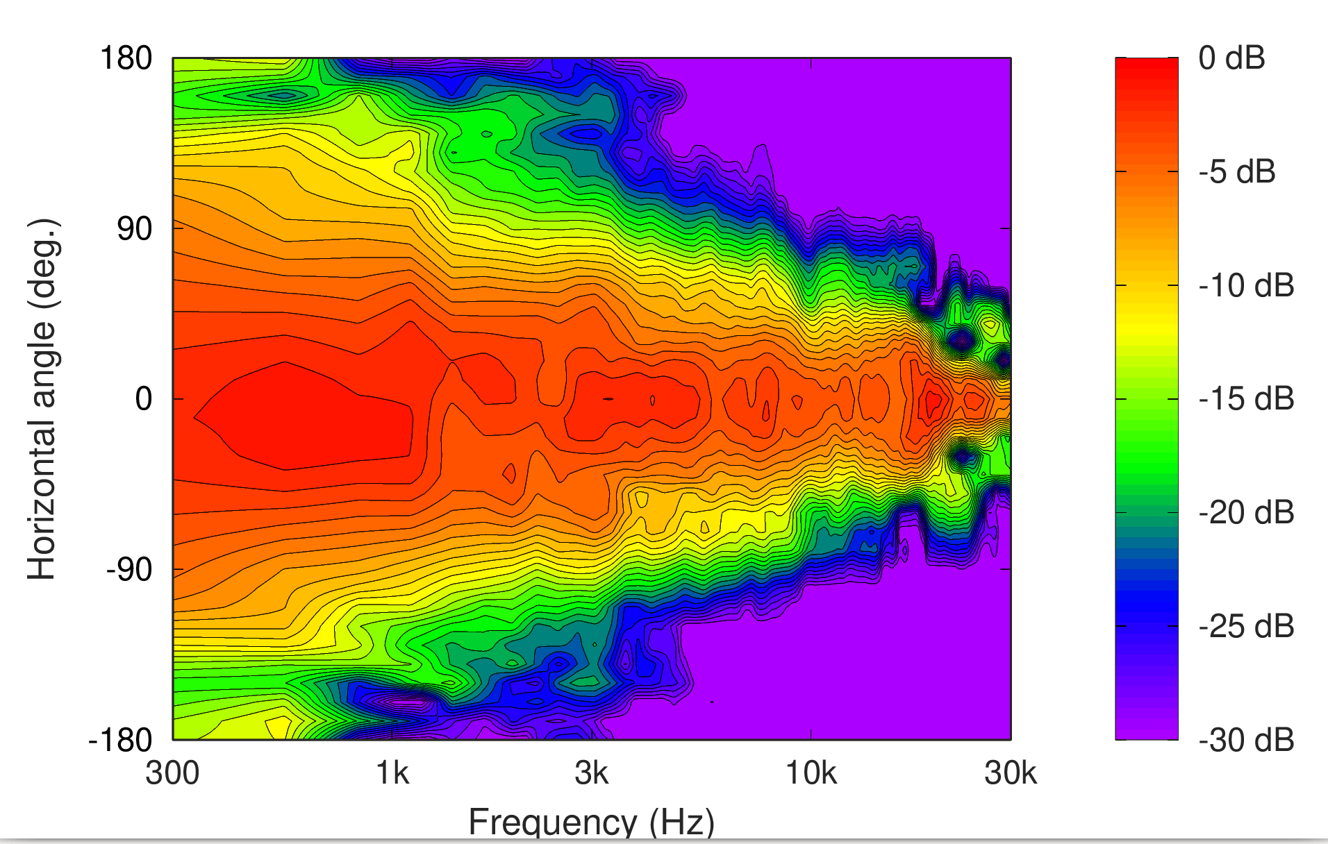

There is only so much that can be done to affect the inherent directivity of the drivers through the crossover region. A tweeter with a large dished face plate crossing to a 5" driver is a reasonable match for a non waveguided or faceted baffle design. The tweeter does not have much low end so it will be crossed higher than an ideal directivity match would dictate. A hole in the power response is not necessarily a bad thing, certainly much better than a peak. The potential hole from drivers of this size being crossed together is not hugely concerning.Without knowing the crossover point I don't even have an idea of the directivity. With his usual too high point of crossover between mid and tweeter, there could easily be a hole in the power response, and you won't know it until built.

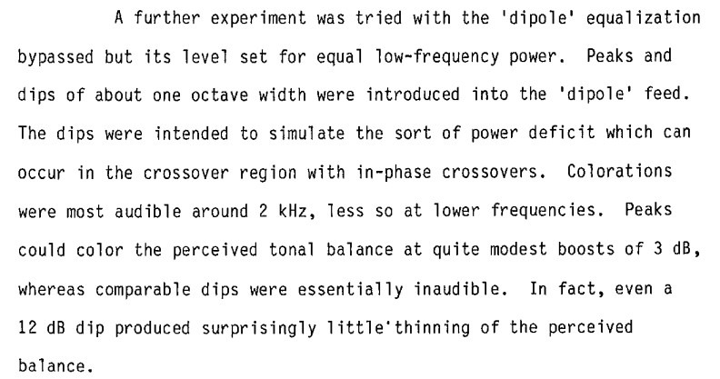

Have a read of an old Lipshitz and Vanderkooy study
https://www.aes.org/e-lib/browse.cfm?elib=11454
I am not trying to argue against your position only to point out a design that I think has the least potential for the problems you point out. Given that the OP has stated he intends to build a Troels design why not pick the lesser of the evils?
You are preaching to the convertedSee here what I mean for data:
Why dont you conduct your study and have your data to disprove his??? I find it funny how a person put in a ton of work and have several data to show but still got discredited by someone who make the opposite claim without any data to back it up (just adding the key word “could be” and then you can add whatever bs you want haha). I dont mean to attack you but I hope you see the paradox in your own post.About the stepped baffle study, it is flawed because it contains (again) only on-axis FR. Going off-axis vertically can be a real mess.
What do you mean with bad off axis response? Without knowing the crossover point I don't even have an idea of the directivity. With his usual too high point of crossover between mid and tweeter, there could easily be a hole in the power response, and you won't know it until built. See here what I mean for data: https://heissmann-acoustics.de/en/dxt-mon-rly/

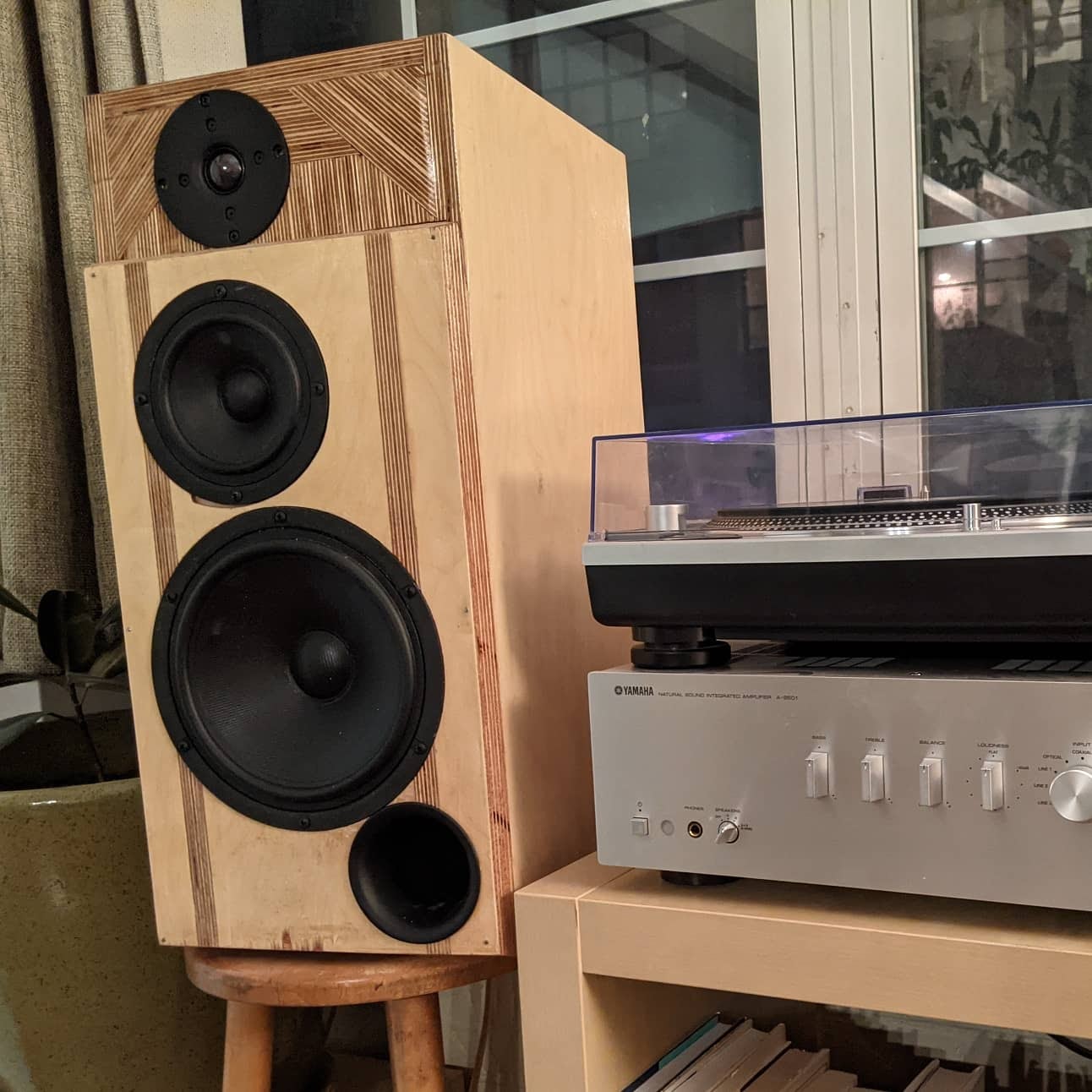

Dan, to your OP, I just completed Troel's Faital 3WC and have the parts to build the Ekta mk2 which I'll be starting soon.
Unlike you, I lack woodworking ability and that cost me be quite a bit. I initially had a local shop make a CNC flat-pak for the Faital, but it was simply not cut properly and the cabinet was not satisfactory to me. Even though this is DIY, I want the aesthetic appeal of a retail product and so had the cabinets professionally made.
For both the Ekta and Faital, I chose the "Level 2" cheaper option, since I too don't think the more expensive caps would make an audible difference and the "standard" ones are likely more than enough. In addition, I've found that the prices from Janzten are very good (atleast when I bought the kits 1-2 years ago), and significantly cheaper than buying from Madisound, Parts Express or any other shop that sells Janzten caps and the related drivers. The ScanSpeak drivers were almost half the price from Janzten than what they retail for in the US.
I will be starting the Ekta mk2 soon. I chose it because I was interested to hear a design with ScanSpeak Illuminator drivers, and a retail speaker that uses those drivers would cost atleast 3x the cost.
For the cost of either the Faital or Ekta, I would be able to purchase a second hand ProAc, Focal or Kef floorstander. I believe the DIY build is far superior in the cabinet, with regards to damping, bracing and material. I've owned a few of those in the past and I think the value for money is very low. The ProAc Tablette, for example, was made out of MDF, with both drivers costing less than 100$, and about $20 in parts in the crossover, with a retail price tag of $2k.

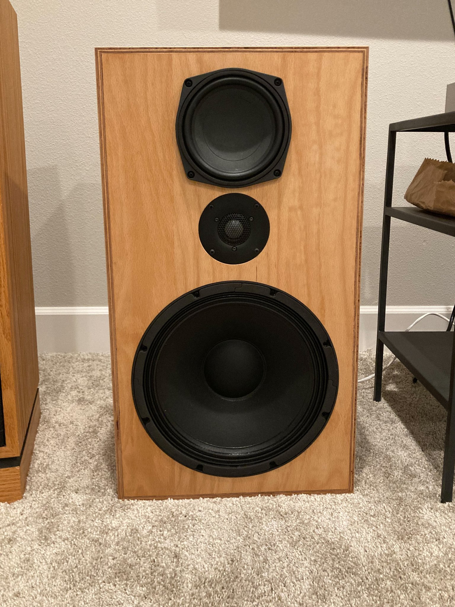

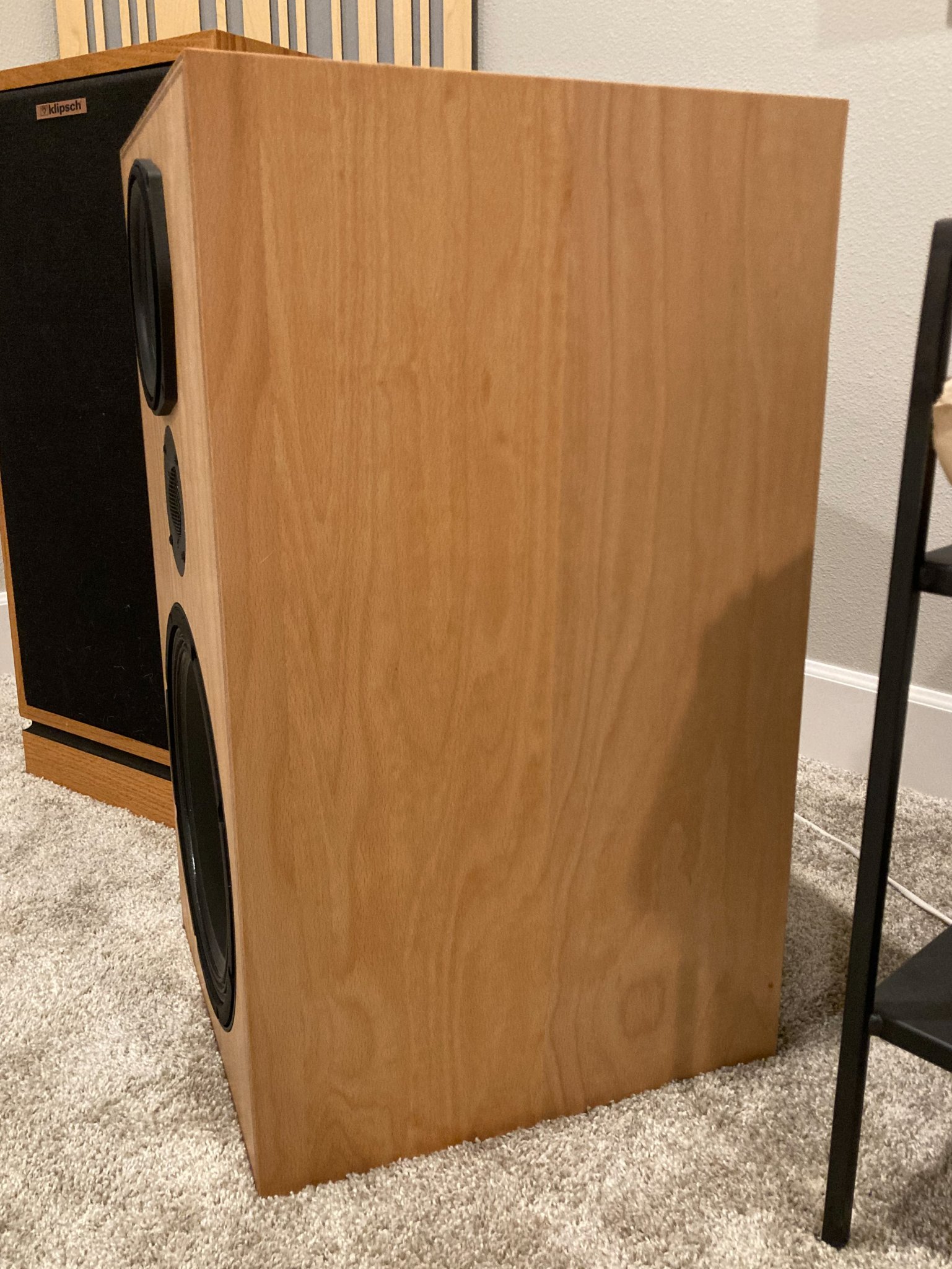

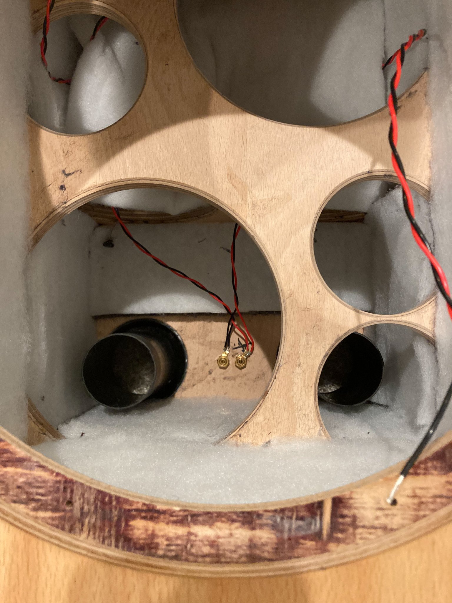

I may be a little late to this forum, but figured I'd leave my experience here.
I built his ScanSpeak Discovery-3Way MkII. I had about $1000 to spend, and was also deciding between DIY and buying a used pair of good speakers. I have very little woodworking experience, but they came out great -- sound aside, they are a fun conversation piece, and it's so much more satisfying to build something than to find it on craigslist.
Not ever having a pair of high end speakers before, I really wish I could put them side by side with a pair of really good speakers to see if they are truly better. My one piece of comparison: I put them side to side with Klipsch RB-5 Speakers, which were an $800 pair back in 1999, and Troel's design blew them out of the water. They sound WAY better. I may be comparing apples and oranges, but that subjective opinion is my one comparison.

I'm a DIYer at heart and an accomplished woodworker so I've decide that sometime in the near future I'm going to build one of Troels designs.
As far as I know now I'm going to start with the http://www.troelsgravesen.dk/CNO-25-mkII.htm
Dan
