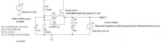

So the conclusion is that there should be some delay and also it is preferable to gradually apply B+. Correct?
So the practical question would be - how would you suggest to accomplish it in a case of SS rectifier? Can you point me to a good (preferably simple) solution that would gradually apply B+ and that could be constructed without thermionic valve components?

No, the conclusion is that cathodes should not be hot while there is no anode current (for long periods), and that B+ should not be left running while cathodes are cold (for long periods). In other word, just turn the thing on or off like normal.
A soft start will reduce stress on rectifier/fuses/capacitors etc, but there is no evidence to suggest receiving tubes benefit from a time delay before application of B+.
Unless your valves are very easy/cheap to replace, then I think that B+ delay with slow rise time is worth the trouble.
A slow rise Damper diode like 6D22S, PY500, 6CJ3 etc is really the best. But if you don't want to use them, you could adapt the standard FET passive regulator. With 220K and 100uF at the gate position, you could get a very slow start.
Or, you could use a smaller capacitor and a small (mains-rated) switch from the FET gate to ground. With the switch closed, the B+ does not appear.
This circuit can power preamps directly, and will reduce ripple and noise very effectively, as well as give slow rise time.
With power amps, the circuit would need a very large FET to supply the anode current. But in many cases there is no need to interrupt the anode supply.
If your power amp uses pentodes, simply apply B+ to the anodes at any time, but delay the screen voltage VG2 using the circuit above. With zero volts on VG2, you are protected from any cathode stripping OR van de Weijer effect, because the electric field at the cathode will be effectively zero.
With fixed-bias amps, you can use a negative-voltage startup FET circuit that applies a very large negative bias while the heaters/filaments warm up. Again, the aim is to reduce the electric field at the cathode while it warms up.
With auto-bias, and triodes, you have to delay and ramp the anode supply. You could use a large FET, but I think that a damper, even if only a single diode in the dc supply line, is the best solution.

A simple two-stage circuit that applies B+ through a suitable resistor followed by simply shorting the resistor with a switch or relay.
Even when I use slow tube rectifiers like damper diodes I still use a delayed slow start arrangement. Damper diodes are tough, but they will cathode strip just like any other tube. While cheap, they aren't free, and as they degrade your PS will get soggier due to the reduced cathode emission. I like tube rectifiers in SE amps mainly because they are completely noiseless. I will probably try SiC Schottky's in my next PP project though...
