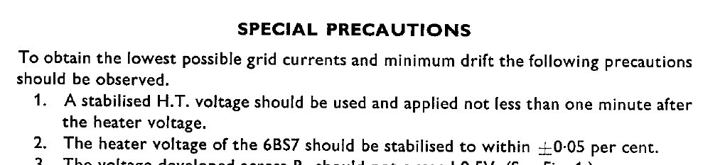

Firstly, we have to identify the mechanisms.
1. The cathode stripping effect found in Transmitting valves, operating at high (1kV+) voltages is well-known, and should be accounted for in kV-level designs. This is a kind of brute-force ripping of cathode particles from the emissive surface, before the heater can start the proper thermionic action. With receiving tubes, operating at much less than 1kV, cathode stripping has not been confirmed, so far as I know.
2. However, there remain multiple instances where professional equipment designers are explicitly instructed to preheat the valve before applying the anode voltage.
Start with Electrometer valves. The attached picture is a grab from the STC 6BS7 data sheet. This is a low-noise audio pentode, which serves as a fine upgrade for the EF86. Its high quality allows it to be used for electrometer duty - where ultra low grid currents are required. Now why could electrometer duty possibly require a 1-minute (minimum) preheat before applying anode voltage? We will see.

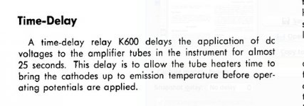

Next up, professional instrumentation. It doesn't get more professional than Tektronix, so let's look at the 551 tube-based oscilloscope. The snip is from the 551 manual, where you can see explicitly stated that B+ is delayed, to allow that tubes to warm up before anode voltage is applied. Given that the 551 is designed for accurate MEASUREMENT, avoidance of excess grid currents are the first consideration for the TEK amplifiers.
The explanation.
The most credible explanantion for problems with excess grid currents, caused by cold application of anode voltage was
published by J.H. van de Weijer, a cathode designer at N.V. Philips CRT division in Eindhoven. I have been told by Frank
(fdegrove here on DIYA) that this text first appeared in the Dutch Audio Magazine "Geluid en Techniek" in the 1990s, when van
de Weijer retired.
Although he refers to cathode-stripping, please remember that this is not the same as Transmitter (brute-force) cathode
stripping. Here is the full note :
