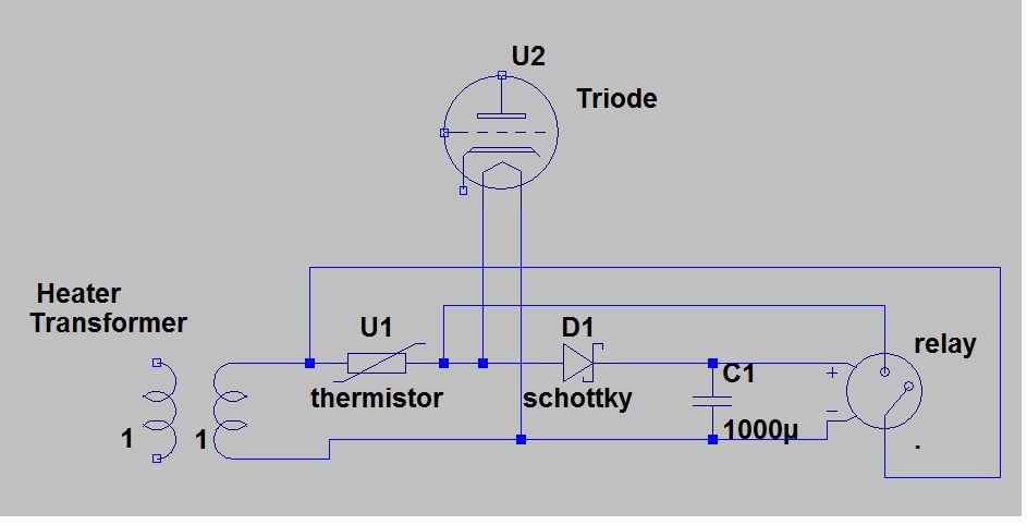

Not in my case because you need the voltage over the thermistor to decrease and the heater voltage to increase, or it wont work. Heres a schem:
Edit: Note that when rectifying 6.3volts AC you can get about 9V DC, so a small resistance or perhaps a LED might go in series with the relay. Most relays handle quite large variations in coil voltage and I havent had any problems so far. If I remember correctly the relays I use have 5volt coils, but I cant remember if I have anything in series. Man my memory stinks...must be all the solder fumes🙂

then why short out the NTC? they are meant to stay in-circuit, when heated up they are very very low resistance anyway...
Yes ! NTC has very no resistance. It seem to be no need to use a relay to short it. Why I short it ? Due to has a Self recover fuse series with it. This self recover fuse use only at startup tube testing procedure to avoid ultra high current burn parts at startup. Power tubes can protect by u_Controller but have a very short time gap can not protect.
Also, even tho they have relatively low resistance when hot, they still drop almost a volt, so I end up with just a slightly low heater voltage. (I've tried several different types and they all seem to drop 0.7-1volt when passing anything from some to max current).

I use a very simple combination with NTC thermistor and a relay. No active components at all. The raw heater AC goes thru the thermistor to the heaters. The single rectifier diode goes to a capacitor and the relay coil. On turn-on the heaters are cold and low resistance while the thermistor has high resistance limiting the current. As the heaters warm up (and the thermistor) the resistances change and the voltage over the heater and thus relay coil increase. When the relay coil get about 5volts it switches on and shorts out the thermistor. Works great and very few parts😉

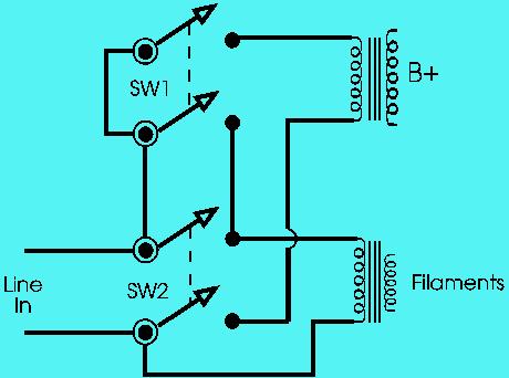

Although relay automation would be convenient I’m going simple as can with two switches, i.e. for fillament and B+, as needed to comply with the datasheet requirement to pre-heat a rectifier for use at high voltage for my 845. Found a neat circuit which guarantees heaters go first whichever switch gets flipped first.
