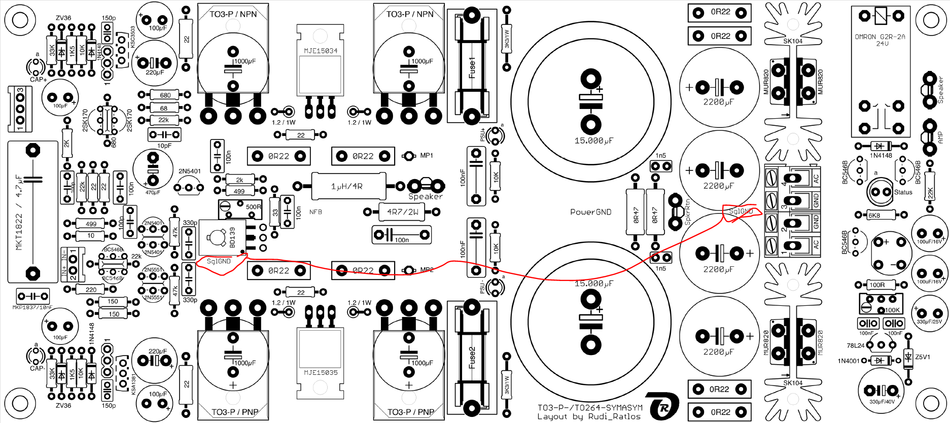

I completed soldering the first pcb and have found my first deadend - I am trying to adjust quiescent current, but am reading 0mv regardless of trim poti settings.
I have:
* correct input voltage (measured) and correct direct current out of PSU (measured)
* shorted input
* nothing attached to output
* everything remains cool, no smoke as well 😉
* measuring DC mV between MP1 and MP2
* there is 0mV, I can turn the trim from stop to stop and it will not change
Anything obvious I am doing wrong? Would it make sense to attach a speaker and source to check if the amp is doing anything or could this damage anything?

Oh... Rudi, thanks for the quick answer, indeed I read the manual about 100 times and failed to do just this.
The manual lists another board revision here, are the locations in the marked pcb correct? For simplicity I would prefer to solder them on component side, I'd rather not split the transistors from the heat sink again...
This was it rudi!
I was able to adjust quiescent current perfectly now, also DC offset is about 6mV.
I then plugged in a source and speaker and was greeted with terrible 50hz hum. A quick depression and I remembered that one of the input cables lying around was defective and I managed of course to grab just this cable...
Replaced by another cable and 😱 - It works!
Now on to finish the second pcb..
Thank you all for your help so far, this has been a very exciting build for me as a soldering-newb.

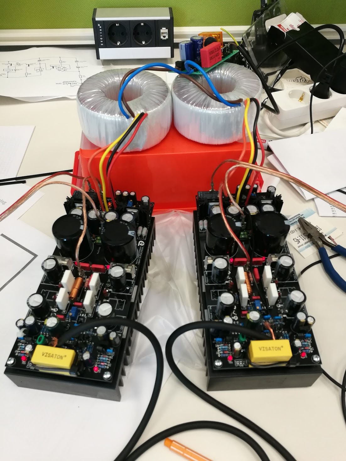

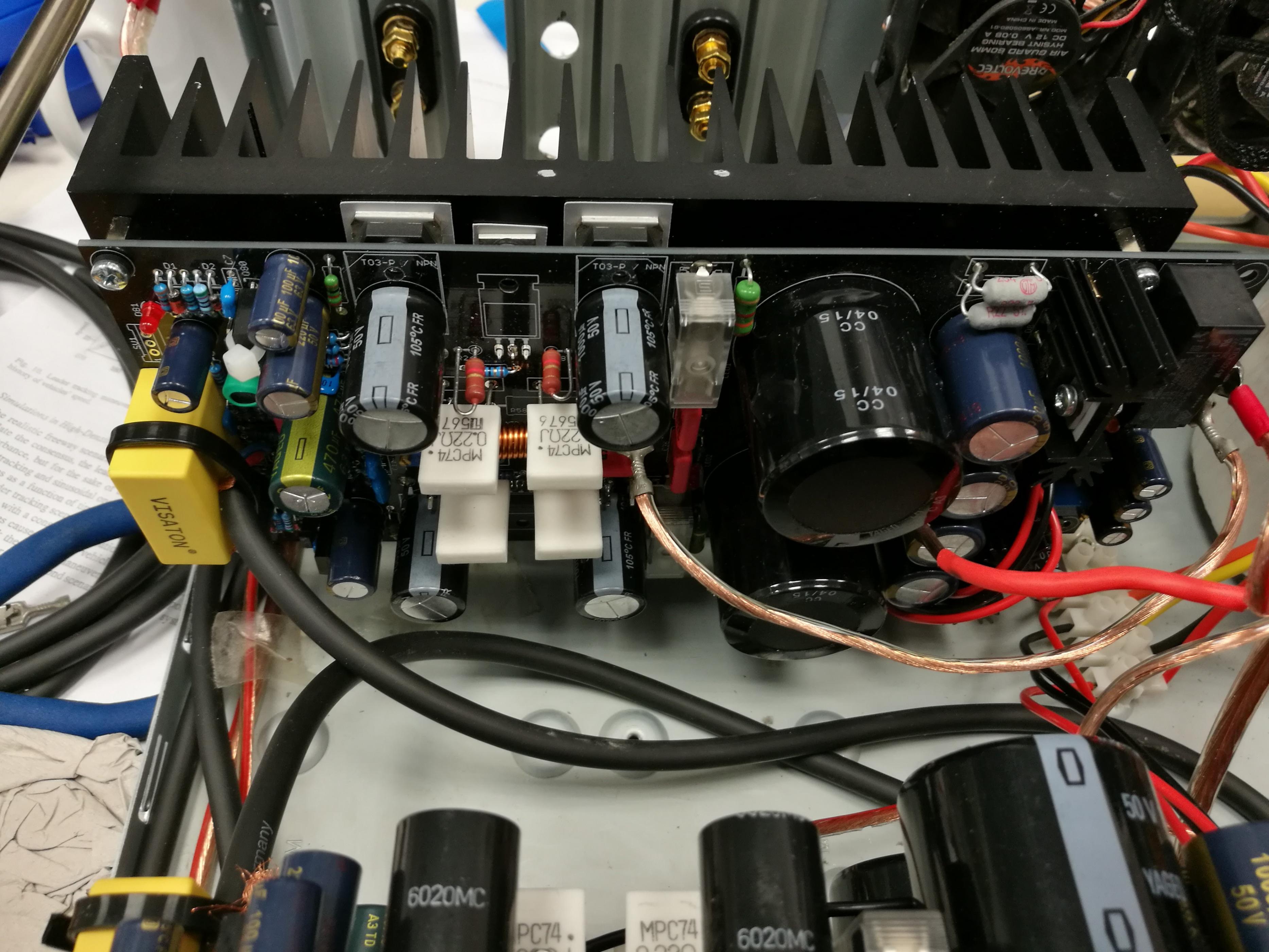

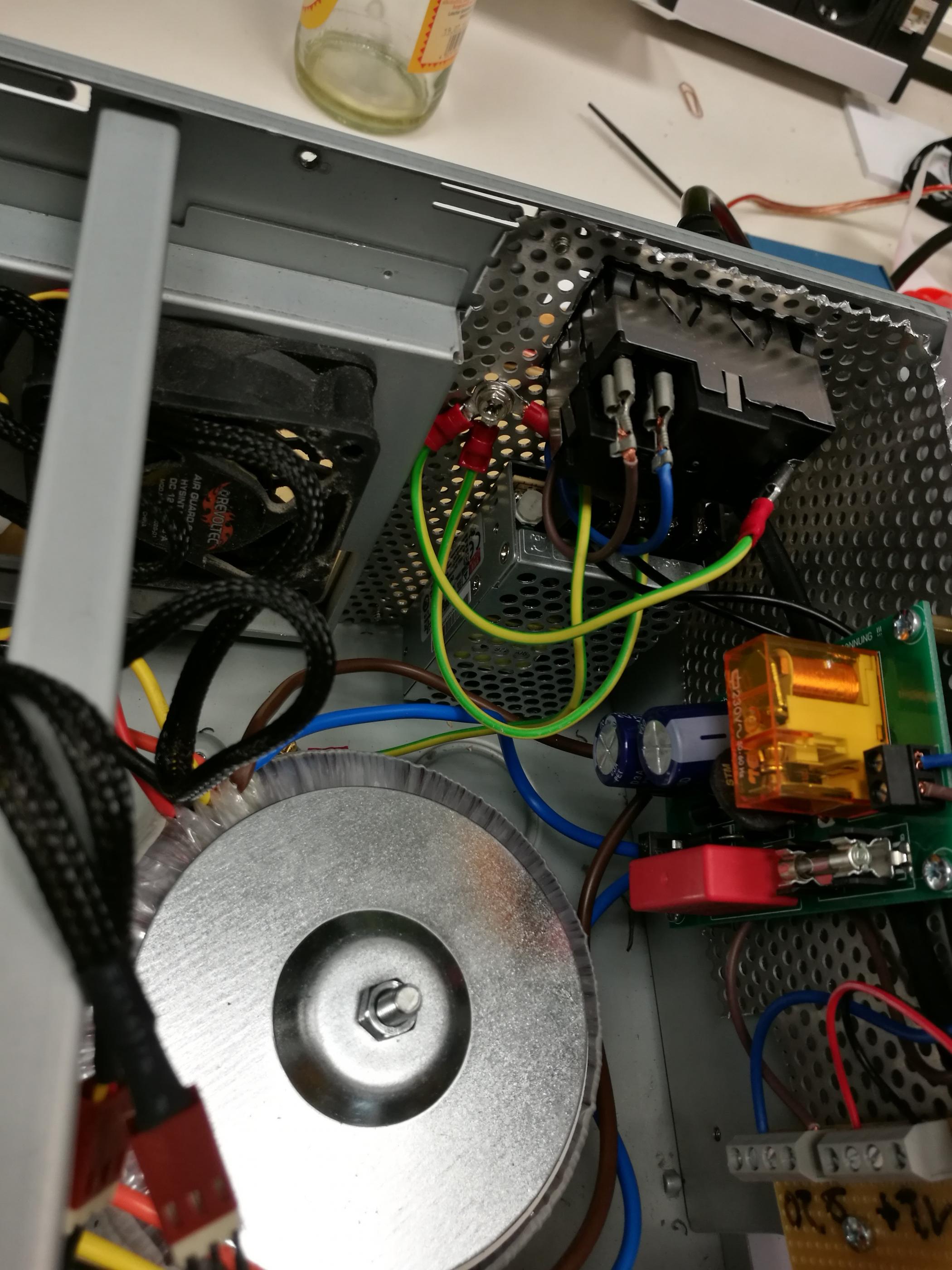

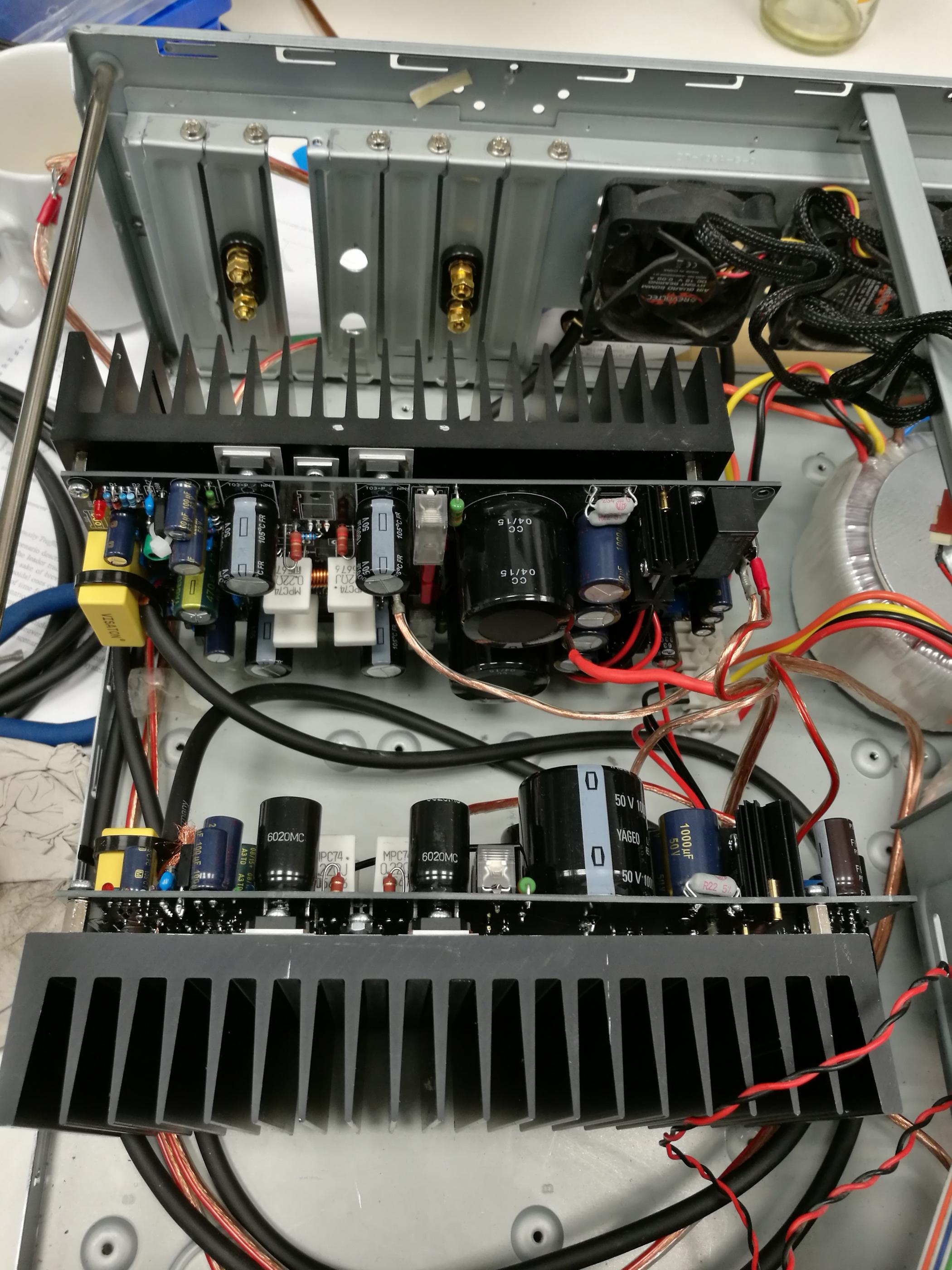

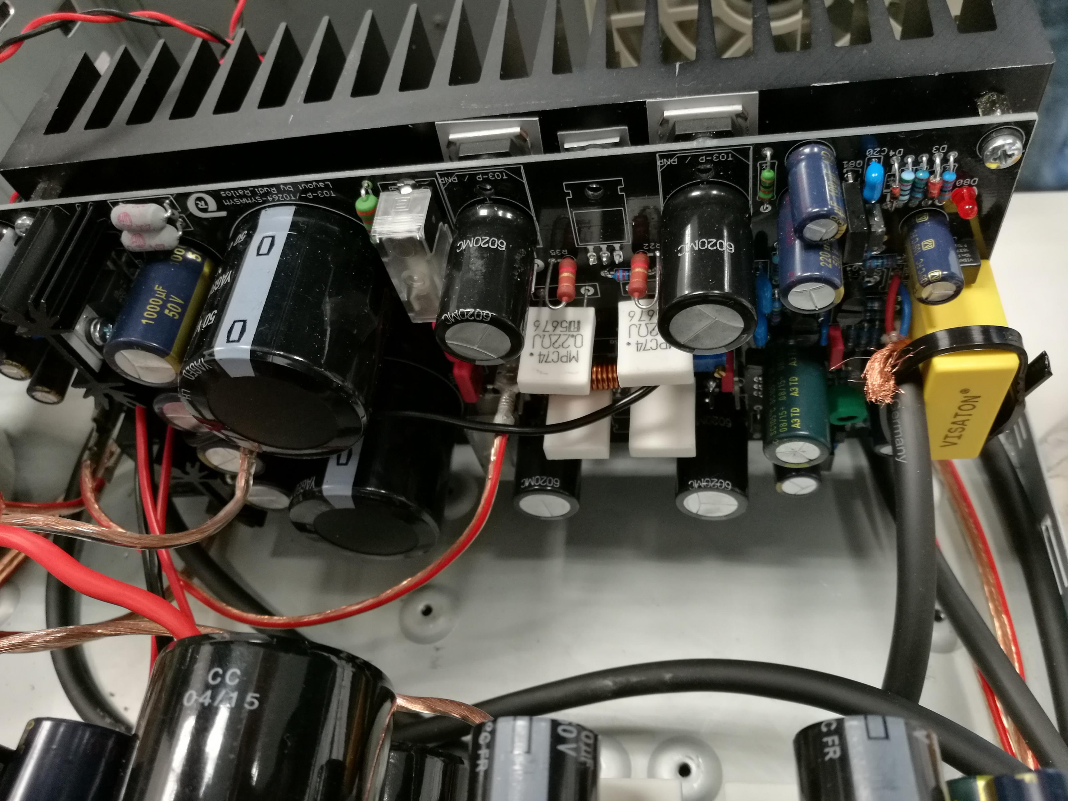

Hi Guys,
as promised some pictures of the build. Could be neater, I know 😉
The basic setup is quite easy. Power in goes into a soft power-on by diy-audio. From there to the two transformers and then into the symasym power section.
Input is directly soldered onto the pcb, output goes through the speaker protection on the black beauty.
Too much work today, I will disassemble and inspect tomorrow. Maybe an input wire has come loose or the ground-cable on the pcbs? I hope nothing is really damaged...

One thing I noticed further:
All four leds are on as soon as I plug in power. As soon as I unplug them, the two LEDs on the left PCBs side stay on, while the right side LEDs go out immediately. Could this be an indication for a short on the right pcb side?
Hi guys,
sorry for the message spam, but I can't edit my posts after some time.
I did some more measurements today with help of a colleague. I was mistaken with my DC output measurement (was measuring after speaker protection...).
My amp has -23VDC on the speaker output, measured against GND! 😱
Our current idea is, that one of the transistors is defective, what do you think?

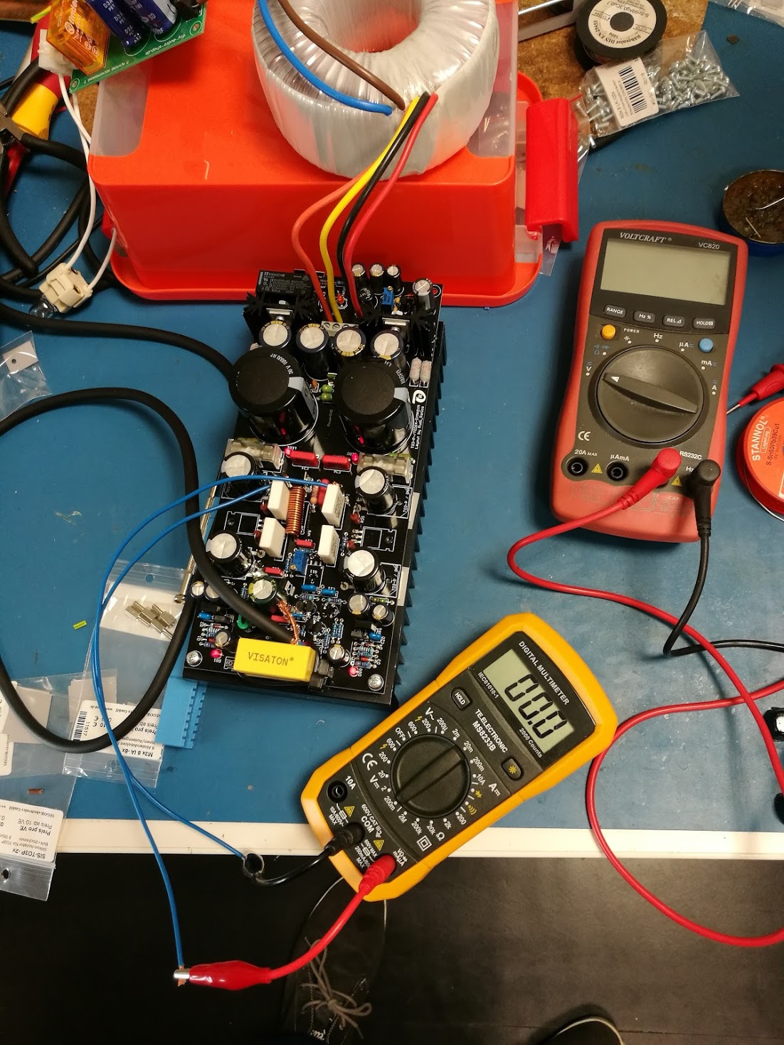

Hi everyone,
my work kept me too busy these past weeks, I finally found time to do some measurements yesterday.
Setup was with bridged input and a 4ohm high-load resistance on the output (didn't want to burn my speaker). All measurements were taken in DC against Ground.
Do these values make any sense to you? My initial guess is, that Q1 or Q2 is defective, since there is dc voltage already present in the input path? I'm no electrical engineer though.
All help is highly appreciated!
