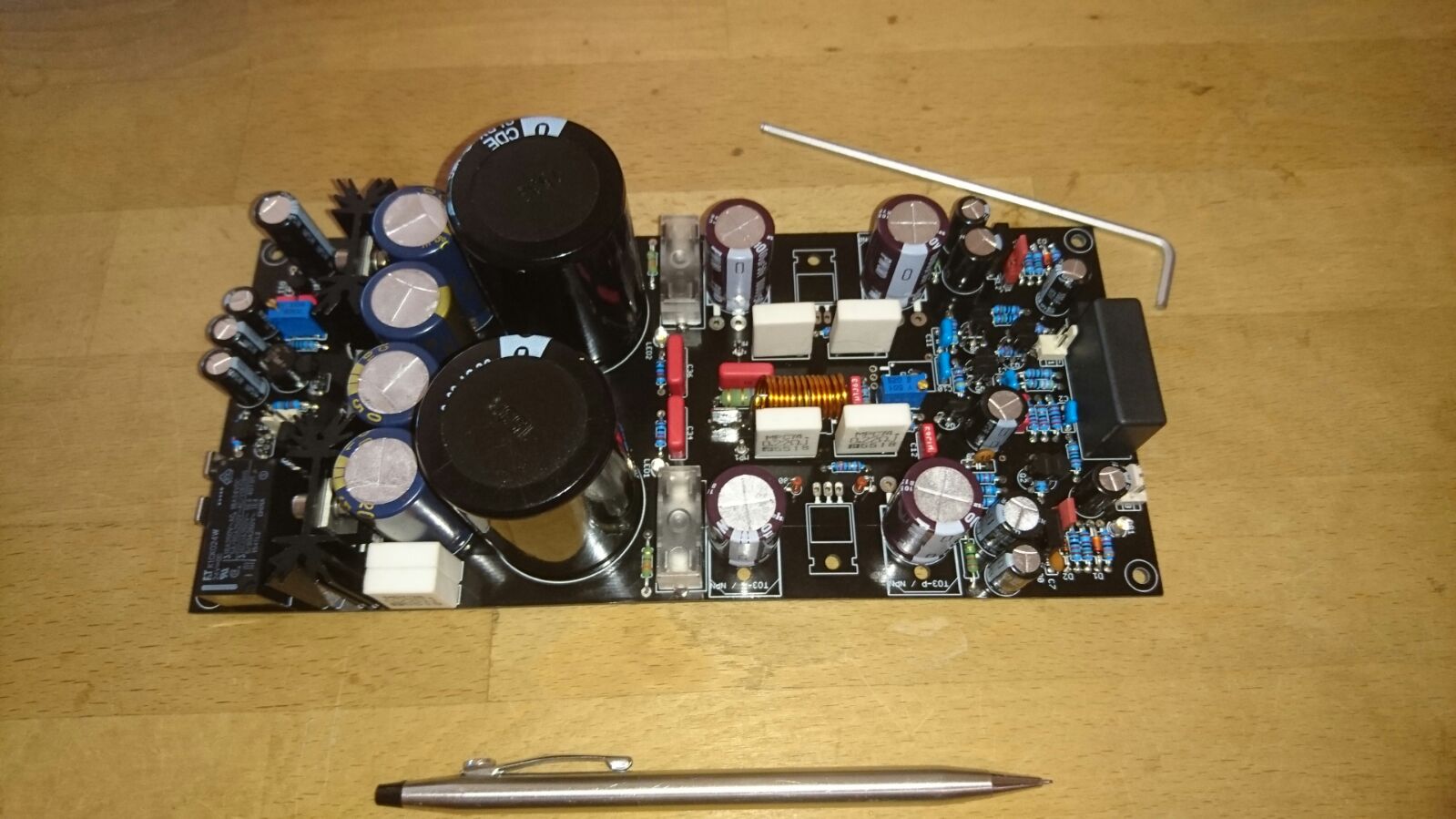

Hi folks,
I'm about to build some Symasym´s using the black PCB´s layouted by Rudi. Now I need to place some orders and for this I need to know which wire size is recommended for the coil around the resistor. Is it 1.0mm or 0.6mm? How much windings?
I'll use MJL1302A / MJL3182A / MJE15030 / MJE15031 and 2SK170 if this is relevant.
What´s about the condensers C10 and C11? Can they be replaced with some ceramic types?
Thanks for your support!
Markus
Hi folks,
today I finished the first amp as far as I could. Now I've to wait for the heat sinks and transformers. Next step then is to mount the transistors to the heatsink. For this I made a pdf showing the pcb with hole pattern.
The coil is made from 1.0mm enameled copper wire, 12 windings and a 3.9 Ohm resistor (2 watts).
I already soldered the speaker protection except the rectifier and zener diode, so there will be no power to the speaker protection during testing and adjusting.
End caps are already done, it should be no problem to solder the transistors afterwards.

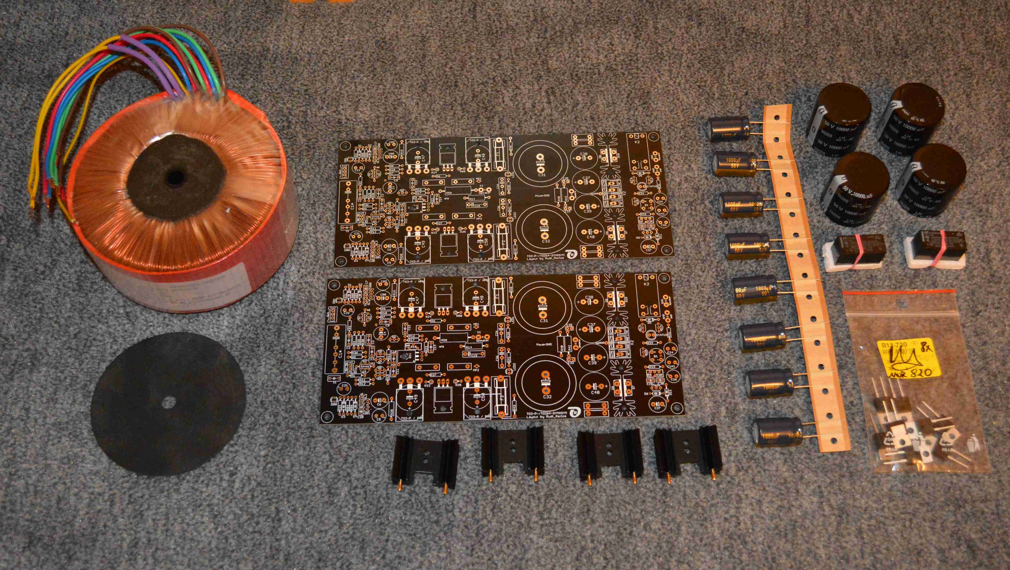

2 PCBs, Transformer and several parts to sell
Hello,
due to lack of time I would like to sell the follwing items:
2 PCB Sysmasym (Blackbeauty) by Rudi_Ratlos
1 Transformer 230V / 4 x 25V/400VA (from Badel)
4 Heatsink V PR32/25,4
4 Cap 10.000uF/50V
2 Relais FTR K1CK024W
8 MUR 820 Ultrafast Diode
8 Cap 1000uF/50V
All parts are new and unused - see picture. Price for all items would be 110EUR plus shipping costs (from Germany).
If someone is interested in buying these items, please send me a PM.
