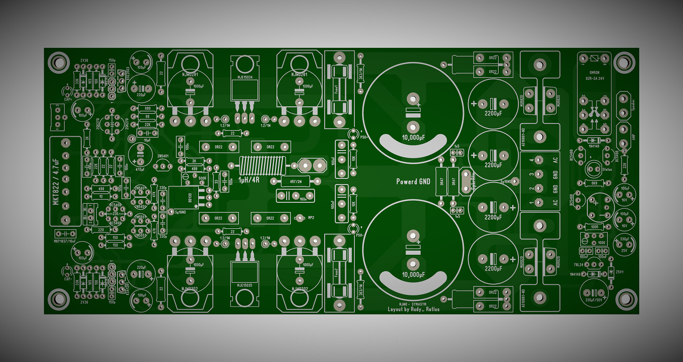

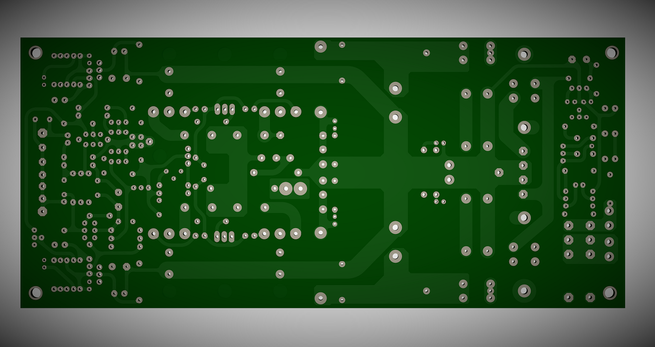

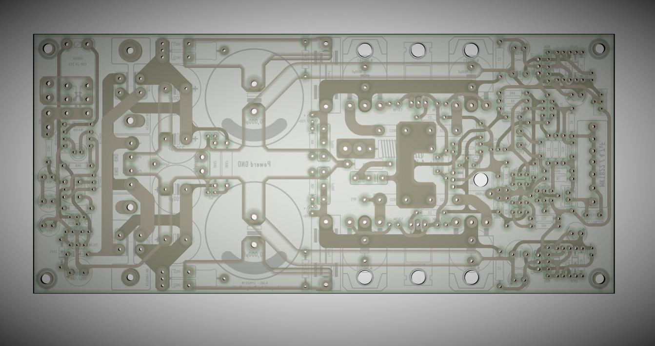

Hello Rudi this is the art work I like the PCB so much that I have to try to make it art work images maybe is not 100% accurate my re-drawing but does look good and I like it a lot 🙂
Best Regards
Juan

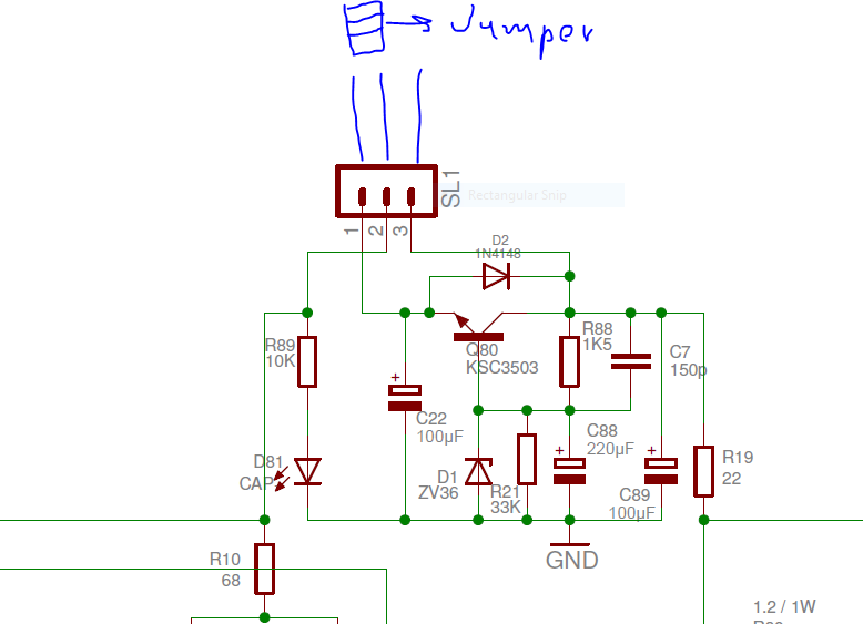

Juan, when a cap is put upon jumper pin2 and pin3, the backend rail-voltage is used as the frontend-voltage.
When the cap is put upon jumper pin2 and pin1, the output voltage of the cap-multiplier ("cap-regulator") is used for the frontend.
Best regards - Rudi
oh ok now I got it Rudi thanks 🙂

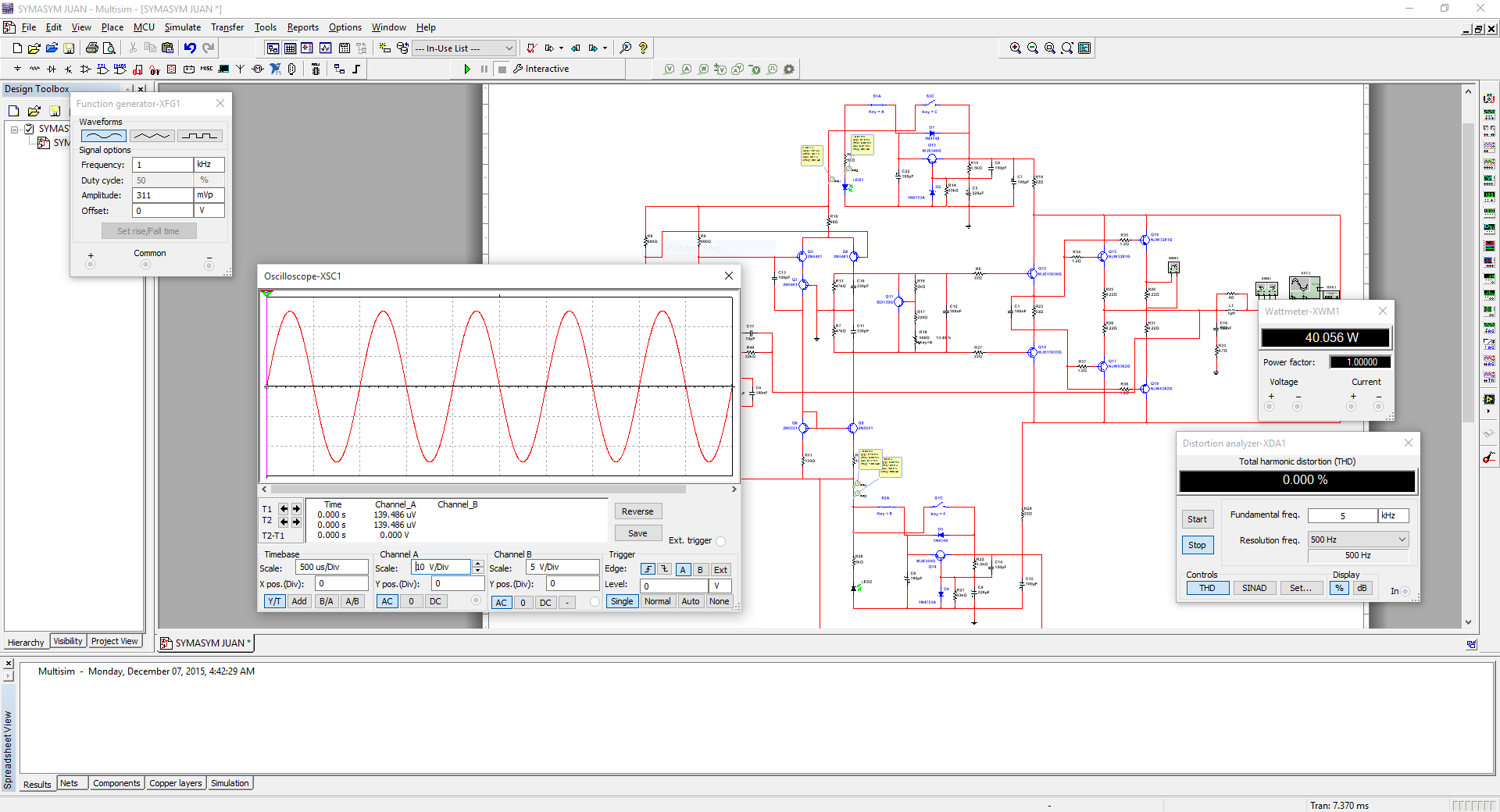

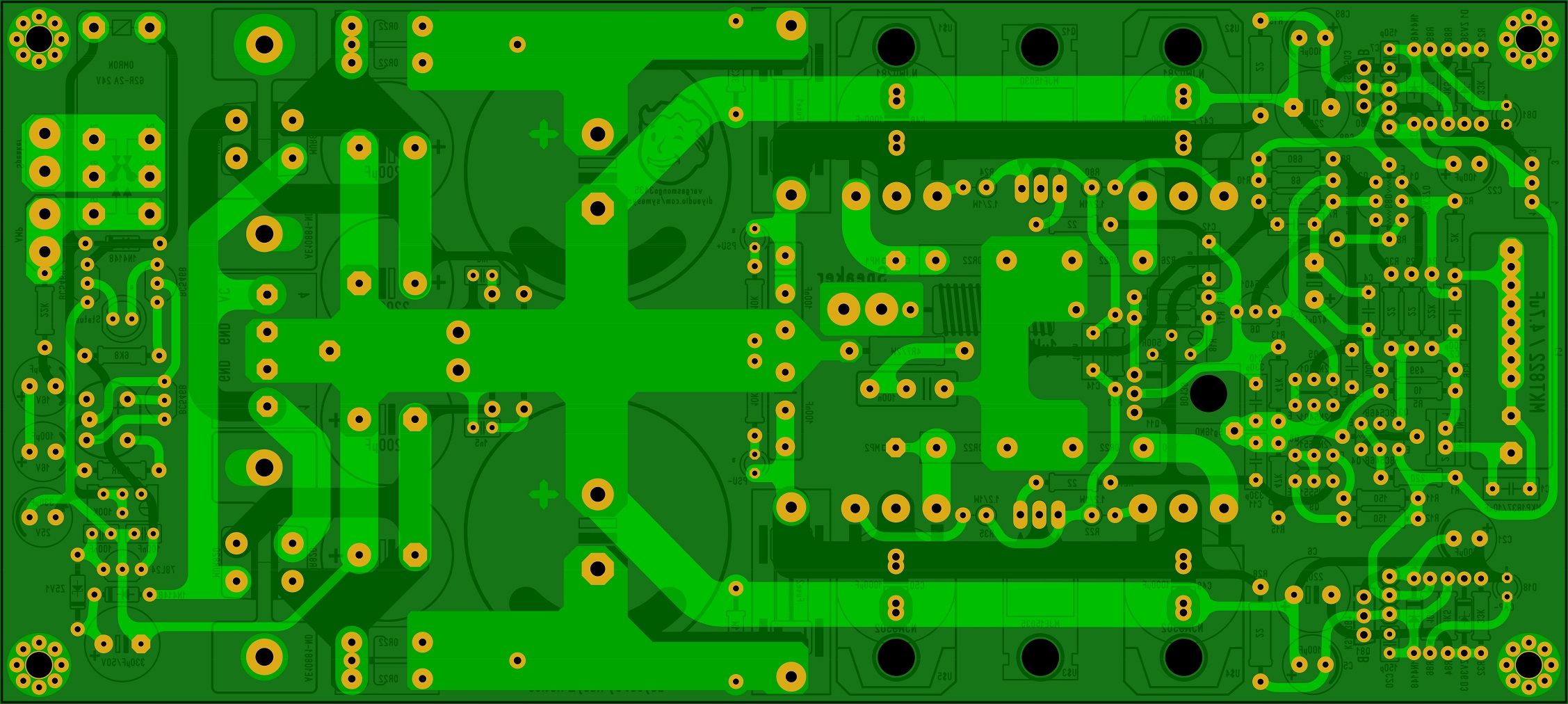

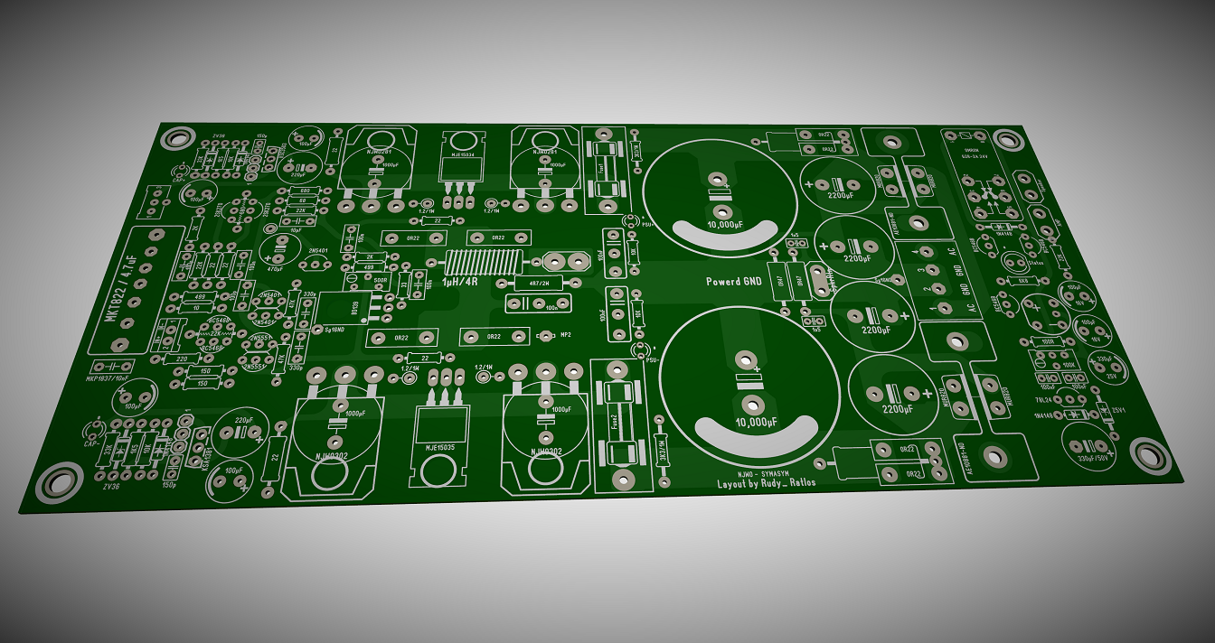

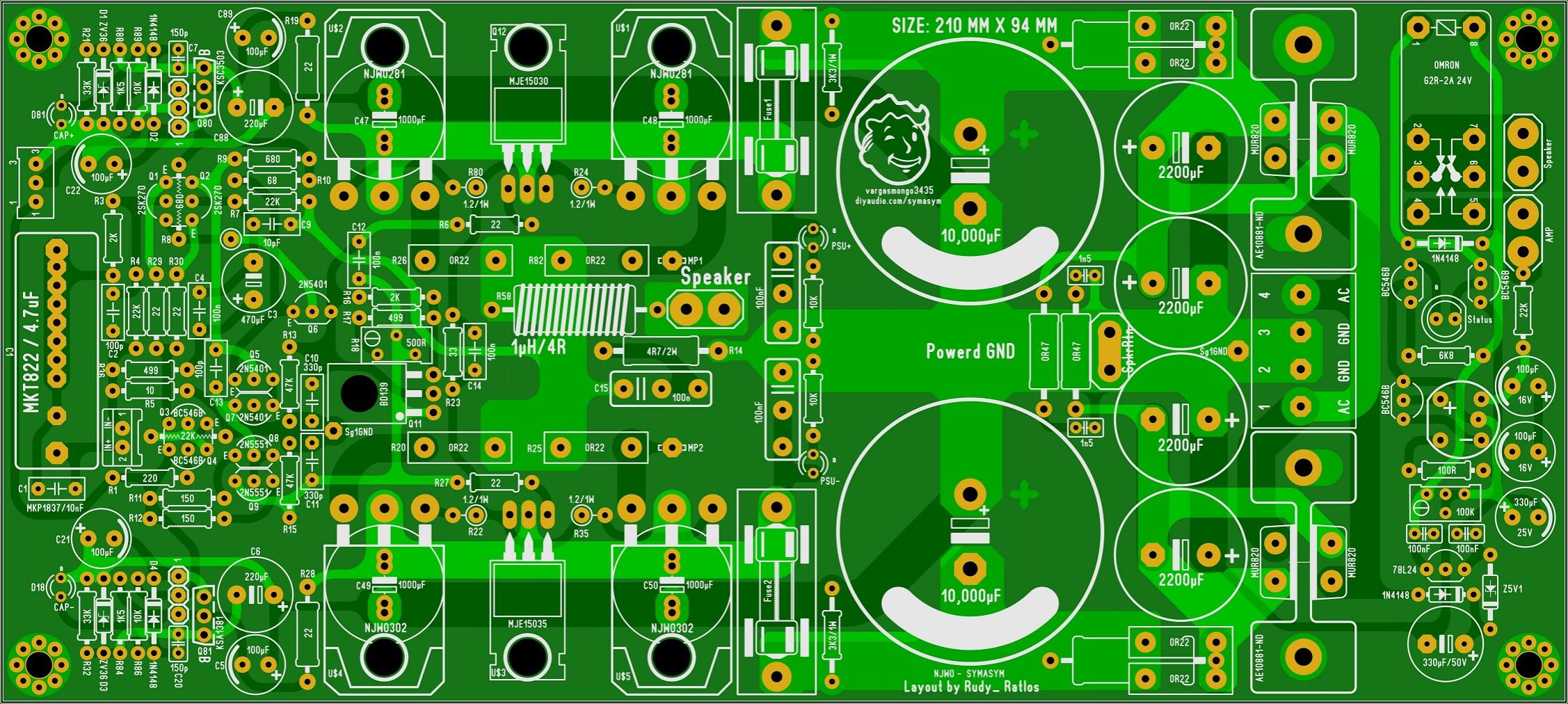

I spend a couple of hours tweaking the layout here is how it look today great PCB design Rudi
Best Regards
Juan

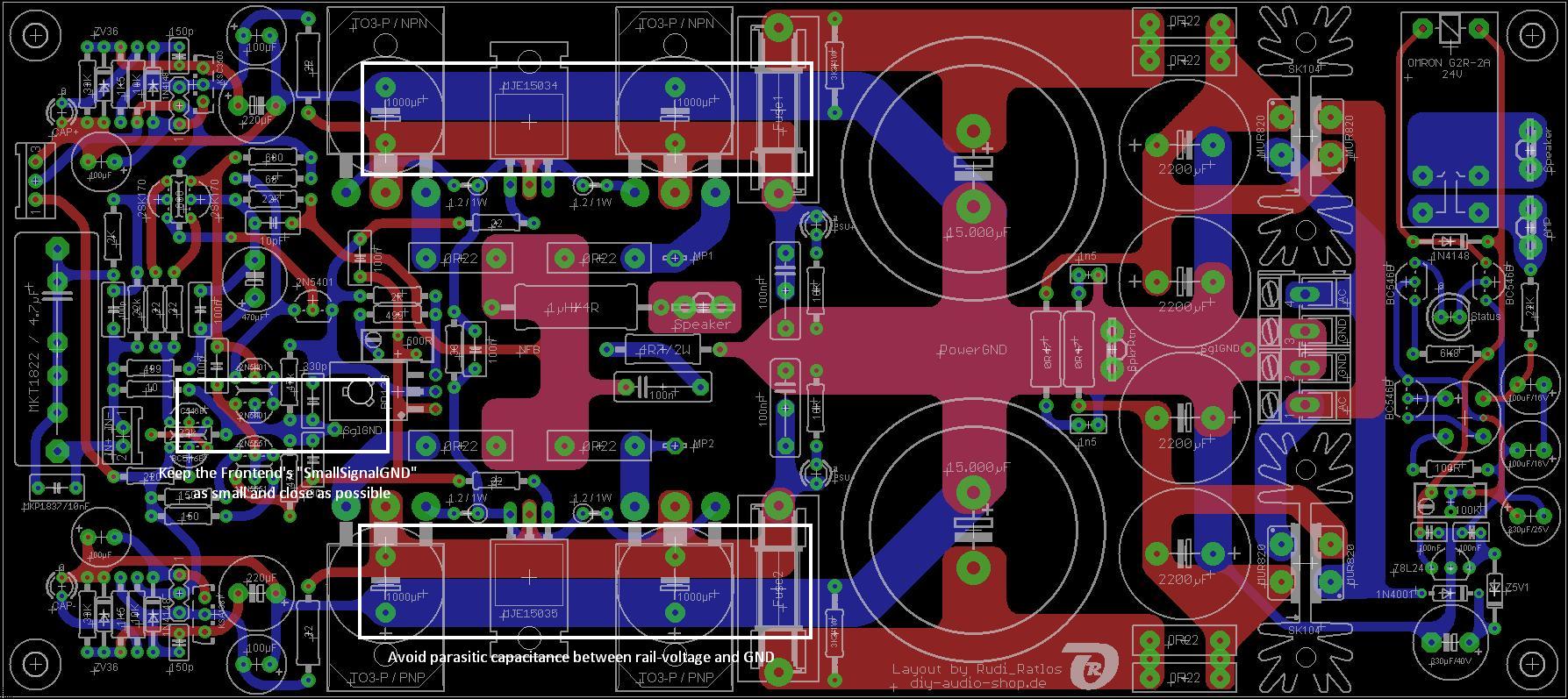

Juan, just my "2 cents":
1st cent: keep the backend-rail voltages and GND apart to avoid parasitic capacitances!
2nd cent: keep the frontend's "SmallSignalGND" as small and close / short as possible! Solder a wire manually to connect the "SmallSignalGND" to the "Transformer's GND"!
Your layout looks very, very nice!
I wish you a lot of Brasilian DIYers to use it!
Best regards - Rudi_Ratlos
P.S.: The layout also allows you to use TO264-case transistors like MJL4...

thanks Rudi for the advice but I'm from Puerto Rico and so I'm Puertorrican difficult word to pronounce 😛 jejeje never mind is cool man 🙂
I will check the distance of backend-rails and to check for TO264 to see if they fit correctly then
good day mister Rudi
Best Regards
Juan
