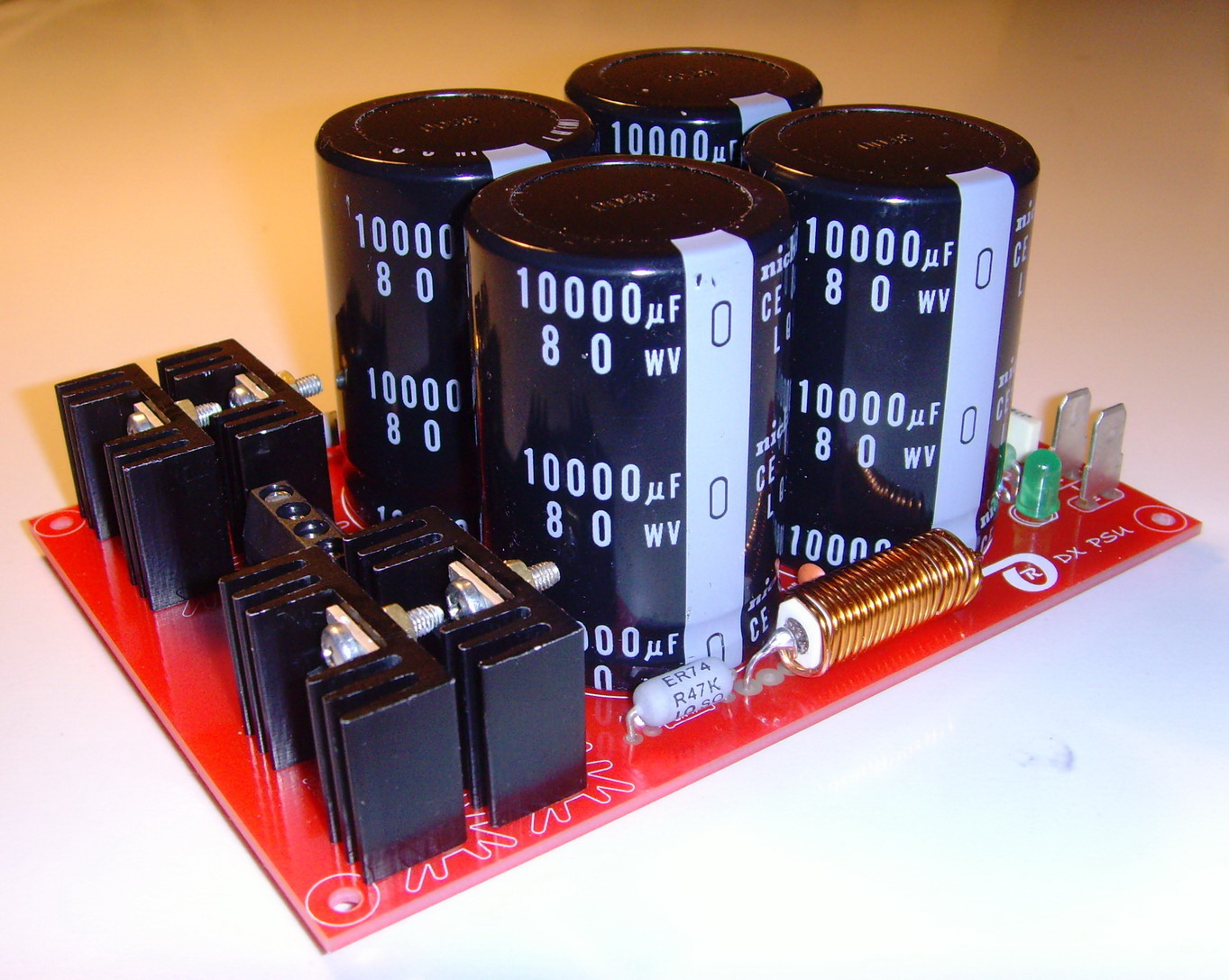

I am making the power supply for an earlier version of the TO3 Symasym using Carlos Mergulhao PCB. The build manual suggests to wind the inductor for the Pi filter using 40 turns of enamel copper wire around a 33Ohm resistor. Is the resistor necessary or could I wind the turns around a former and then remove the former to create an air cored inductor?
Alan
Alan, do it as Greg Erskine is telling you:
40 turns of 1.0 mm enamelled copper wire wound in 4 layers around R7 and R8 (approx. 13mH) (well: need not be 40 turns, can be 30 as well - LoL).
But: always use a resistor (Greg proposes to use a 33 Ohm resistor) to wind the enamelled wire around it.
Best regards - Rudi

40T in 4 layers will not get any where near 13mH.
Like I said, 40T is too few for a PSU filter.
A large diameter bobbin like 19 to 25mm with 100T to 200T (14layers of 14turn) is probably more like what is needed to get a reasonable inductance affect to roll off the higher harmonics.
Thank you for your replies. The question now is, if the inductor is too small a value to have any useful purpose in the power supply ( as Andrew T points out ) why is it there? Can it just be substituted with a low value resistor, say 0.1 Ohm?
If I had more space available I would wind larger inductors as suggested but this is not possible.
Thank you for your help.
Alan.

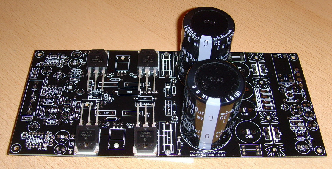

Gentlemen, I want to offer you the SYMASYM shown on the picture below.
It consists of:
- 2 PCBs "Black Beauty SYMASYM", with Backend PSU, Frontend CapMultiplier and Speaker Protection on board
- 2 pairs of matched NJW0281G and 2 pairs of matched NJW0302G
- 4 capacitors Nichicon 10.000µF/80V
The price: 65€ with shipping worldwide inclusive.
Best regards - Rudi_Ratlos

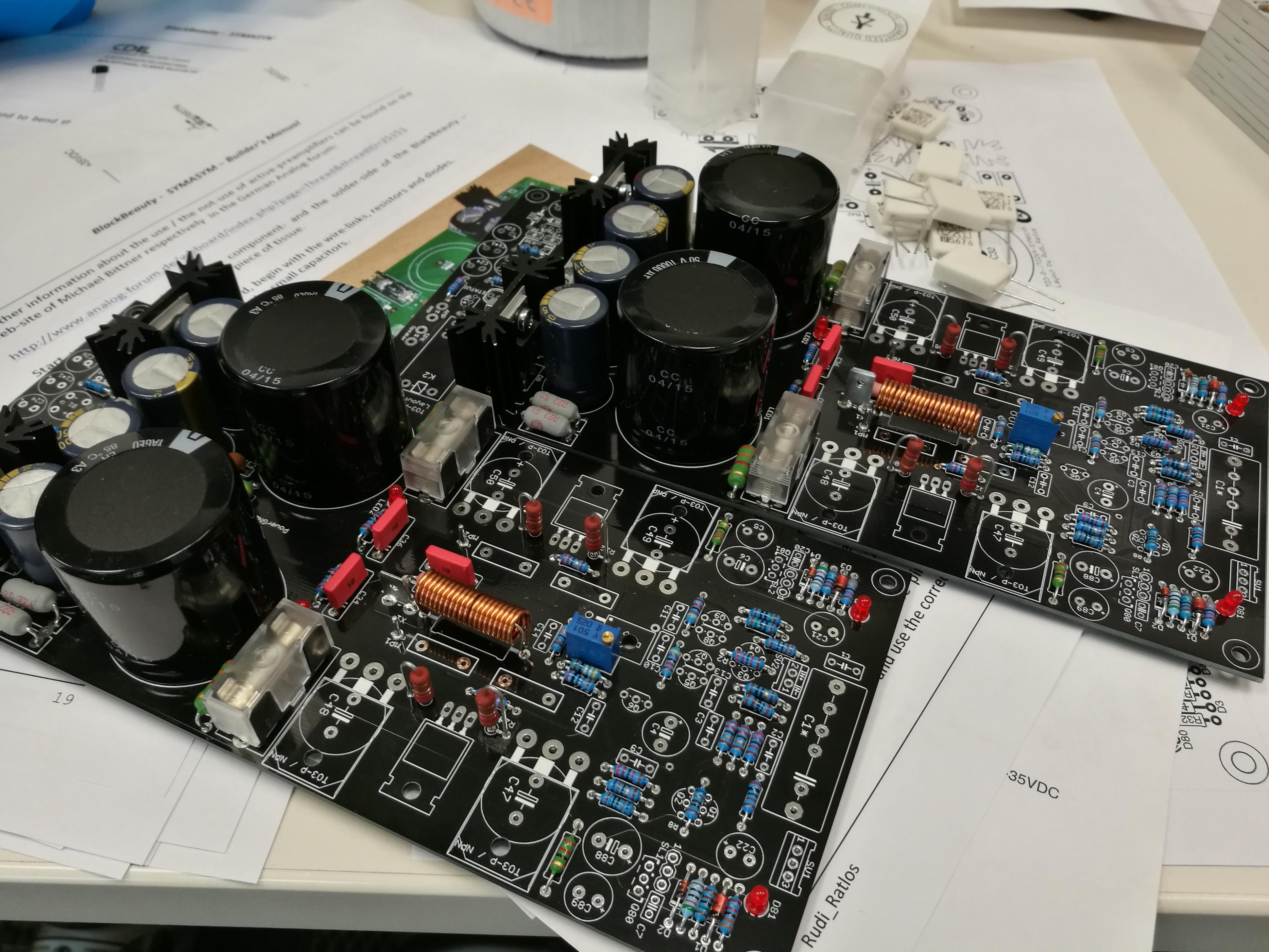

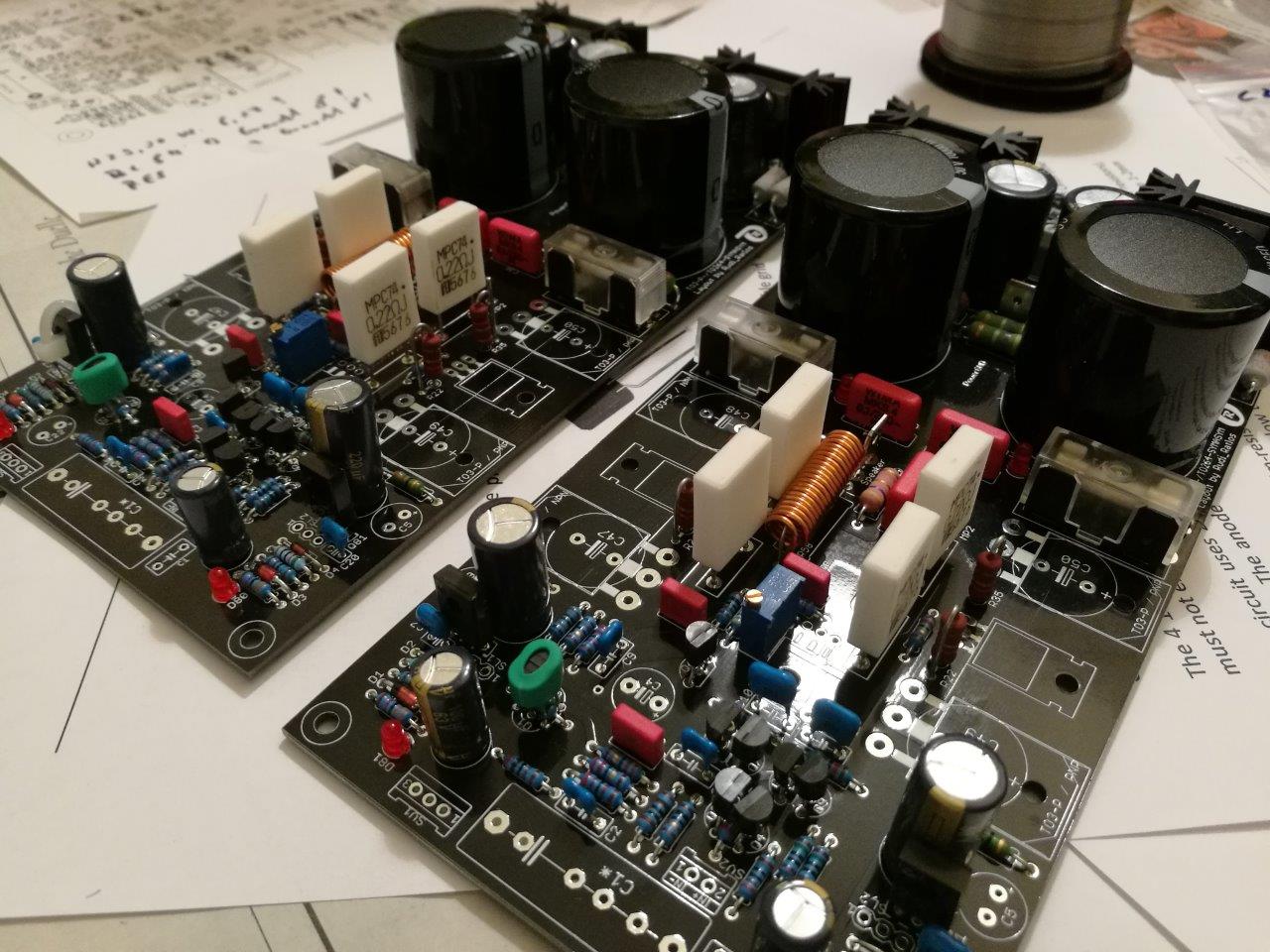

Hi everyone,
a quick intro first: My name is Oliver, I'm a software engineer from Berlin - and I'm in the process of building my Symasym based on the pcbs from diy-audio-shop. Partly out of interest, partly because I need a new power amp. The amp will be used to power Tuby6 diy speakers first but has to be able to drive ADW duettas in the future (projects on my todo..).
While the supplied manual has been very helpful, it seems to lack a BoM for the actual amplifier. The added reichelt-cart was partly unavailable and thus I have been stumbling over several things.
While I have no deeper eletronics experience (I do software only at work) I can furtunately use our electronics lab at work and have access to a good solder iron, LCR meter and wizardry like osciloscopes and function generators (though I have no idea how to use them :) )
This thread has been super helpful, I have actually read it from front to back if you believe it :)
Nonetheless I have reached a certain point in my build we some advice would be very very appreciated!
The build consists of diy-audio-shop PCB, talema 25V transformers, matched 2SK170*(from a ebay source linked in this thread I believe) and NJW0281G/0302G transistors.
Currently I have both power sections complete and tested ok and have continued with resistors and diodes.
My open issues/questions:
1. I have seen some pictures, where the input transistors have been tied together using heat shrink tube - is this advisable?
2. I struggled to decide which capacitors need to be mica - I have ordered them for C2, 9, 10, 11 and 13. Is this ok?
3. For the bigger footprint capacitors in the middle of the pcb (100nF, C15,34,36) I used Wima mks4 - but they don't really fit the pcb. Also in some pictures they look bigger then the ones I used, are there different versions?
4. For the power-section I used 2*10.000µF and 4*1000µF, but sometimes 15000 and 2200 seem to be used. Is the capacity ok for me or should I "upgrade"?

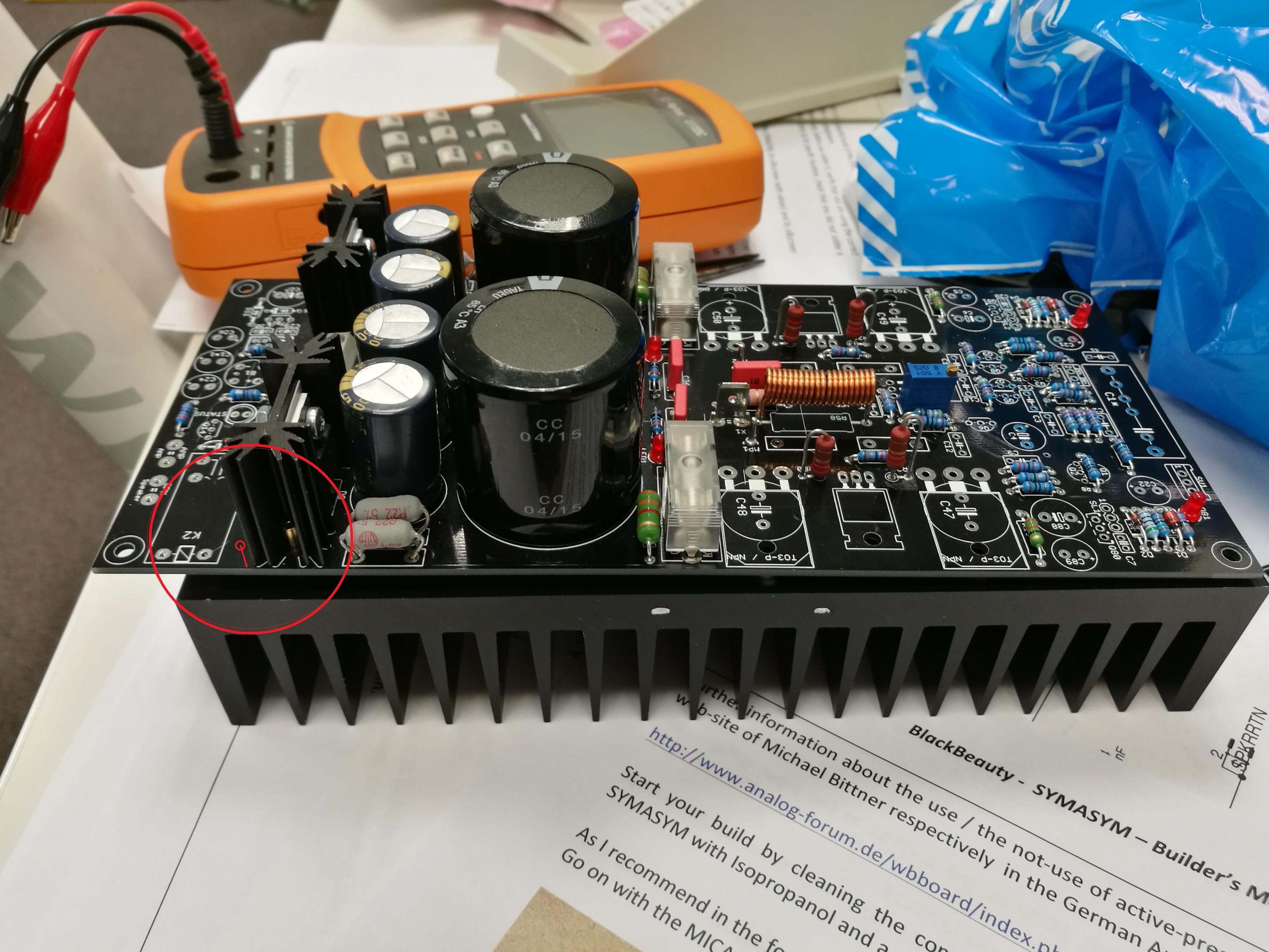

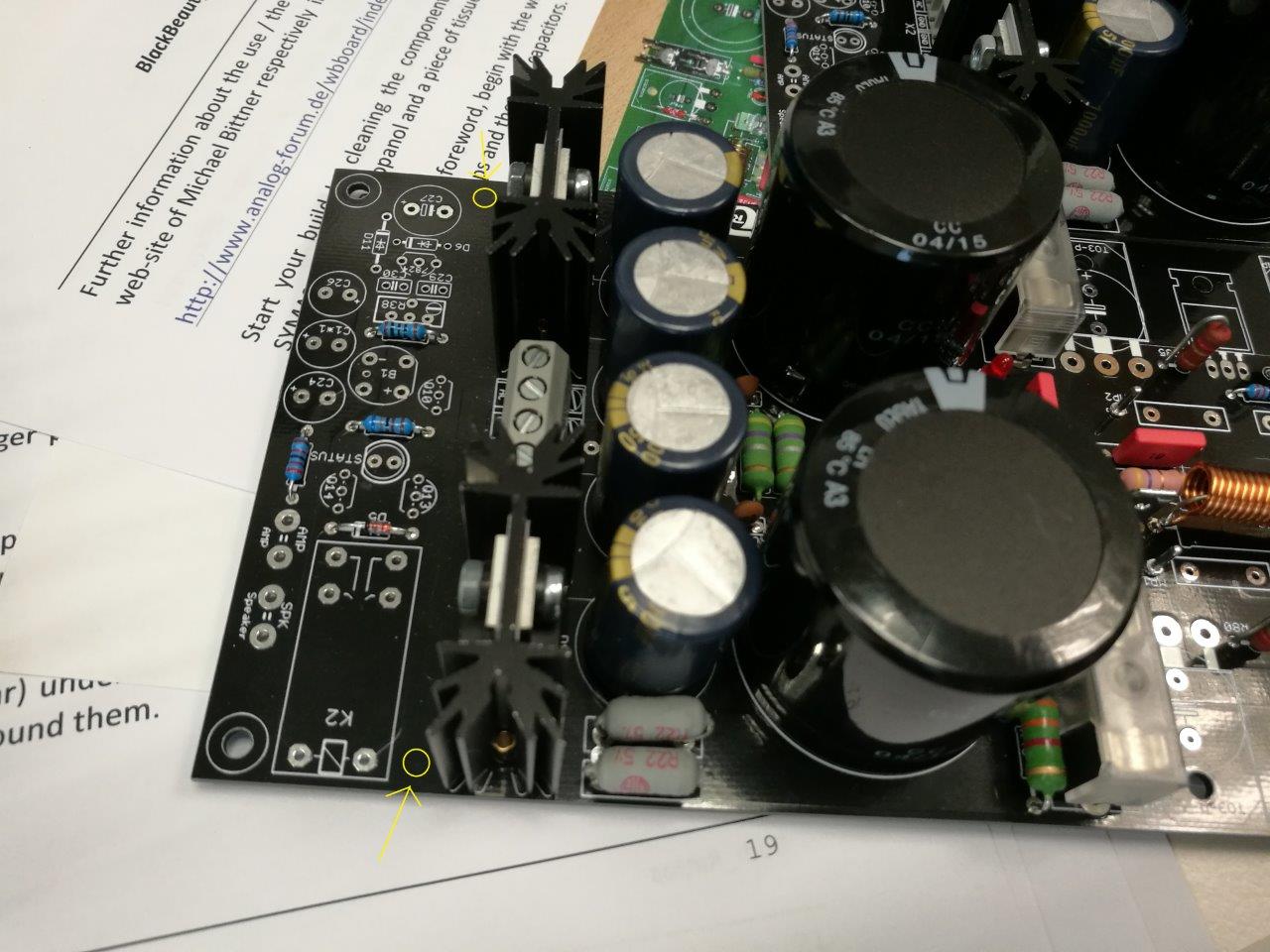

5. The heatsinks I bought are a little bit too small to mount the whole board.... is it ok to drill new holes behind the rectifier heatsinks as indicated in the picture? There seems to be nothing on the pcb there.
6. I am unsure about the "active pre-amplifier" definition. I will use an old Marantz amp with a fried power amp section as pre-amp. By my understanding this is an active preamp - right? So I should use 1k for R36 and 22ohm for R29 and 30?
7. The whole CAP thing is a bit confusing - I guess for me just enable CAP multiplier and be ok, right?
8. I wound 20 rounds of 1mm isolated copper around a 10ohm 2W resistor for R28 as instructed. It has almost 1µH now (which makes me happy), but obviously way lower resistance now - this is as intended, right?
Sorry about the wall of text, any help and comments would be highly appreciated. I'm not sure if it is of any use, but I could publish my BoM once the amps are done and working and might save someone else quite some time in the future.
Thanks, Oliver

...................1. I have seen some pictures, where the input transistors have been tied together using heat shrink tube - is this advisable?
the input pair should run at the same current and the same voltage thus giving the same power dissipation. To assist with maintiaining the same Tj it is better to glue or thermally connect the two devices and wrap something around them to help with maintaining the same case temperature.
There are two or three others pairs that also require this thermal matching. Do the same for them.
silvered mica, NP0 ceramic and polypropylene all behave very similarly. They are virtually interchangeable at audio frequencies.
MKS, MKT, PES, Mylar are all very similar. If alternative pin pitch have not been provided by the PCB layout designer then you need to find packages that have the correct pin pitch and fit the space available on the PCB
The main smoothing capacitance does not need and cannot benefit from adding smaller capacitors. Fit the MF and HF local supply rail decoupling where it can do some good, i.e. right next to the devices that demand variable current.
There is some disagreement on whether inserting a resistor inside a solenoid does any harm/good to the audio signal passing though. I place the damping resistor/s outside the solenoid core.

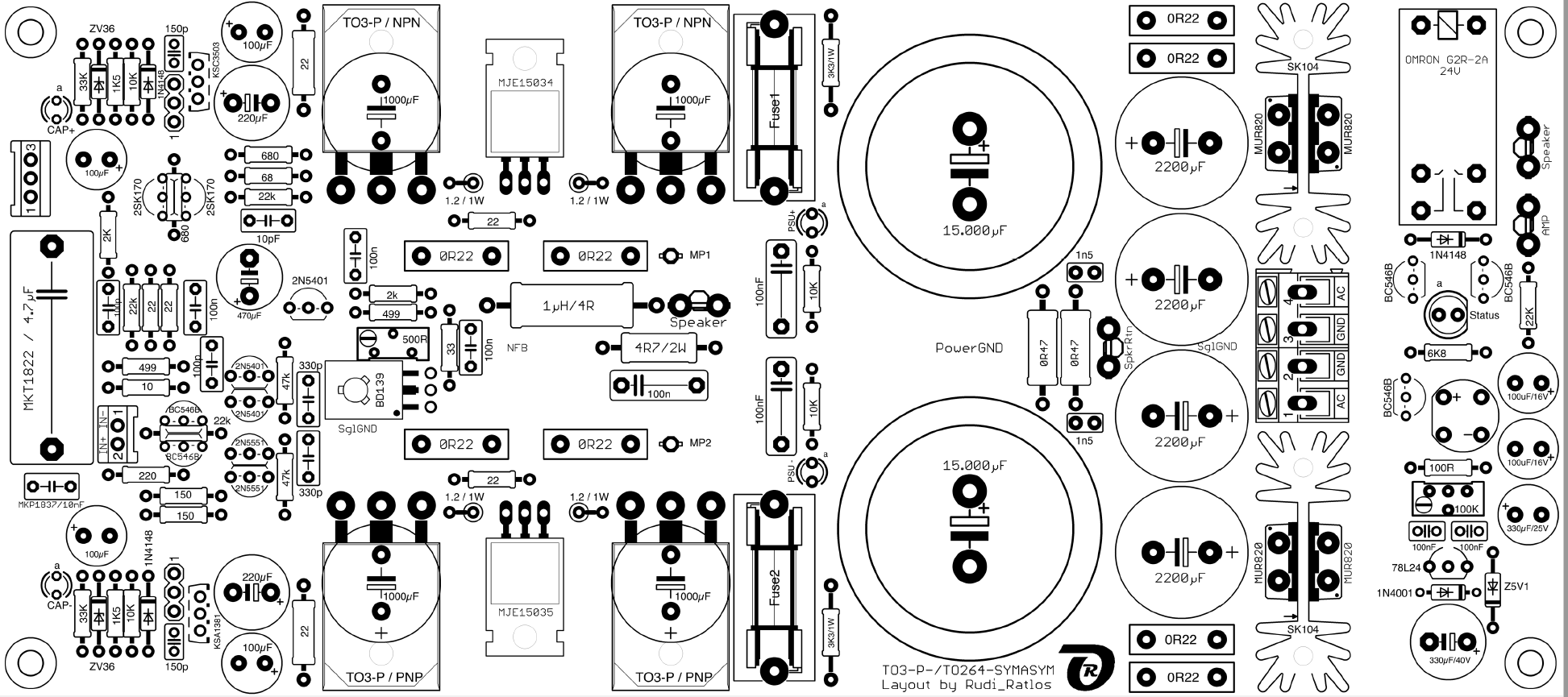

Regarding the power-section, I was maybe unclear - I did not add anything, I just used other values as are found in some manual sections. I have attached the pcb layout with values for reference (this is taken from a freely accessible document on diy-audio-shop.de | Platinen und mehr, hope it is ok to upload here?).
For the attached layout I used 10.000 µF instead of 15.000 and 1.000µF instead of 2.200. The larger values are found on the linked file, the smaller values are found in some parts of the manual. This might be a non-issue, but to someone not familiar with all the inner workings of this amp it is quite a frustrating uncertainty.

Hello Seldon, sorry for not giving you a cordial welcome as a SYMASYM-friend earlier!
Looking at your images in post 1373: everything looks good so far.
Please take care to get a quad of well-matched 2SK170 as input-differential.
As Andrew has adivsed you: bind a pair of 2SK170 together by means of a shrink hose to thermally couple it.
The capacitors that you have chosen for the backend-PSU are o.k
No reason to be worried!
Just write a post if you have any questions how to go on.

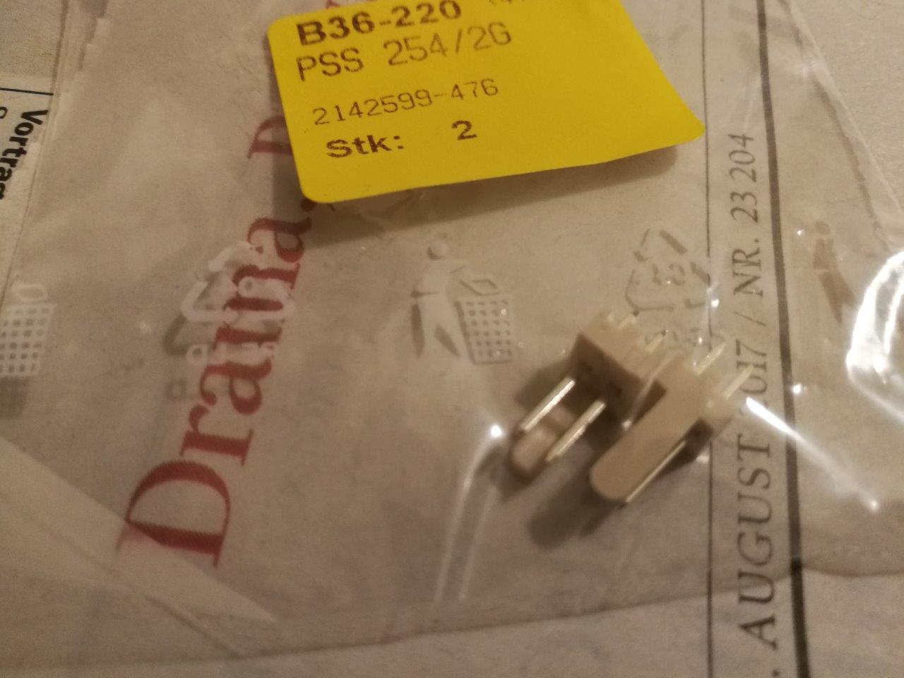

1. The electrolytic capacitors from the reichelt cart are a wild mix of voltages.. from 63 down to 25. Is there any downside of just ditching them and buying 63V capacitors for everything?
2. The input connector from the cart seems super-cheapo (see picture).. we go through the trouble of gold connectors and expensive cables and then use a 1cent plastic connector on the board? Is this recommended or would it be better to just solder wires directly?

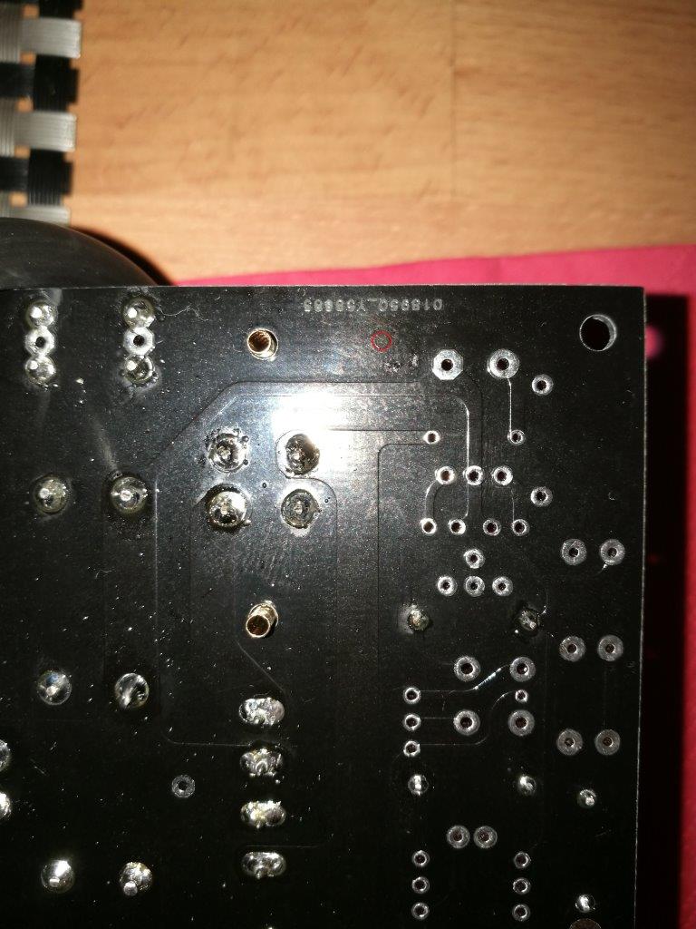

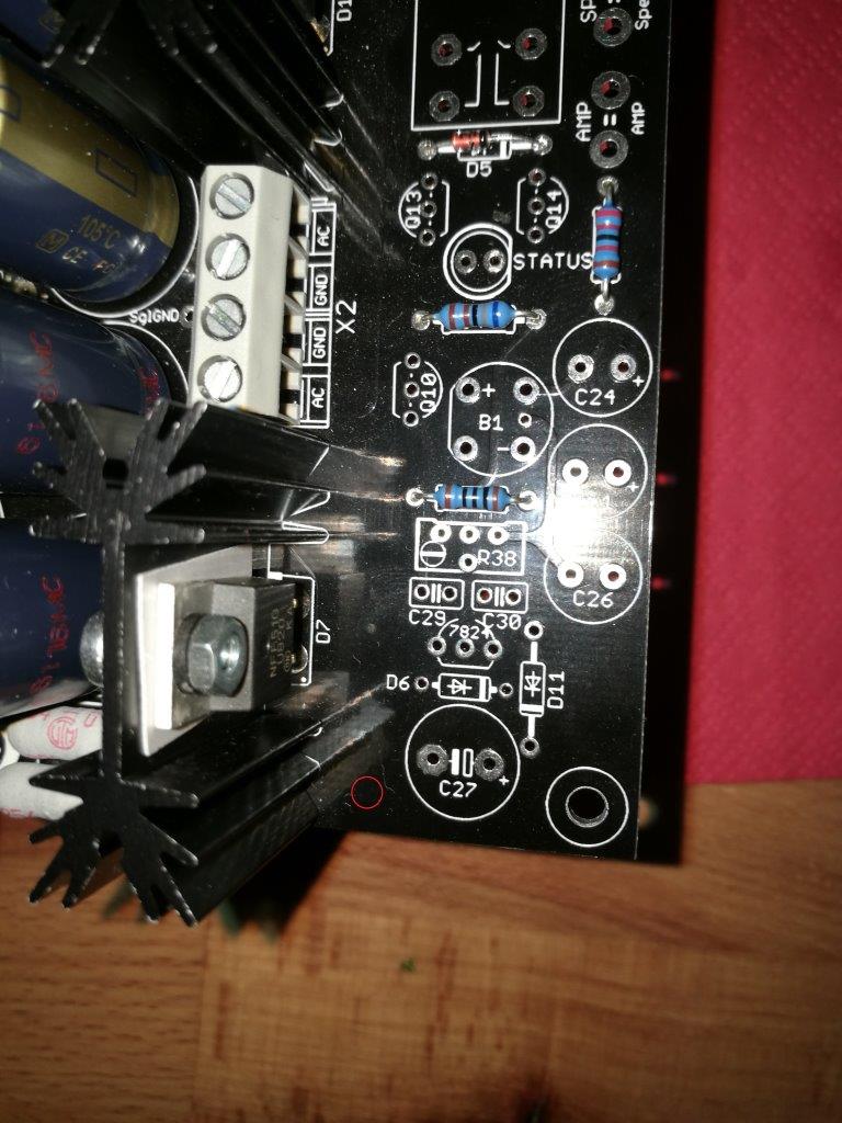

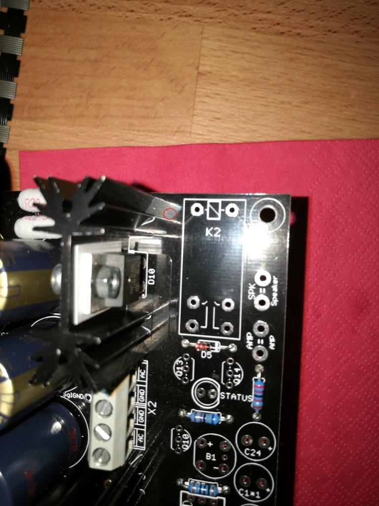

3. My chosen heatsinks are too small. Is it ok to drill the pcb in the indicated spot to use as mounting holes?

The capacitors need a voltage rating for the voltages they will be exposed to throughout their lives.
Not all of them need to be 63V rated. One, or two may need to be much higher and many could be considerably lower rating.
The plastic is just the support for the pins.
The "connector" is the pin. It should be some plated copper. The plating can be tin, or silver, or gold.
A push fit female will give a gas-tight joint where the female actually touches the male pin.
It's the quality of that gas-tight joint that matters to the signal passing through.
What's on the other side?

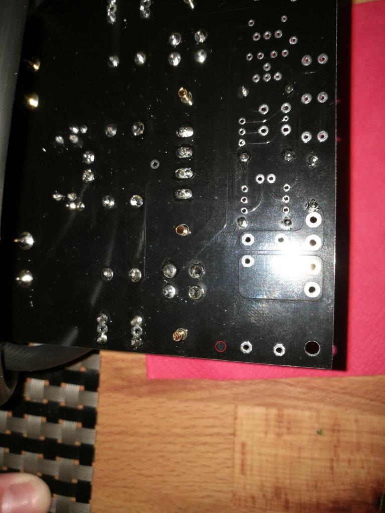

Andrew, thanks again for your help!
I have in the meantime (impatiently as I sometimes am) soldered the wire directly to the pcb. Here are some pics from the pcb, where I want to drill tomorrow.
I think this should be ok, in worst case I will cut some link to the speaker protection part (which should be fixable with a small wire connection)
