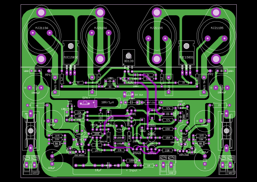

Rephil, thank you for your kind words!
I know myself that the SYMASYM is a real gem: easy and uncomplicate to build, it does not need any fancy
components, and it sounds amazingly well, especially, if you you have gone for the TO3 - version.
I have ordered a small couple of my current SYMASYM-TO3 - PCBs a minute ago (see attached image).
I have 3 PCBs left.
If anybody wants to have these 3 PCBs: send me a PM.
I will offer to this one an additional PCB as well. SURPRISE!
Best regards - Rudi_Ratlos

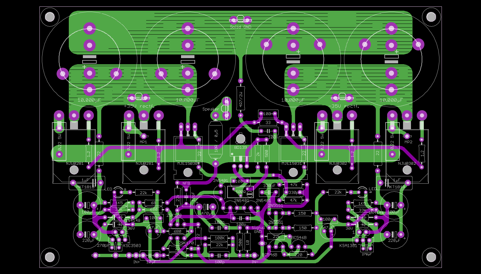

Gentlemen, SYMASYM-friends, I have received several feedbacks concerning my currently offered TO3/SYMASYM - PCBs (Rephil, Jorge, ... for example), telling me that my SYMASYM sounds best
(compared to nearly every competitor - DIY-Amplifier ) and that an audible improvement will not be possible ;) .
Will it not be?
According to my experience: an amplifier sounds at is best, if the PSU (the reservoir CAPs !) is mounted as close as possible to the consumers (the output transistors),
and therefore did a "final" layout of the (my) SYMASYM.
http://abload.de/img/njw-symasym_v3-topviedasww.png
I have mounted the big reservoir CAPs on top of the PCB, the output-transistors (NJW-transistors, the MJE-drivers and the TEMPCO - BD139) being mounted below the PCB and hope: this is it!
The Signal-GND (on the bottom of the PCB) will not be affected by the "noise" inserted by charging / dis-charging the Solid-GND (on top of the PCB).
I am sorry that my Gerber-File-Viewer (GERBV) is not able to present the layout of this PCB correctly. There are a lot of horizontal black, small tracks to disturb the overall view!
The PCB incorporates CAP-Multipliers to provide smoothed frontend-voltages (consuming less than 15mA per rail) - as you can see (for example) on the bottom right of the PCB.
I will go and order 10 of these PCBs on the the coming weekend. Six of them are already reserved.
If somebody of you will this PCB a try (since they are prototypes) and wants to have it (price is 12€ per PCB - shipping is 3.45€ worldwide): 4 of these PCBs are not yet reserved.
P.S.: The size of the PCB is 150x100mm.

Andrew, I am referring to the SYMASYM-version as show in post #764.
It uses 2 pairs of TO3 - MJ21195G/MJ21196G as output transistors.
The SYMASYM sounds very well with those TO3-transistors.
My current effort is to include part of the PSU (reservoir-capacitors) on the amplifier's PCB.
Since I couldn't come up with a reasonable layout using TO3s, I changed to NJW0281G/NJW0302G (TO-3P case) and will mount them beneath the PCB.
This way the "hot area" - charging and de-charging the reservoir caps - is on top of the PCB and does not (this is what I think) affect the "small signal" area,
which is on the bottom of the PCB and which is fed by 2 cap-multipliers.

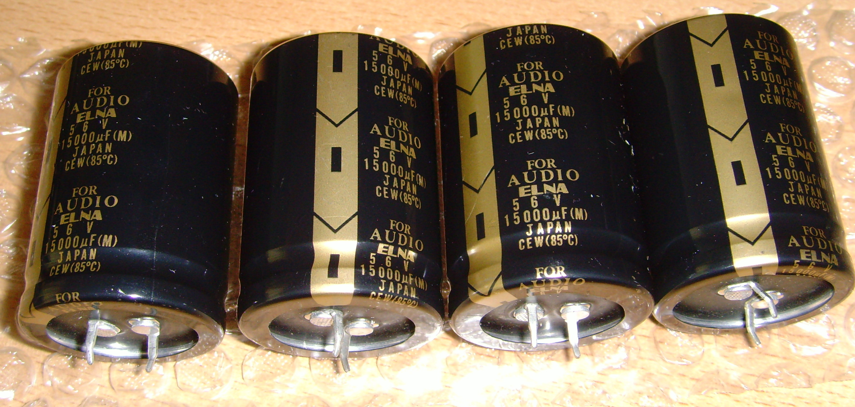

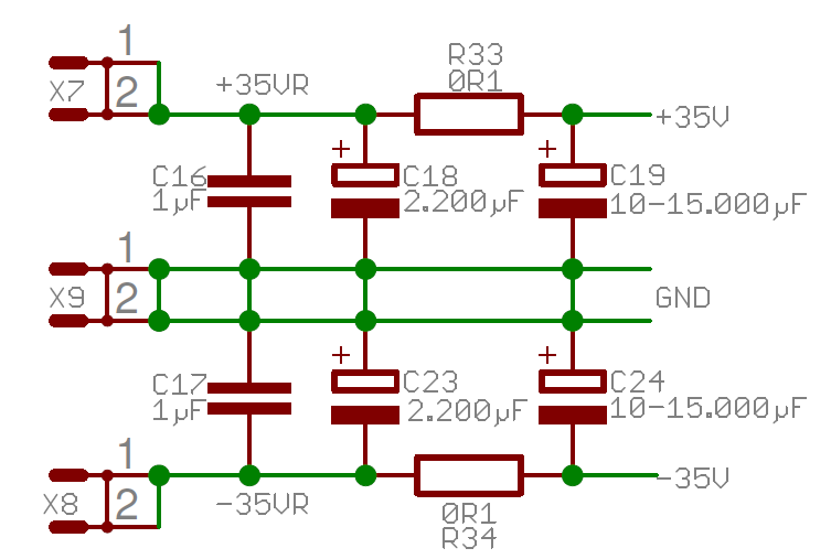

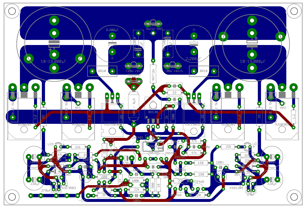

P.S.: In the meanwhile I have the enhanced (?) the on-top reservoir-capacitor layout by a new one, since I have had some luck and "inherited" a couple of "ELNA for AUDIO caps" for a very nice offering.
I wonder, how the NJW0 transistors will sound as compared to the TO3.

Patrick: I have given my word to somebody and will show him that the sound of the SYMASYM will be improved (will be "quicker"), if you mount the PSU-reservoir-CAPs
very close to the consumers (the output transistors).
P.S.: I will not offer this layout as a "Group-Buy - layout". I only did it to approve my assumption.
