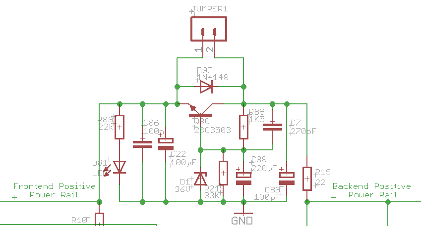

Is there any technical reason that says you had to use the 2SA1381 and 2SC3503 for the on-board CAP-multipler in the SyAsym boards ?
Is there some alternative to these transistors that could be acceptable without compromising the amp sound quality ? I have plenty of good old BD139 and BD140. They are fast and rugged. With a 25v-0-25V transformer feeding the SymAsym, I don't understand why I could not use them in the CAP-multiplier.
I ask because I don't want to get a burned amp ..., it occurs always when you don't know why something is done and you do some wrong (let's say) "improvement ".

Jean_Francois: take any NPN / PNP with a small output capacitance (some pF)!
The SYMASYM uses only 8-10mA in the frontend!

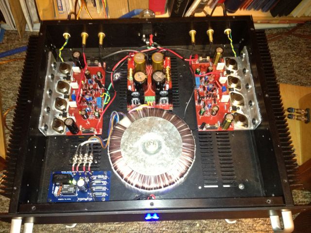

TO-3 Symasym up and running
I just finished this amp and have a couple of hours run time on it. It is extremely quiet (and I know as I have very noisy mains.) So far, good at low volume, very good at higher volume.

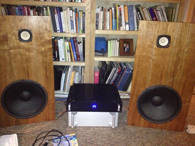

Apple lossless (iTunes w/PureMusic) --> Mac Mini (optical out) --> Cambridge Audio DACmagic --> Sansui CA2000 -->TO-3 SymaSym --> MJKing Open Baffle (Fostex Full Range and Eminence Alpha-15A)
Next up... I'm going to add my Aikido (with 6CG7s) pre-amp. Then I'll fold in my OPUS DAC etc.
Rudi's boards and build guide are the best!
By the way, I have a very big (800 VA) transformer so I'm using the DIYAudio softstart circuit as well.

@mcds: the PCB-layout already includes CAP-multipliers to provide smooth and stable voltages for the frontend, and the CAP-multipliers

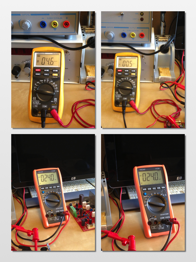

@Rephil: I measured my TO3s with a collector current of 100mA (adjusted by the CCS of my test-rig).

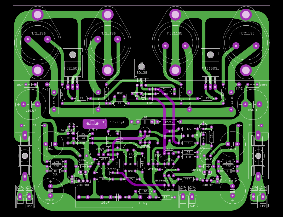

Gentlemen, to offer you the current layout of the TO3-SYMASYM in a group-buy will cost a lot of money per PCB,
since the layout needs tooling costs!
But I will offer you a PDF-file of the solder-layer to "Do-it-Yourself".
The size of the PCB is 139,7 x 112,4 mm.
If you need further instructions, how to build: tell me.

BTW, I measured the TO3 that you provided matched to me : they are really very well matched : hFE difference <1% ! and the Vbe is also very good between pairs : difference <1mV ! How many transistors did you measure in order to get such a good result ?
IMHO you could match at 50mA (I did do the measurement too) : the values of hFE are practically the same as for 100mA, the Vbe match the same as previously, obviously at other values.
