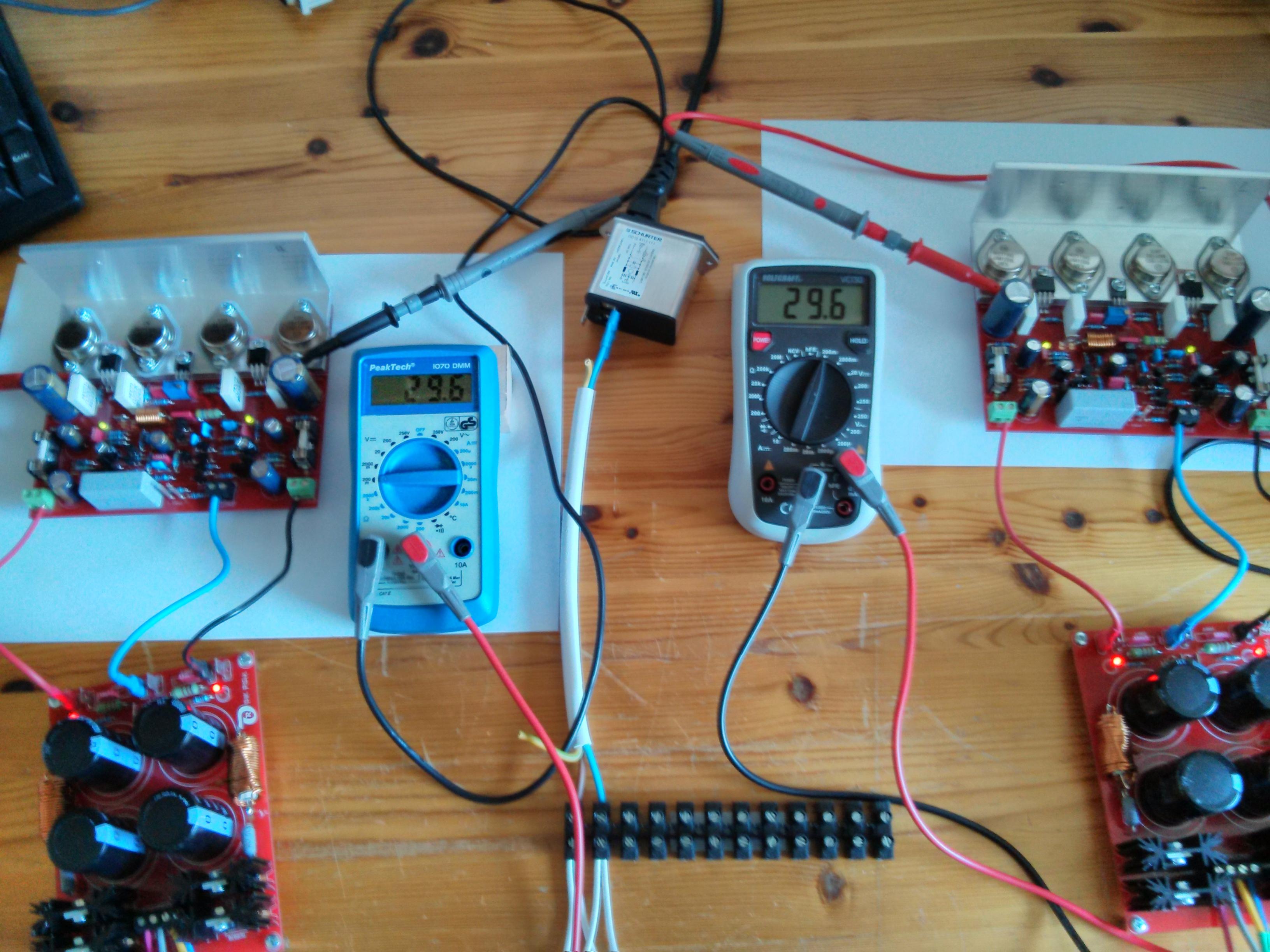

The first challenge today was to get the wrongly inserted 2n5551 right, I did not have any desoldering wick left.
So I had to revert to a desoldering pump and brute force, I did have two spare pairs of matched 2n5551 and used these.
Removed the jumpers, to activate the CAP-Multiplier
Second: Getting the L profile and the power transistors in place.
Rudi, thanks for the tip to use some shrink tubing, that is a live saver.
I did not use paper as insulator between L profile and PCB, I did have some extra TO-3 micas ( 8 ) and used these.
Third: Power on, no blown fuses, no smoking parts, all OK.
Forth: Set the bias current, R channel had the DMM on the wrong setting, so adjusted too high for a few seconds, turned all the way back, set the DMM the right position, and re-adjusted, set value to 29 mV.
L channel, made sure the DMM was set to the right position 🙂) no problem setting to adjust to the same 29 mV. it creeps up slowly, and the power transistors get warm (not hot). R channel gets warmer then the L channel.
I did power down after about 10 minutes, (L profiles where warm, but I did not have a problem handling them with my bare hands).
I want to attach the heat sinks first before continuing, and make a temporary backplate for the input connectors and speaker terminals.
So I expect, that next weekend it will play some music.

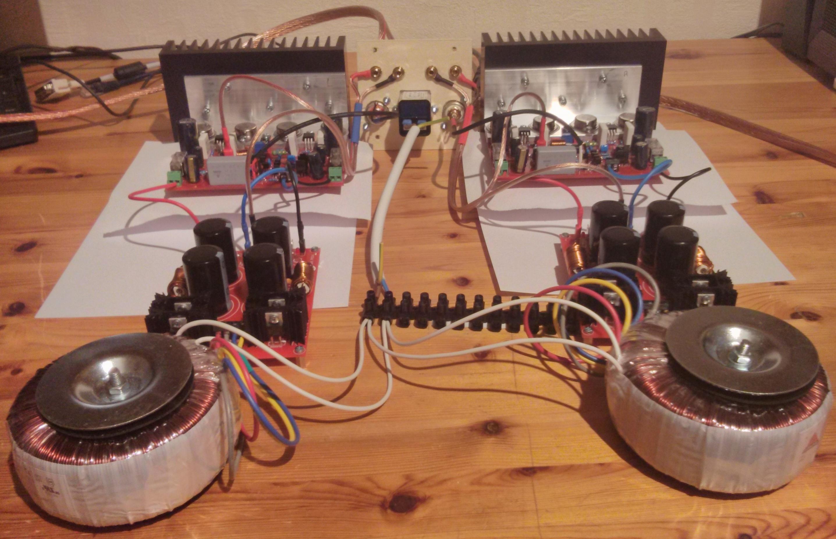

The sweet sound of success
Yesterday was a nicel day, I heard the sweet sound of success, the system is playing music, thanks to Rudi's high quality PCB's.
I have had JBL E20 and KEF LS-50 speakers connected to the system.
I could not hear tonal differences to a previously build symasym with MJL 3281A / 1302A transistors (boards not from here). That is good since I really like the sound these designs transfer.
I just re-read the start of this thread, and the reason for this specific design is to drive lower impedance speakers, that is not the case here, the system will go to a relative.
For me this build is a success and I praise all that helped to design the layout and improve the initial system.
For the keen eye I have added two more holes to each the L profiles for better contact to the heat sink.
The previous comments on the heat sink selection must be taken seriously. The heat sinks, SK 85/100 SA (100 mm high), get more then hand warm (not hot) when listening to music at moderate output level for more than an hour, the transistors stay relatively cool.
NOTE: For builders without proper tools, connecting the L-profiles to the heat sinks is a time consuming process.
Most important use new drill bits to drill the holes in the heat sinks, this saves time and nerves.
