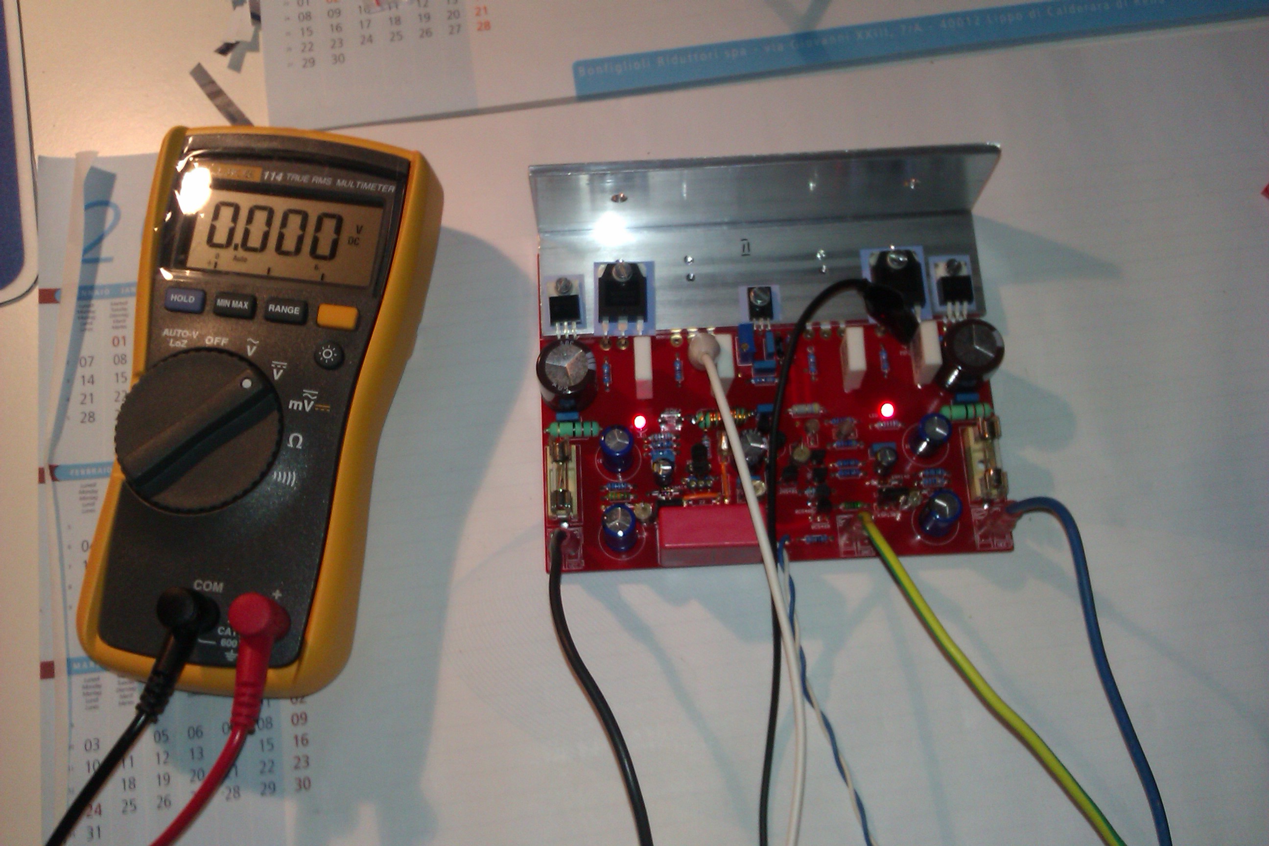

Ooops update #1
Reminder of the problem: I had loud static output after returning to my amp whilst letting it play unattended. I wasn't around when things went awry.
Here are some of the measurements I made:
As a precaution, I checked that there were no shorts between transistors and the heatsink. All was fine.
So then I powered up the PSU...
- Rails:+/- 38 VDC (unloaded, my mains fluctuates a lot, and my rails are in the 37-38+ range). I have +/- 25VAC primary transformer.
Then I powered the Amp board:
With input grounded:
- Vtp1 to Vtp2 is 24 mV
- Vdc across output 18 mV
Any ideas? Is it possible that because of my higher rail voltage, the front end regulation was toasted?
I have Rudi's LTSpice sim (Thanks Rudi!) , but I do not have an immediately easy way to run it. So, I don't have voltages to check yet.
Ryan
PS: Yes, I have tested the amp with another pre-amp and set of speakers, so I know that the problem resides with the amp.

In a previous post, I believe Rudi suggests to re-set the bias after adding the second set of output transistors. In my case (TO-3) I found that I needed to adjust the bias a little bit... on the order of a couple of mV, after adding the second set of TO-3s. Nothing dramatic.
If I am incorrect or have mis-understood, please let me know.

Ryan, if you have activated the onboard-CAP-multiplier (if you did not set the jumper-cap), the zener diode delimits
the frontend-voltage to 36VDC. You need not worry then.
Moreover: 38VDC is not a voltage to worry about.
I recommended to adjust the quiescent current / BIAS with only one MJ21196 / MJ21195 being soldered to minimize the dammage,
in case you have done a error while soldering the PCB.
It is then required to do the adjustment once more, after you have soldered the 2nd pair of MJ21196 / MJ21195.
The usage of LTSpice is very simple. Download the current version, open the SYMASYM.asc file that I sent you,
and then click on the icon "RUN" on the toolbar.
Position the cursor on any component / track on the schematics and click to plot the voltage, amount of current, ...
According to my experience a crackling noise has to do some with a mechanical error (f.e. a short between the ALU profile
and the output transistors, something getting hot after a while, ...).
I hope that you are able to find the error.
Best regards - Rudi_Ratlos

Help please
All,
My woes are outlined up above.... But last testing, Bias 24 mV, DC offest within spec. Amp was a massive AM radio receiver. I turned it off quickly to avoid toasting things.
Given that I had plenty of small signal transistors on hand, I decided to replace them all... it is an expedient approach to fixing things. I understand, not very sophisticated nor elegant. Regardless... now that I have all new small signals, the bias comes up solid at 24 mV as before. However, I'm now looking at about 1.2V of DC offset on the output.
Update: after 15 minutes or less, it's now to 0.9 VDC on the output.
That is with the input grounded. I DO have matched to 2SK170s on the input. Where else do I need to 'match' the small signal transistors more closely to reduce the DC offset? Or is there something else I'm missing.
Note, I also replaced the input capacitor with another MKP type.

update
The Vdc offset settled down to about 170mV, well outside of spec. So ...
I had a bunch of MPSA18 sitting around. I quickly matched a pair for Hfe and installed those (at 180degrees to the sk170).
====INCORRECT
All seems okay. Vdc is now a fraction of a mV (i.e. mostly zero.) I've set the bias to ~25.5 mV as I have larger heatsinks. I will let it settle for a few hours and see what happens. Then maybe some music.
=====INCORRECT.
It helps to have the output connected to the speaker terminals on the chassis... brilliant..
OFFSET is still a couple of hundred mV. So I will try to do as Andrew suggested as well as run the Sim to get voltages around the circuit. I was too anxious in hoping for a quick fix. How fussy is the "C" rating in the BC560C position?
Ryan

With MPSA18, 25mV bias setting, 300mV of VDC on the output:
Of the measurements I've made, there doesn't seem to be anything extraordinarily out of whack but ...
Emitter currents for the 2n5551 (measured across the 150R resistors)
Current through R12 = (.362V/150R) = 2.41 mA into emitter of Q9 (Q11 on sim)
Sim says: 2.48 mA
Current through R11 = (.343V/150R) = 2.28 mA to emitter of Q8 (Q13 on sim)
Sim says 2.44 mA
Current thru 47K resistor that connects to collector of 2N5551:31.9 uA
Simulation says: 18.2 uA ... That seems to be a problem
Current thru 47K resistor that connects to collector of 2N5401: 19.8 uA
Simulation says: 22.4 uA
Current thru 68R resistor that connects to emitters of 2N5401: 4.8 mA
Simulation says: 5 mA
Do these give a hint as to what might be amiss?
Thanks!
Ryan

Ryan, a well-matched SYMASYM shows a DC-Offset of < 5mV. My own one has an offset of about 1mV.
Whenever I read about a SYMASYM - DC-Offset problem in the German DIY-forum and then read the
conclusion, it is one of 3 reasons:
1 - solder error (short)
2 - wrong small transistor used
3 - reversed pinout of small transistor used
Your findings (2N5551) point to this direction as well.
Best regards - Rudi
Best regards - Rudi
