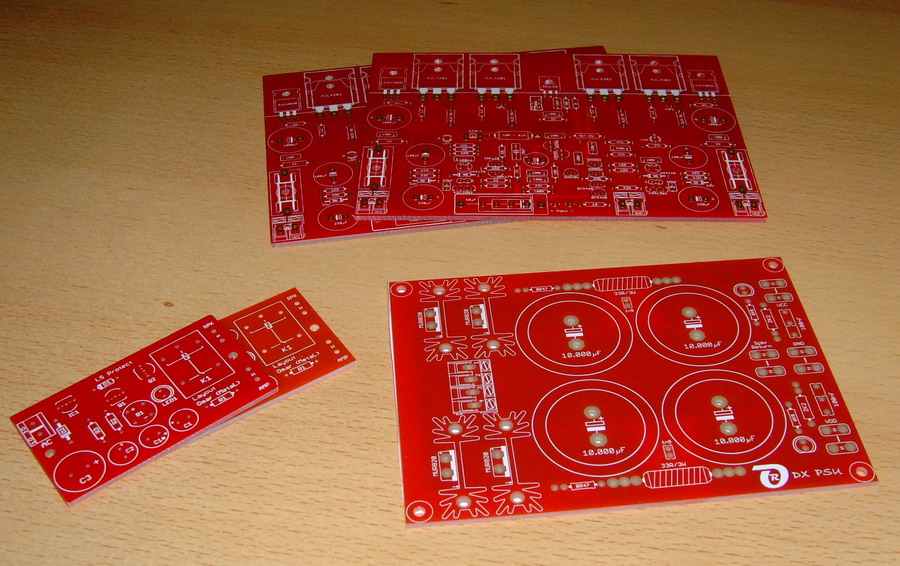

Joseph,
I have two sets, each set consisting of: 2 AMP PCBs, 2 SpeakerProtection PCBs and 1 PSU PCB, left.
Best regards - Rudi
P.S. I just had a look into my PCB-drawer: I have even 2 more PSU PCBs.

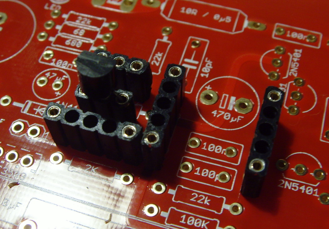

The SYMASYM sets of my post #483 have already been sold.
One way to build a "flexible" SYMASYM (Pre-Amplifier or not?, which transistor to use on the differential input?) is, to do it like this.
Best regards - Rudi_Ratlos

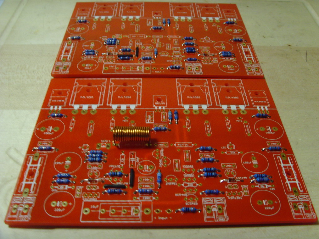

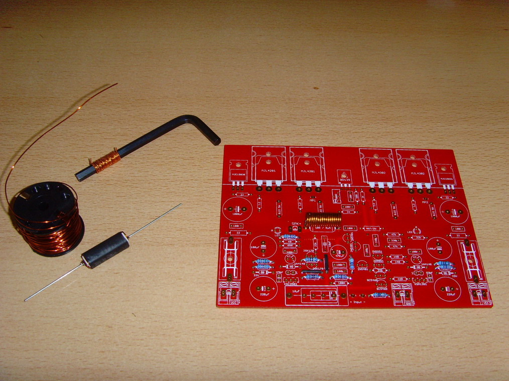

Carl,
I have already begun to solder my own TO-264 / TO-3P SYMASYM.
I will user NJW0281/NJW0302 as OP-transistors.
I have wound 2 PI-filters (33 Ohm / 1µH) for the PSU, have wound a PI-/EMI - filter (10Ohm / 1µH) for the speaker output, ...,
but I ran out of resistors! :eek:
I will take my bicycle and drive to Hamburg right now and buy a couple of 1R2 and 22K resistors.
You have to be patient for some days yet.
The PCBs are on their way to you.
Best reagrds - Rudi_Ratlos

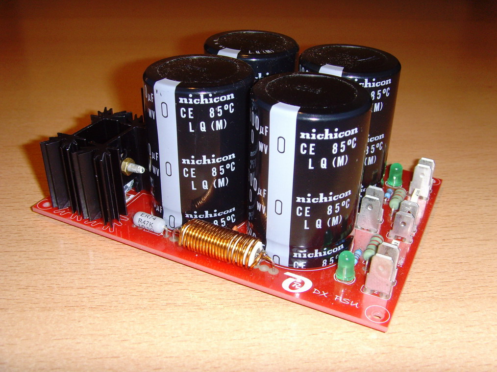

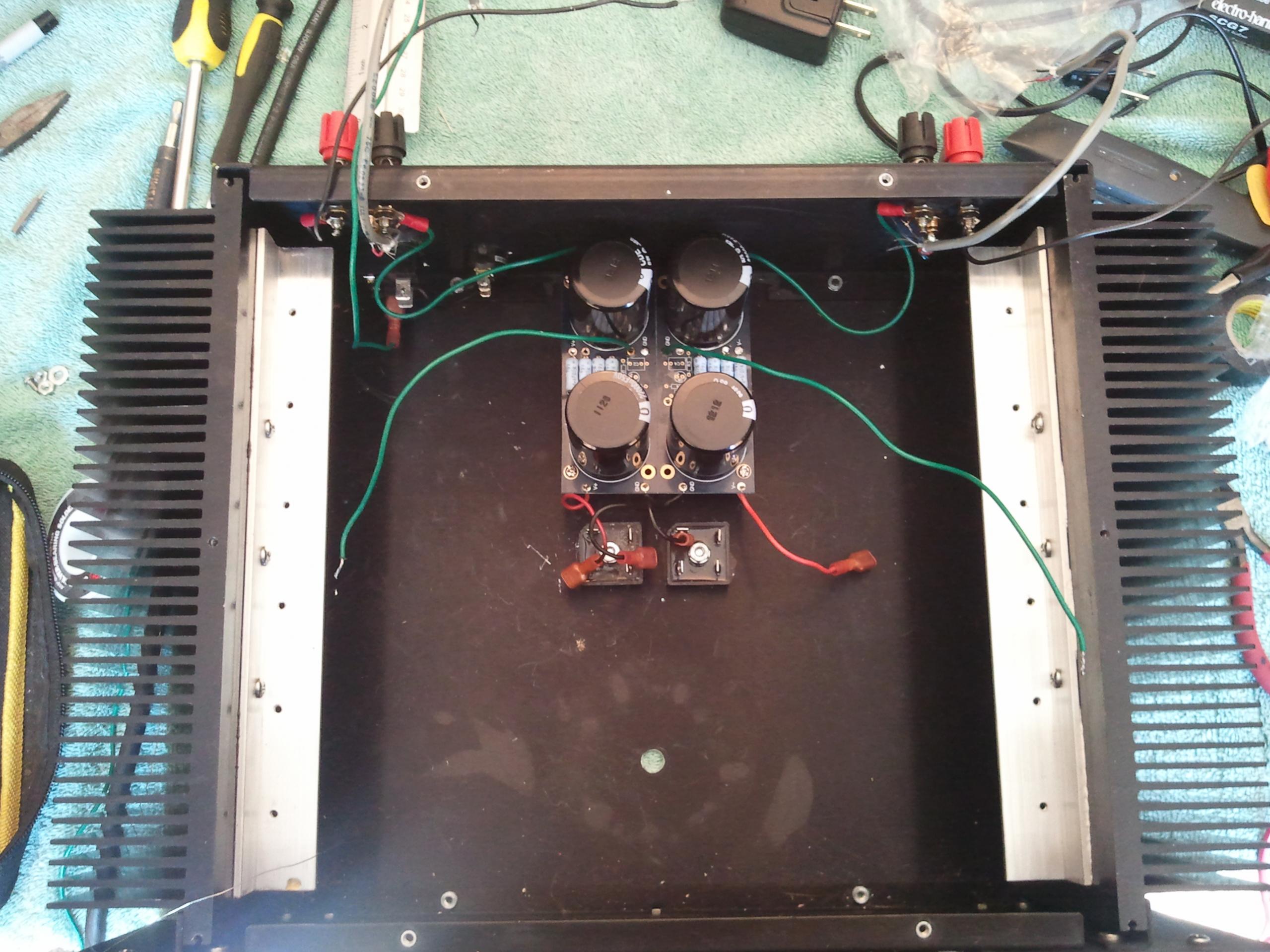

Psu is done...vishay 30 a rectifiers and 44,000 uF per rail. Peter Daniel universal psu board with crc filtering.
Par metal 3U size case with aluminum angle already installed from a previous project
All components are delivered from mouser so I am ready to go!
Here you go...
It is very simple PSU but has capability of being a regulator with different components. In this case it is a simple CRC filter - and the rectifiers are off-board with this PCB.
I am using 4XPanasonic 0.47R per rail. Caps are 50V.\
These are the rectifiers Supposedly the Pass amps use this or something very similar. I have used them in many amps and they seem to work good and are very reasonable.

Thank you for the picture, Carl.
This PSU is indeed very versatile and will do a good job for the SYMASYM.
The heatsinks of your case are more than sufficient. Be sure to apply a thin film of thermal grease between the ALU-L profiles and the heatsinks.
May be, there already is - at least on the right side.
Tell me: which transformer will you use?
The ratings of the SYMASYM are: 100W @ 4 Ohm and 60Watt @ 8 Ohm using a transformer with 2 x 27 VAC secondaries / 225W.
If you want to go for higher ratings (f.e. by using a 2 x 30 VAC / 300W transformer): be sure to insert an appropriate ZENER diode
into the onboard-CAP-multiplier to prevent damage to your input transistors (2SK170 f.e.).

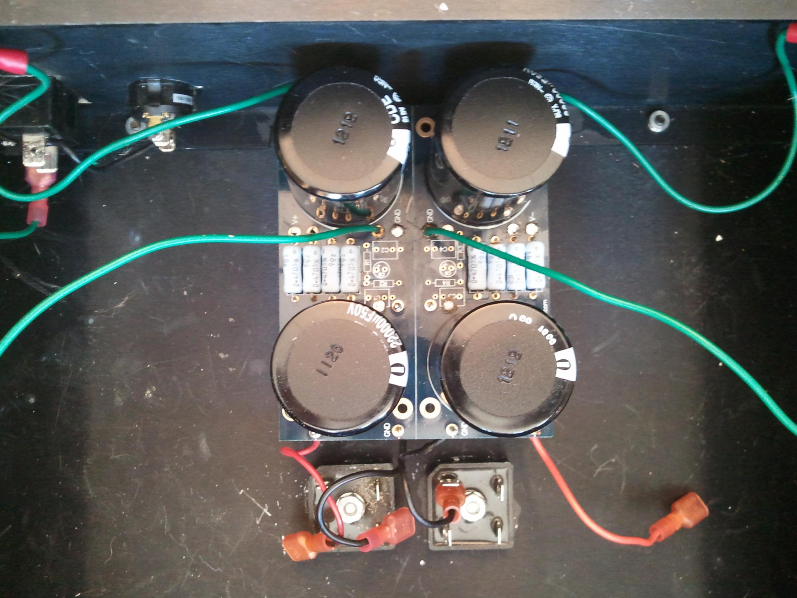

I am starting out with an Antek 300VA dual 25V secondary unit.
Yes I had applied thermal grease to the L profiles, I just hope they are large enough to accommodate the board, they are about 25mmX25mm. I know the TO-3P will fit easily, just if the board provides enough clearance. Might have to get creative when bending the leads for the transistors.

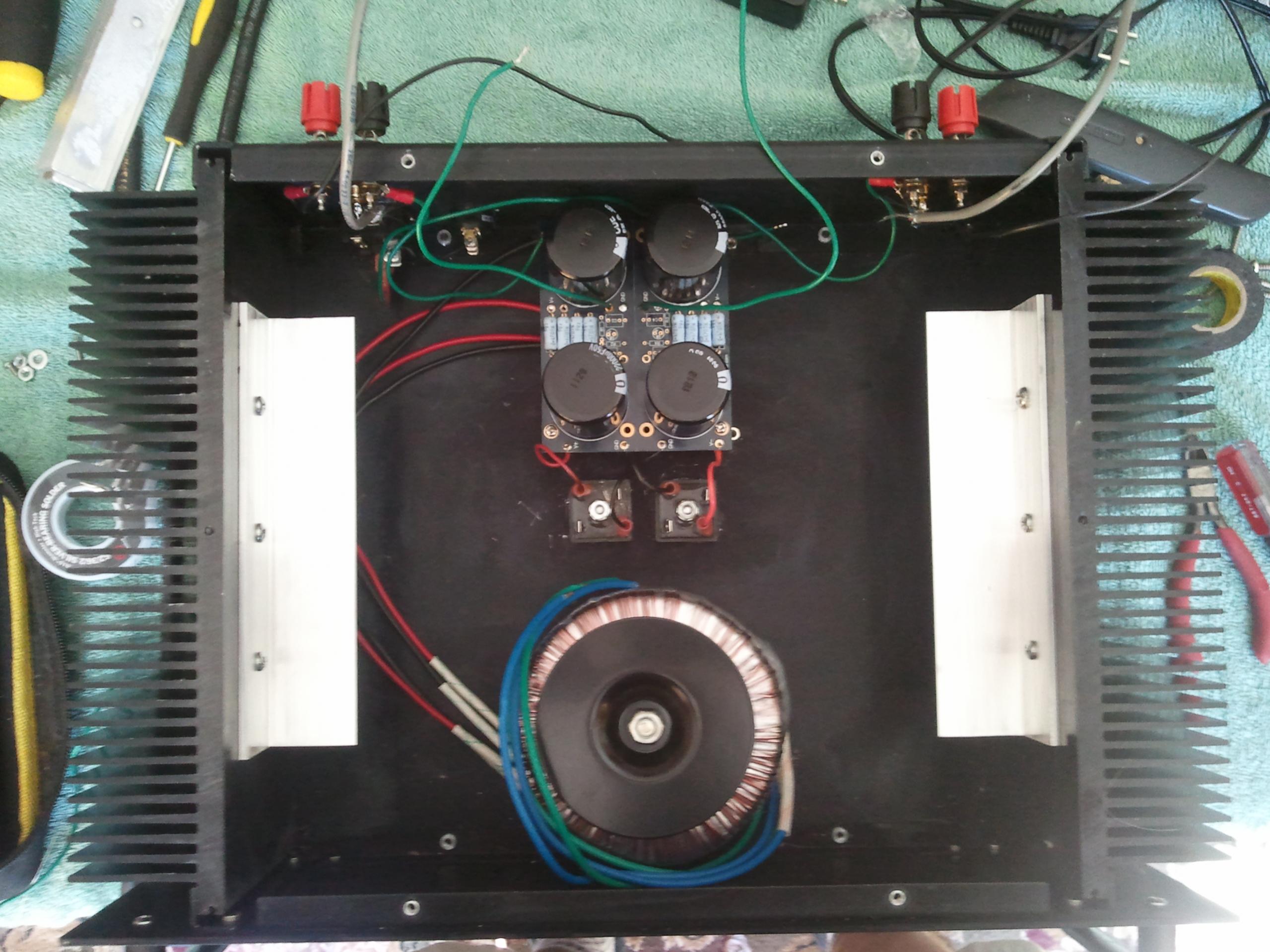

OK,
Got the 1.5" L profiles cut and ready to go...just need to drill and tap the holes for the transistors.
Can you confirm the width of the board? I saw 100mm for the TO-3 version, is this board the same size width?
It will be tight but I think everything will fit.

Thank you, Tom.
Carl: warm up solder iron!
If you have any questions concerning your build, for example: how to adjust, use of the onboard CAP-multiplier, differences in using the SYMASYM
with or without pre-amplifier, ...: do not hesitate and post your questions here!
