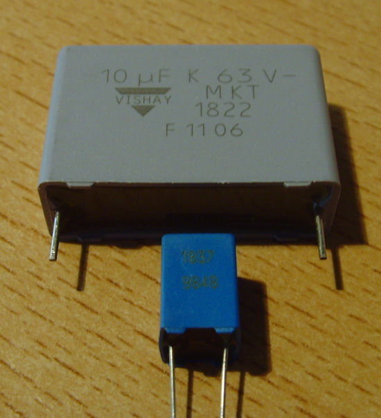

@Manuel and Joshvi: I will order the pairs of MKT1822 / MKP1837.
Please: do your PAYAL - transfer to: RRozek@t-online.de
So we are at 8 pairs (4 pairs for Manuel, 4 pairs of Joshvi) of capacitors currently.
One pair costs 5€.

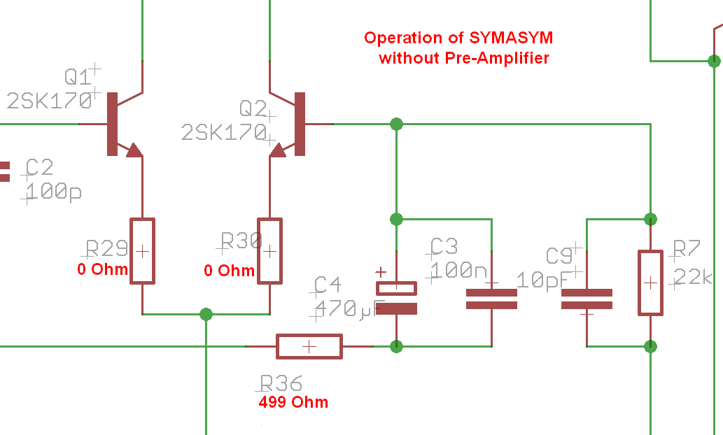

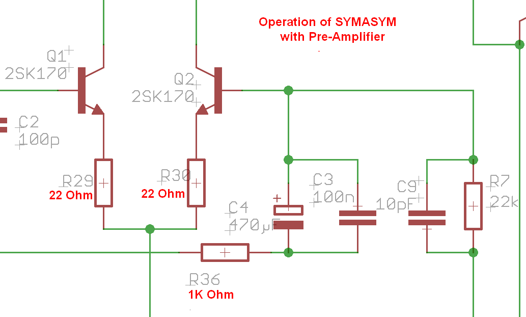

Gentlemen,
the value of resistors R29, R30 and R36 depend on whether you use a Pre-Amplifier or not.
(Carl: maybe it is nice to include a dual potentiometer as attenuator in the BoM - it is of course optional.)
Resistors R36 and R7 define the "total amplification" of the SYMASYM.
If you use a pre-amplifier, it is wise to reduce this amplification.
Please have a look at the attached images and take your choice.
Best regards - Rudi

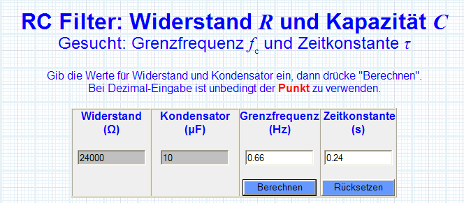

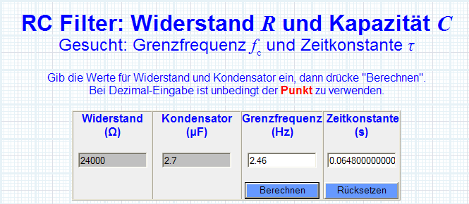

Carl, which value did you order for the input DC-blocking capacitor C1?
The schematics in the "Builder'S Manual" that I sent you, shows C1 with a value of 10µF.
As I have been told, the highpass consisting of C1 and R3 + R4, results in a 240ms time constant. That gives a F-3dB = 0.66Hz.
I have never tested, if the SYMASYM can handle frequencies as low as these.
A 3.3µF, even a 2.7µF DC-blocking capacitor will do it as well.
The PCB accomodates for capacitor grid-sizes from 5 - 27.5mm.
Best regards - Rudi
