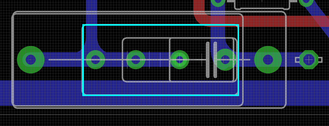

The MKS4's I ordered have a lead spacing of 15mm - it is hard to tell but looks like the board will accommodate this spacing - correct?
Yes, it does, Carl.
The position is marked in "neon-green".
Best regards - Rudi

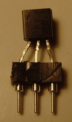

If you want to "play around" with different types of transistors of the input differential pair (2SK170, MPSA18, BC550C, 2N5551, ...),
I recommend you to use a rig like the one attached to this post.
Best regards - Rudi

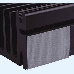

Carl,
I am using this silicone film insulating foil for a long time.
Desing: single-side adhesive.
It has excellent heat transfer characteristics as well and your fingers and components won't get dirty! 😀
Best regards - Rudi_Ratlos
