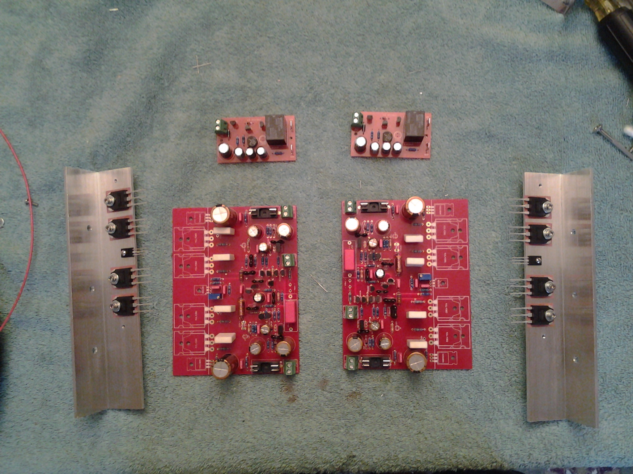

progress....boards are stuffed and L profiles are tapped. need to get some small screws to mount the mje's.

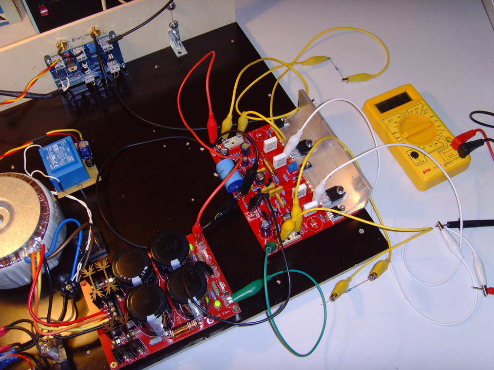

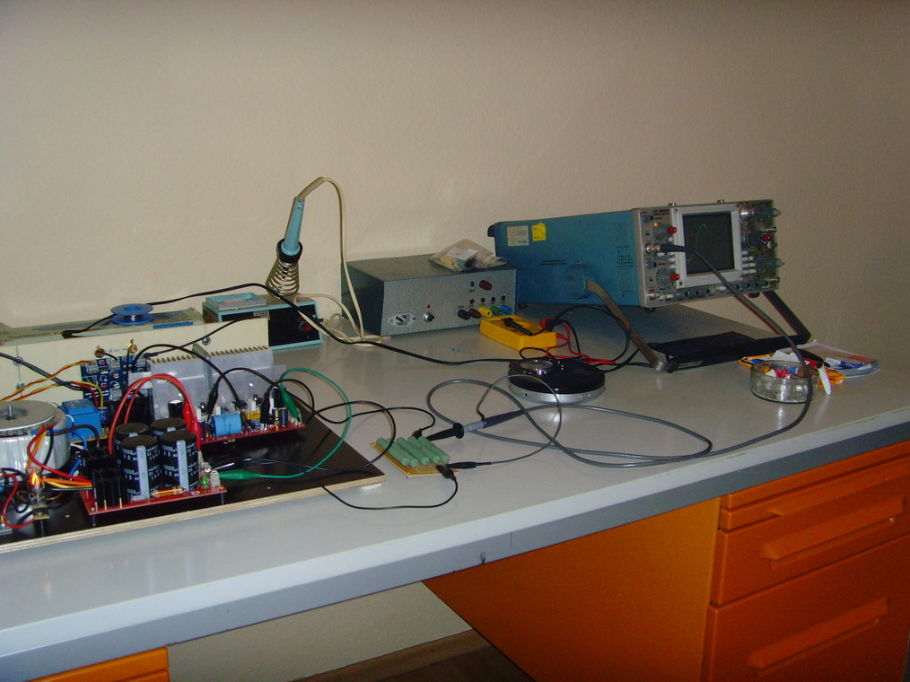

Carl, I received the ordered thermally conductive foil this morning and finished the 1st channel of my SYMASYM.
I adjusted the quiescent current / bias to 26mV voltage drop across 2 emitter resistors (between MP1 and MP2).
The DC offset is very, very small (< 1mV).
I tested the channel using a 8 Ohm / 80W resistor and played back some sine and square-wave tracks at 16 VAC amplitude. No problem.
If I have some time tomorrow (but I believe that I will receive the FC-100 group-buy PCBs in the morning), I will try and finish the 2nd channel.
What about your build?
