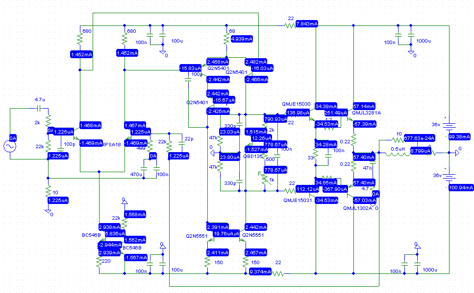

Find attached a picture with the currents flowing, when you do the adjustment of the SYMASYM. But I wonder, if the image will help you.
Please tell me, what you did wrong.
I know from your post that you forget to isolate the back of the BD139 TEMPCO transistor. But his cannot be the only error.
Did you also forget to put "shoulder washers" beneath the screws of the drivers (MJE15030/MJE15031)?

that marked up diagram shows two very useful bits of info.
1.) 1.225uA flowing into the bases of both input transistors. That combined with the 22k resistors gives identical voltage drops across these resistors. If the other ends of these resistors are at Zero Volts, then the bases of the input transistors MUST be at the same voltage.
2.) The currents in the input collectors and in the input emitters and in the input bases are all identical to their partners. This is the ideal you want when setting up your amplifier. If you have selected your 680r and your two input transistors well, then the Zero Volts from 1.) must ensure you have virtually 0.0mVdc of output offset.
A small error in Vbe between the two input transistors will result in a small error in output offset, if you have ensured that all the currents are equal as shown in the schematic.

Please, voltages on the schematic as done for currents in post565.

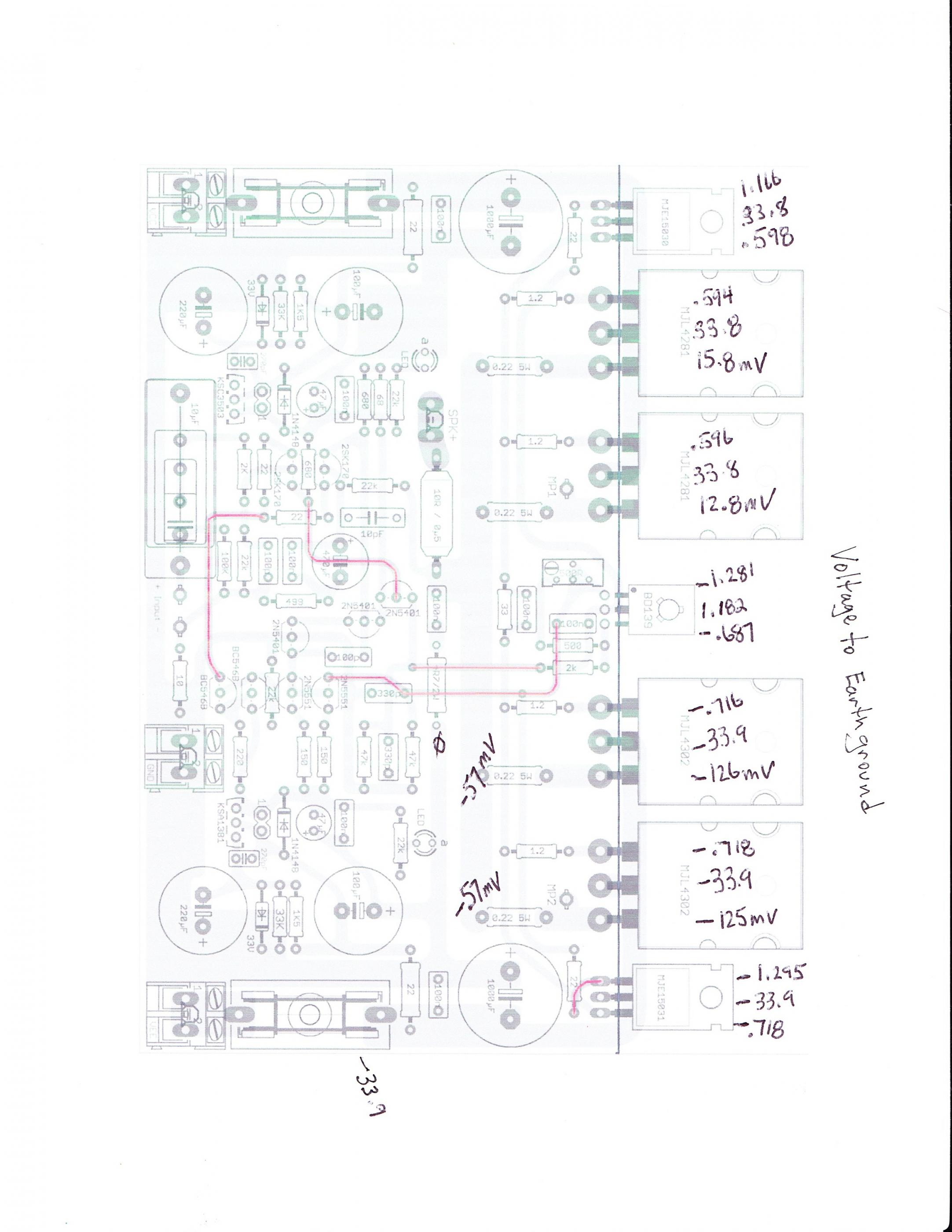

Carl, do NOT connect a speaker and put a short on the input!
Do not pay attention to the Speaker-Protection-PCB! Do not connect it!

OK...with the amp terminal not connected on both channels the speaker protect works on both channels. For both channels, as soon as the amp terminal is connected the LED's shut off and the relays click closed.
The good channel has ~1mV
The bad channel has -57mV
One thing...I do measure about 16VAC on the amp terminal of the speaker protect boards
I am beginning to think this amp HATES me.
Dear Carl,
I think your board does not have any big issues. Each emitter resistor have 70mv accross it.That means current through them(and ofcourse through output transistors also) are approx 320 ma and are equal.So the biasing of the transistors are okay.This current is little higher than the required quiescent current.You can reduce it using the preset.But the output have some offset towards negetive side.This may due to feeback circuit or mismatch of input diffrential stage.which transistor you are using BJT or JFET ? To identify this , you swap the transistors Q1 and Q2.If the offset goes towars other side,ie towards +50mV,you replace these devices with matched one.Otherwise you please check the following components and their wiring. R2,R3,R6,R7,R11,C3,C4 etc.Could you post the collector,emitter,base voltages of Q1 and Q2

AC or DC?..............The good channel has ~1mV
Oscillation? Was this always present and you just forgot to tell us?One thing...I do measure about 16VAC on the amp terminal of the speaker protect boards
The -57mV is DC and the 16V on the amp terminal of the speaker board is AC. How the heck is that much AC appearing at the amp terminal?
It is on both boards BTW when the relay is engaged.
And yes the caps are installed with the correct polarity.
I switched the 2sk170's around and the problem did not change.
I checked all the resistors and they are good.

Can you post drain,source,gate voltages of both 2sk170's with reference to ground (0v)
