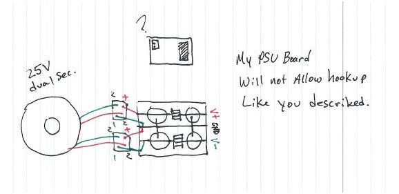

No, I get the 16VDC when the Symasym is not connected..on BOTH protect boards...
I think it is coming from the "ground" of the protect board maybe? To each board I have connected one of the secondaries of the power transformer. That is the only way I can get at least 24V to the regulator. I think...Since I have one of the AC legs connected to the ground of the speaker protect board could that be where the 16VAC is coming from? From the schematic it looks like a plausible explanation.

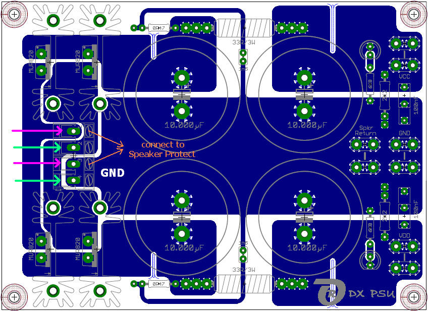

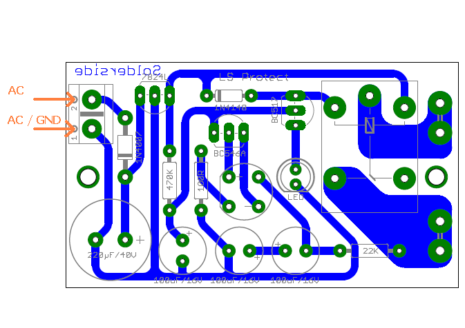

Carl, you use a transformer with 2 secondary windings, pink and turquoise, rated a 25VAC each.
One line of each secondary winding connects to "GND".
Connect the 2 orange coloured wires to the Speaker Protect PCB.
(In effect you are connecting a secondary winding to the Speaker Protect PCB).
Connect the orange AC-line to the top pole of the 2-pole power connector of the Speaker Protect PCB and the AC / GND - line to the bottom pole of the connector.
You should never have any AC voltage on the AMP-connector of the Speaker Protect PCB, if the PCB is not connected to the AMP.
Best regards - Rudi
Best regards - Rudi

So I think I know what the problem is...my PSU board is different from the one Rudi laid out.
I do not see a connection scheme that will work here...at least not an obvious one. I am pretty sure that using both legs of one secondary in the speaker protect pins and then grounding the "ground" one would be bad right?

Carl: unbelievable!
The speaker protection scheme in your case: connect +Vcc (about 35VDC) of your PSU to the "AC-pole" of the 2-pin Speaker-Protection-PCB-connector and your PSU-GND to the "AC/GND - pole" of the Speaker-Protection-PCB - connector.
This way: you will have a Power-On delay, you will of course have DC-protection, but you will not have immediate shutdown of the speakers, when you turn power off (because of the reservoir cap's discharging).
Maybe this will introduce some "Hiiiiiiiisssss, SSssssssccccchhhht", when you switch off the mains, but this will definitely not hurt your speakers.
Best regards - Rudi_Ratlos
Wow!
Tonight I rewired the speaker protects per Rudi's post above and worked like a charm. The relays engage after about 5 seconds and then disengage after 3-4 seconds upon power off.
I just need to get some more fuses and I can put the top on.
