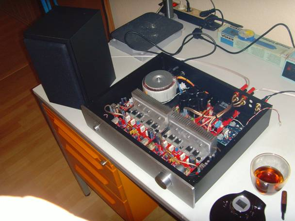

Many thanks, the chassis is standard 19 inch rack mounted, I did a modification to make it look nice, well making chassis is really tedious but i'm glad all module fit perfectly.
I think i did a great job on the modules placement, the amp is quiet no hum, no noise and it sounded great too.

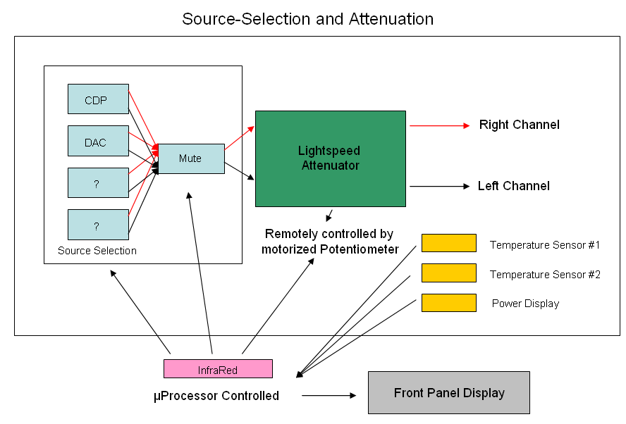

My own build (see attached image) cannot compete with Junie's build from a craftsmanship point-of-view - allthough:
I have given my SYMASYM a very outstanding attenuator: a motorized, remotely-controlled potentiometer adjusting
George Stantscheff's Lightspeed Attenuator.

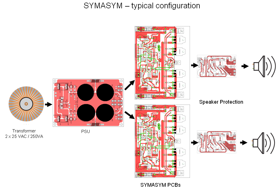

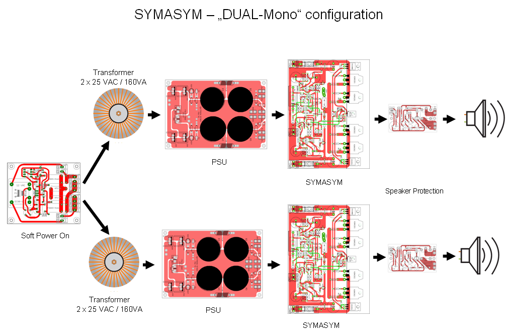

Gentlemen, find attached two images showing how to wire up a SYMASYM amplifier.
The 1st picture shows a typical stereo-configuration (same as I have built).
The 2nd picture shows a what I call "Dual-Mono" configuration (same as Junie did).
The Soft-Start PCB is only needed, if you go for the "Dual-Mono" configuration and the combined power
of the 2 transformers is rated at approx. 500VA.
Please keep these pictures in your mind, when you order PCBs.
