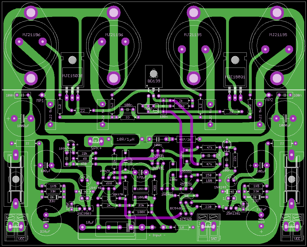

If somebody wants to etch the TO3-SYMASYM - PCB by himself: feel free and use the attached layout.
Four tracks have to be wired manually.
The size of the PCB is 140 x 112mm.

I have once more re-worked the layout and made it as compact as possible. The size of the PCB is now 140 x 112 mm.
You need an ALU-L - profile 50x50x5 mm, length: 140mm to mount the TO3s on them.

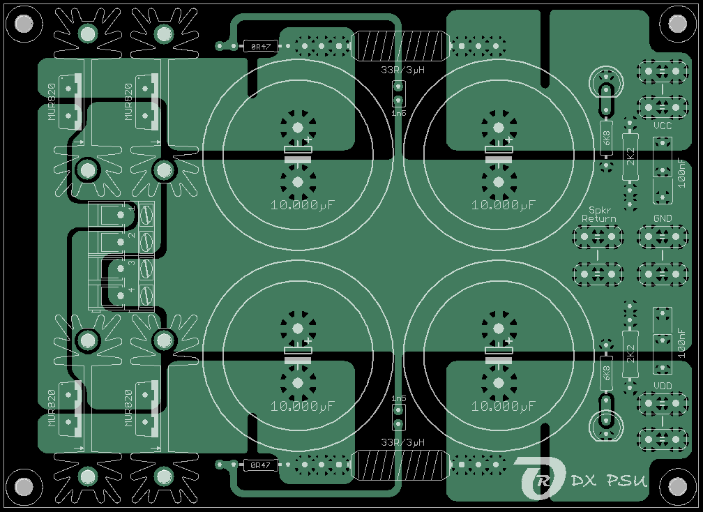

I will also offer PSU-PCBs in this group-buy.

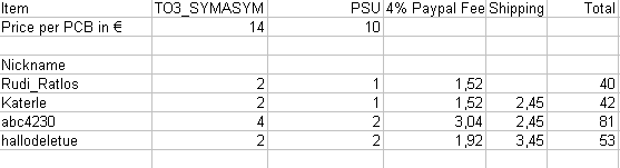

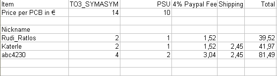

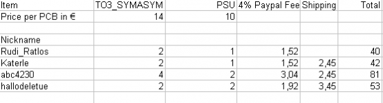

Your orders are welcome. Find attached the EXCEL with the current order-list.
Worldwide shipping costs 3.45€.
You can use PAYPAL to transfer the total sum to: RRozek@t-online.de
Best regards - Rudi_Ratlos

I am unhappy to see that the Gerber-files' preview (shown above) does not reflect the current state of the layout.
Find attached the current preview.
I apologize - Rudi_Ratlos
